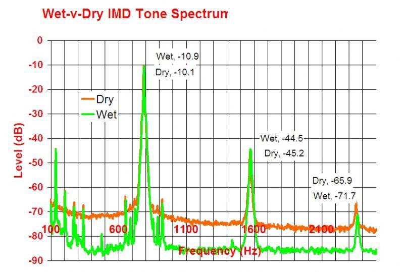

Here's a couple of measurements that show some of the advantages of reducing stylus-groove friction. In this case wet-versus dry, noise floor measured on a test record with IMD tones.
You can see significant improvement in the general noise floor, 10-15dB, even on a clean good condition test record.

Yes. I'm not advocating wet playback, but it demonstrates the significant improvement to noise floor of reducing stylus groove friction via any means.
Those measurements were made using a test record in good clean condition. So yes, noise floor was already very good, yet nevertheless was improved significantly. 10dB or more improvement in noise floor is well worth having, it's available, and can make a great difference to perception of detail and clarity of playback even for records where noise is not an issue.
For records which do show high levels of surface noise due to high groove friction, ie crackle pop noise despite being in good clean condition, the improvement can be profound - perhaps 20-30dB or more - and that is a game changer in recovering otherwise written off records.
In a real system, without using lubricants, reducing stylus-groove friction is mostly about choice of stylus/cartridge and choice of alignment. Strictly, what matters is friction force as a fraction of VTF, so VTF doesn't really factor, nor does cartridge suspension much. Whereas azimuth, SRA/VTA and tangential alignment can make a big difference, depending on stylus profile. Stylus quality, accuracy of manufacture, and polish can be a factor too.

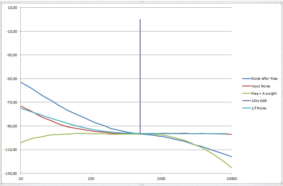

Hi LD,
A very interesting measurement.
Looking at the flatness of the noise spectrum, it must have been recorded without RIAA correction.
I recorded the spectrum of a 1 Khz 0dB signal from a test record.
Then I applied an anti Riaa curve to get a flat recording, which should be comparable to your recording, this is the line in red in my figure.
I also calculated a third curve, being A-weighted + Riaa correction.
With this curve I could calculate that the A-weighted S/N related to the 0 dB 1Khz was 63 dB.
This figure is very close to the 66 dB theoretical maximum achievable with a state of the art LP master cutter.
So to conclude, the noise in my recording is even below your wet recording, so I'm a bit puzzled how to interpret your results.
Hans
Thank you, Hans. My measurements were made a few years ago, but yes, I am sure to have taken care of RIAA correction when preparing the plots.
You can see from my dry plot that the noise floor roughly has a 1/f or -6dB per octave slope, which is characteristic of flicker noise from a friction source, BTW. And you can see that slope is absent in the wet plot, when friction is very low.
As to the absolute noise floor for the wet playback case, for my plots I suspect it may have been limited by pre-amp noise floor, and this might be better in your case.
In your plot, it seems odd that all the expected harmonic distortion peaks are absent ? Otherwise, at first sight, I would interpret it as you have a low friction test record/setup, on a low noise cartridge/preamp.
As to the cutter's role in groove friction, I suppose it must be a factor in determining vinyl wall surface smoothness, along with many other manufacturing process factors, not least vinyl composition itself? I guess a cutter S/N spec would be based on what is achievable with it, given good manufacturing processes ?

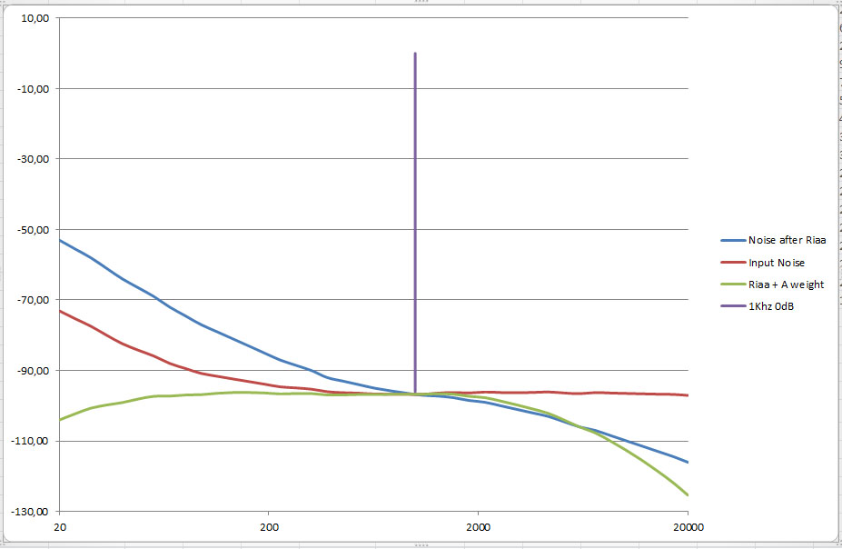

I have only transferred the 1kHz 0db value plus the noise spectrum from a blank trace on my test record to an excel sheet for further calculations.
I have left all the harmonics, in total close to -40 dB, because I just wanted to calculate the maximum dynamic A-weighted range.
I can show the original spectra, but they give no extra information regarding surface noise.
I also made a recording of the noise spectrum with running platter but the arm in the air. At all frequencies noise was more than 12 dB below the surface noise, so preamp noise did not interfere with the surface noise.
To support your statement about 1/f noise with 6dB/oct, I have now also included the spectrum of 1/f noise with a corner frequency at 250 Hz in light blue. The calculated max dynamic range without this 1/f noise, only improves by 0.4 dB. Not a very big deal or something to worry about.
I suppose the theoretical 66dB max dynamic range that Neumann specifies is based on using the best possible vinyl quality.
Hans

Hi LD,
I did observe 1/f noise, look at the red curve of the input noise as compared to a simulated 1/f noise with 6 dB/oct and a corner frequency of 250 Hz in light blue.
The two curves are almost identical !
I recorded my spectra with "buckets" of 1.5 Hz, and indeed a larger filter width will increase the noise level. When your filter width is a guessed 10 Hz, noise level will be 8 dB higher, but that is not the point.
What I was trying to understand is that a dry record in my case showed a dynamic range of 63 dBA, very close to the theoretical max of 66 dBA.
Your recording suggests that a wet record can lower the noise figure by 10-15 dB, however that would mean going way beyond the theoretical maximum.
And if wet recording only removes the 1/f noise, gain will only be 0.4 dB which is below the hearing limit.
Hans

Hi Hans, the floor of 1/f noise should have a -6dB/octave gradient if it is there and dominant, but neither your measured nor calculated curves show this. I don't understand where the idea of a 250Hz corner comes from, but you can see in my measured dry plot there is no corner: the line pretty much follows -6dB/octave.
I can't verify that calculation, but yes I believe it is plausible that achievable S/N spec of cutters assumes normal (dry) playback, and so, under abnormal (low friction) conditions, it might be possible to outperform spec limit?
That's how it seems at face value, I think.
