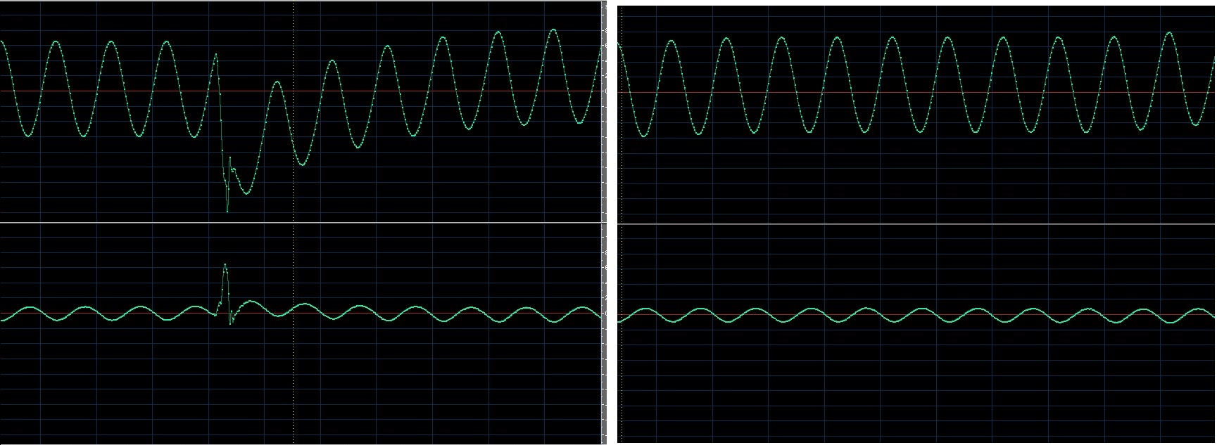

Yes, it's so easy and tempting to write off test discs with this stuff. This one is easy and cheap though. Will check out those plug ins, though I find it hard to imagine how they can distinguish noise from content, especially in the context of comments that noise is content specific?
This is a worn 35yr old copy of the RCA STR100 1kHz in left (not great crosstalk probably needed adjustment) before and after Clickfix on a particularly bad pop. I still think this is sort of cool for a freebe.
That is interesting, will check it out. If the artefacts from any miscorrection are better than those of the original noise source, that looks great. Can't fix FM issues arising from arm stability, as above, though !
