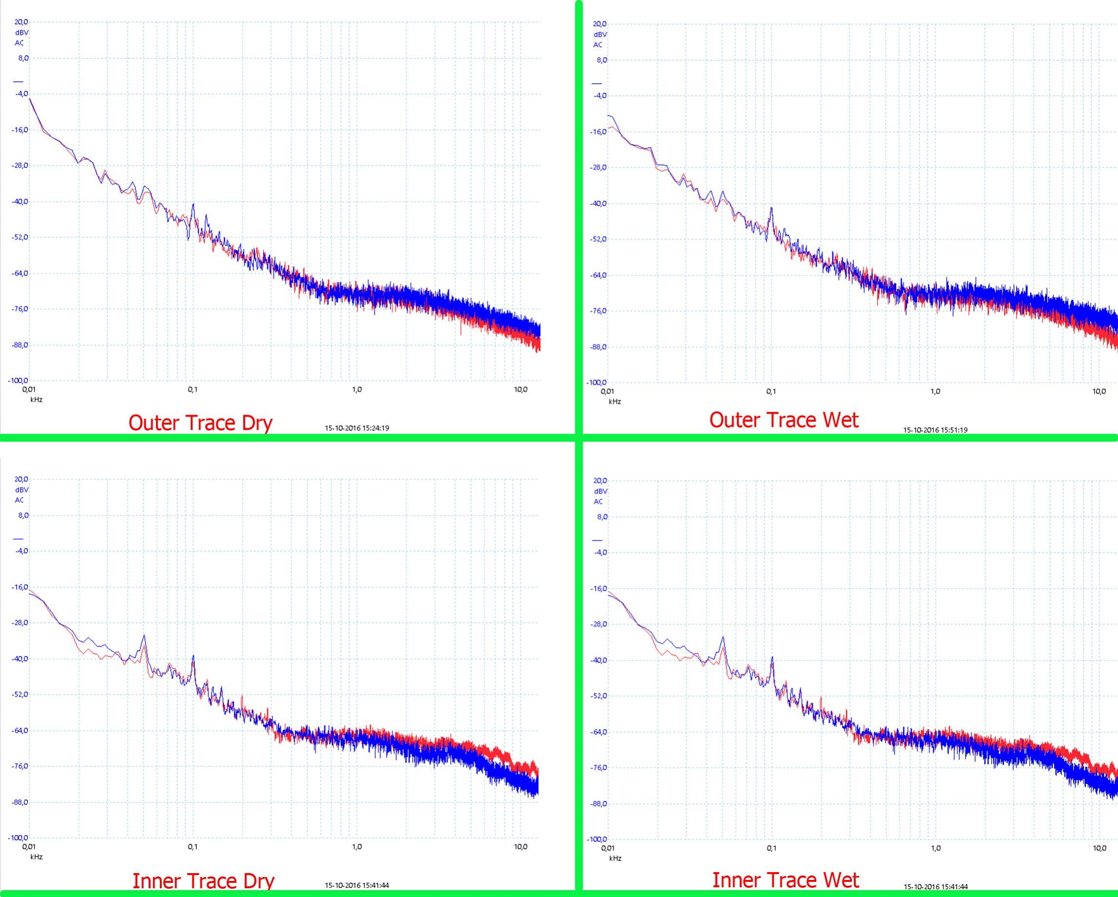

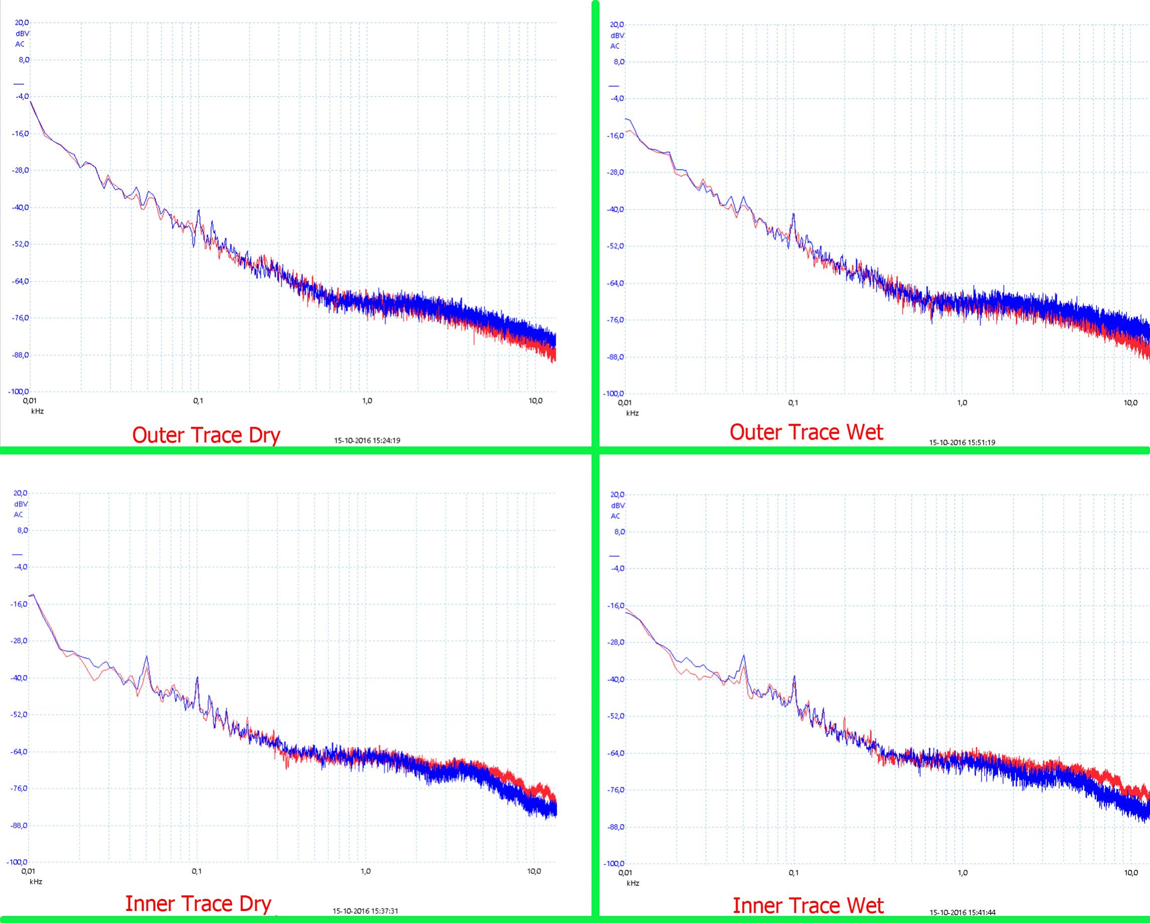

As Promised, I have made dry and wet recordings.
there are two sets, a silent track at the outer side of the LP with radius 13cm and one at the inner side where radius is 7.5cm, giving a difference in tracking speed of almost a factor 2. Both where played wet and dry.
I made several recording to be sure that the results were stable and repeatable.
As you can see, there is no visible difference between playing wet and dry.
There is however a clear difference in noise between the inner track and the outer track.
The inner track has less LF noise but more HF noise.
I already noticed that the "dry noise" in my case is similar in level to LD's "wet noise", so obviously there is no further room for improvement in my case.
However LD's recording of playing dry are much worse.
So the theoretical max dynamic range of 66dBA was not broken , in both cases dry and wet it was 63dBA with my set.
As a last check, I dried the LP an recorded again, resulting however in no visible change against the previous results.
It proves how different various players are behaving and how carefull one must be before jumping to conclusions.
Hans
Hans
Hi Hans, thanks that's interesting and I half anticiptated you might obtain such results, which don't tally with mine nor from independent 3rd party recorded sample files.
I think this most likely is because either
a) there is already low friction in your setup and the record, therefore there is no phenomenum to eliminate or observe. I note that you did not measure friction coefficient wet-v-dry, so strictly we not know anything about friction before/after wet play.
Since results were repeated, presumably using the same test disc, the record must have been played dry after being played wet. This is near certain to have raised both friction coefficient and surface noise IME. This is well known and readily verifiable on any record one doesn't mind ruining for dry play. However, your results apparently did not reveal any such change in surface noise on subsequent dry playback, which I think is very hard to reconcile with common experience and my own measurements.
Lack of observation of deterioration of dry play after wet play, I think is evidence something is wrong with the test method, Hans, rather than intrinsic low friction in the set up.
b) something is wrong with the measurement/analysis which masks ability to detect or resolve the effect we are looking for.
I think this most likely, though do not know why. I can repeat previous comments about choice of window and sample length, for example, masking resolution at lf, and suspect analysis may be at the crux.
Since you do not know the reference level for my measurements, Hans, it is impossible to comment on relative noise floor observations between our results, and your own reference level is unclear and perhaps not transferable between your own measurements.
Ultimately, what is needed is analysis capable of resolving both a calibrated tone and the noise floor at sufficient resolution and dynamic range to show differences and effects. I believe this is lacking, and that is why well known phenomena, such as dry playback noise floor deterioration, are not observed in your results. Whereas they are in mine, and that I think is the most likely difference.
LD
Why and how should I have measured a friction coefficient. The discussion was, does playing wet reduce the noise level, for whatever reason.Hi Hans, thanks that's interesting and I half anticiptated you might obtain such results, which don't tally with mine nor from independent 3rd party recorded sample files.
Look at the time stamps in my recordings and you will notice that both dry tests were taken before switching to wet. Your near certain assumption is therefore 100% wrong.Since results were repeated, presumably using the same test disc, the record must have been played dry after being played wet. This is near certain to have raised both friction coefficient and surface noise IME. This is well known and readily verifiable on any record one doesn't mind ruining for dry play. However, your results apparently did not reveal any such change in surface noise on subsequent dry playback, which I think is very hard to reconcile with common experience and my own measurements.
You posted a graph in #29, where the noise level is very well visible.b) something is wrong with the measurement/analysis which masks ability to detect or resolve the effect we are looking for.
Estimating roughly a 10Hz filter bandwidth, makes relative noise observations very well possible with my #33, where filter bandwidth was 1.5 Hz and where at the same time the level of a 0dB tone was displayed.
So my reference level is as clear as it could possibly be.

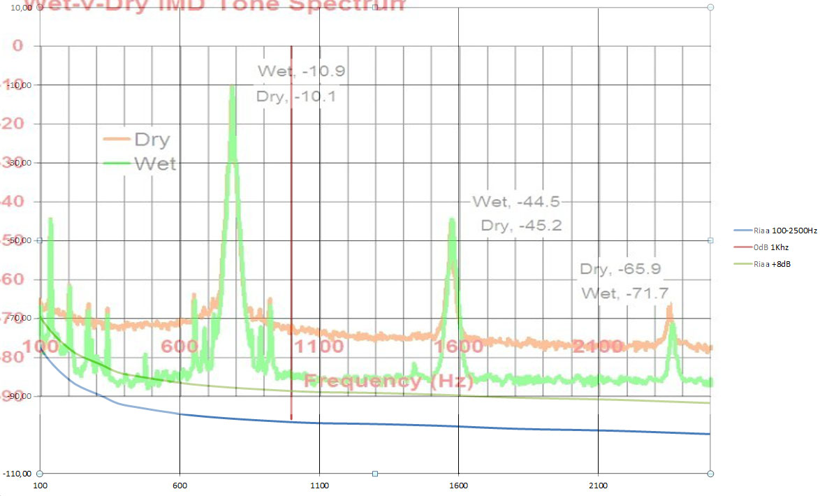

All you have to do is to compensate for 10log(10/1.5)= 8db. I am not that far of with this estimate as will be shown below.
I have again taken my figure from #33, now displayed from 100Hz to 2500Hz to bring it on the same linear scale as your figure.
At the same time I have drawn a line 8dB above my measured noise level to simulate your estimated 10hz filter bandwidth.
An top of this figure I have projected your figure from #29.
As you can see the shape of your wet noise follows exactly the same curve as my dry noise curve, but yours is still some 4dB above the 10Hz filter width assumption, so maybe your filter width was a bit more like 15Hz.
It is quite clear however that your wet noise is in the same order of magnitude as my dry noise and that the relative levels are easy to compare.
My test disc has a calibrated tone and my equipment has enough dynamic range as shown in #50, where the noise from the non playing record player is also shown, so I reject firmly your comment on that.Ultimately, what is needed is analysis capable of resolving both a calibrated tone and the noise floor at sufficient resolution and dynamic range to show differences and effects. I believe this is lacking, and that is why well known phenomena, such as dry playback noise floor deterioration, are not observed in your results. Whereas they are in mine, and that I think is the most likely difference.
Your comment on neglecting dry playback deterioration, whatever that may be, can be shifted aside as non valid.
To conclude, it seems that you are rigidly rejecting any result deviating from your result.
I offered to perform the test in a more scientific way and do both the same things, like using the same test LP, the same recording length, the same amount of averaged spectra etc, etc.
But you simply refused.
The whole discussion from my side was nothing else but to warn to be carefull in finding the absolute truth based upon just one observation, but that does not seem to meet with a wide response from your side.
That leaves all real possible reasons in the dark as to why your recordings differ so much from mine. Does it have to do with the shape of the needle (3 x 60 in my case) or the fact that my LP is firmly held by a heavy peripheral ring and a heavy clamp in the centre or what? We will probably never know.
Hans

Well no, Hans.
You are guessing badly about my analysis parameters, and reference levels in my plots. Those IMD test tones are not at '0dB', and in any event do we not learn that there is no definitive 0dB, so we need always to state a reference velocity?
In the case of my plot in post #29, the point that there is a clear broad noise floor spectrum difference between dry and wet playback, where wetting was the only variable. This is observable no matter what reasonable fft parameters one uses. It is about the size of an elephant in a small room !
What you are trying to do, Hans, is reconcile results which are fundamentally different, rather than try to explain why.
Your plots and analysis, unfortunately, lacks several characteristic signatures of vinyl playback and that makes it tough to grasp and recognise or even guess what might be at issue.

Hi Scott,
I don't think anybody is making anything up by purpose, but when you are biased in a certain direction, chances are that you observe things differently and see "proves" that are no proves at all.
Quite a number of scientific papers were discarded many years later because of this.
It is not at all my intention to prove anything, other than showing that "wet playing reduces noise" is not always the case.
Why, I don't know but it would be interesting to find the cause.
Is it because of friction reduction, then why not always, is because the vinyl compound differs from one LP to another or are they all made from plain PVC, no idea.
What is the influence of the shape of the needle, round, eliptical, shibata or whatever, I have no idea.
Or could it be a combination of many factors together, who knows?
And don't forget to mention that the groove speed at the outside of the LP is twice the speed of an inner groove, does this give twice as much friction or what.
So the least one should do is to measure on different spots.
In my case I measured more noise above 400Hz on the inner track, quite against the expectation that halve the speed results in lower noise.
Is my cartridge not aligned correctly or what possible cause can lead to this counterintuitive result?
But in the end the all important question is, does it affect the sound reproduction in a positive way and again, difficult to get a reliable answer.
The experience of your friend with 1000 Jazz Lp's is also described in my posting #83.
At first I thought I had to play forever wet, but "scraping" the LP several times while constantly cleaning the needle and thoroughly cleaning the LP on a cleaning machine afterwards seemed to have solved that problem in my case.
But again, that is just the experience of one guy, making no prove at all.
However I'm curious to hear if anybody reading this thread had similar experiences.
If that would be the case, than the fluid causing the harm could be doing this in an indirect way by helping to solidify mud in the groove but not by changing the characteristics of the PVC.
But again it could just as well be a combination of both or because of something that nobody has thought of so far.
So the attitude that is best in things like this, keep your mind open and take nothing for granted.
And I could not agree more with your phrase: It does not matter who is right, all that matters is to get it right.
Hans
One time I tried wet playback, using tap water and playback was less noisy when wet but very noisy afterwards. Next time I used distilled water mixed with limescale removal substance (stuff you use in a coffee machine) and after that I didn't get extra noise when playing the vinyl again when dried up.
I got two identical vinyls that I could use to do testing on. One for reference, other the guinea pig, but I lack means to record anything with reasonable quality for the time being. I also got mono test disc with variety of test tones (30, 50, 100, 315, 500, 1000, 3150, 5000, 10000Hz), it is in a rough shape though, couldn't find any info on the internet. изм-0281/0282
