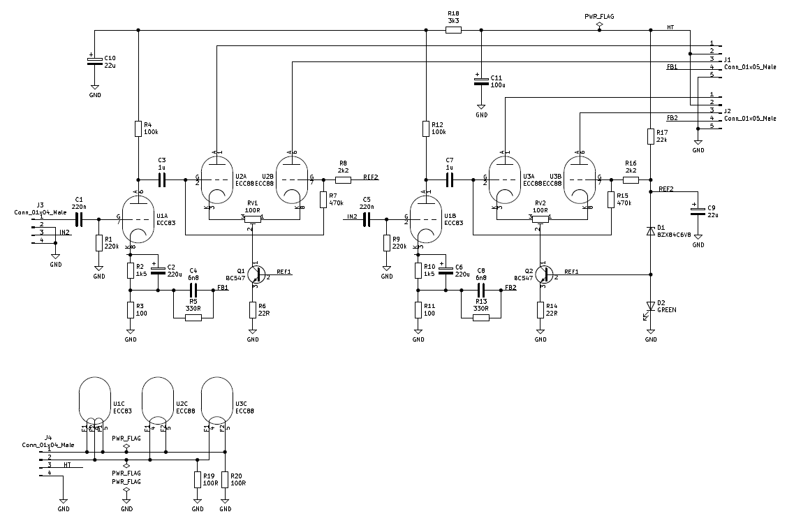

I thought I'd try KiCad first as its free and is well regarded. So this is a headphone amp for 32R headphones. HT = 100V and uses some cheap Multicomp 120-0-120, 0-12, 0-12 1VA6 mains toroid's as OPT's. No problems so far with the schematic - has parts for ECC83 and ECC88.
To save you the headache of downloading and opening a pdf, here's the attachment of post 44
Click on the image to see it full size and undistorted

I’ve been using Kicad for 3 or 4 years and have made a lot of boards ranging from small positive and negative Maida regulators to very large 4 way valve crossovers complete with filter cards on daughter boards with edge connectors.
The thing l like a about Kicad, apart from being free of course, is the amazing variety of video tutorials. Anything you want to know how to do, or any question you have, someone else has already asked it.
I started with v4 and made my own footprints for 7, 8 and 9 pin tube sockets, and lots of higher wattage resistors. V5 has a much larger library and millions of symbols, footprints and 3D models are available from places like Mouser and Digikey.

I'm working my way through my first non trivial layout (in kicad 5.99) and it's been a steep, fairly painful learning curve, but the layout and routing was great fun, a really neat puzzle game trying to make something that looks nice and was electrically sound.
