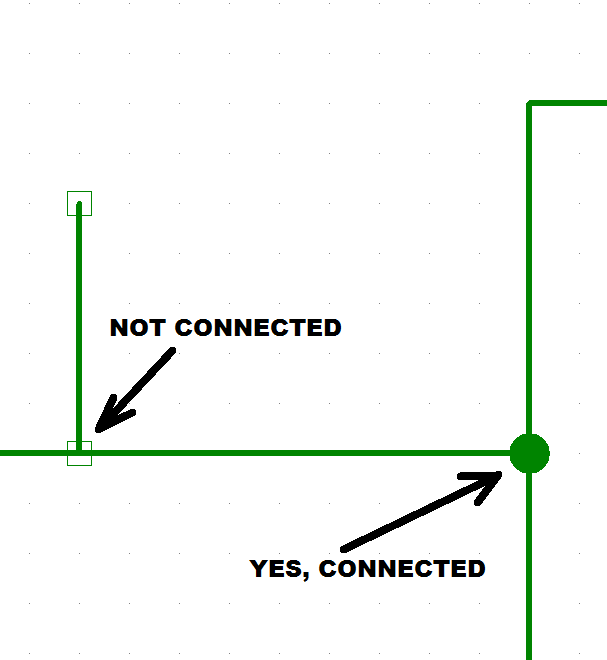

For what it's worth, I don't like Eagle because you can very easily draw schematics that look perfect but still result in a wrong netlist. It's a nice drawing tool, though.
You can draw wrong schematics (netlist doesn't match what you expect by reading the schematic) in KiCad too. Here's an example, zoomed in at super high magnification. When viewed at full sheet magnification you would never see it.
And IMHO it's a software design flaw to allow this to ever happen. Contrariwise, in the LTSPICE schematic editor, this cannot happen -- the solder dot is automatic and the connection is automatic.
{to reproduce: copy a piece of a schematic using shift-drag, and then place the copied components & wires so that a vertical wire from the copy, touches a horizontal wire from the original. Presto, they touch but they are NOT connected. Ugh.}
