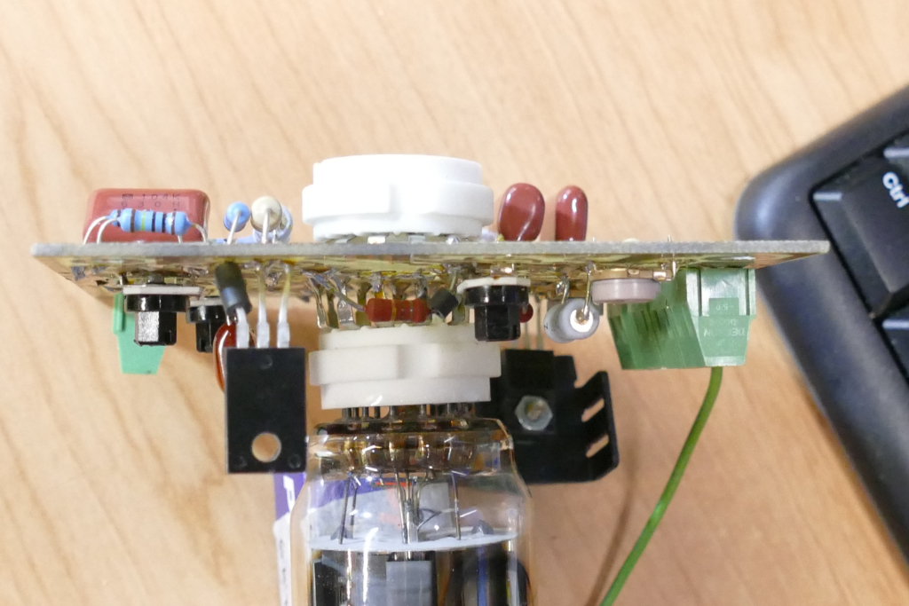

Always put some lettering on each layer of your board. This is especially important if you are making your own boards. It's too easy to get the layers swapped or a single layer board mirrored.
I still have this reminder visible when making boards. I got it stuffed with enough parts for a first test, but smoke happened when I powered it up. It took a while to realize that the layers were swapped causing the tube to be miss-connected and every semiconductor was in backwards. I lost lost my cool, threw it against the concrete wall, then tossed the remains in the trash. A day later after I thought about it, I got it back out of the trash, replaced all the fried mosfets and soldered a second tube socket on the other side of the board.
