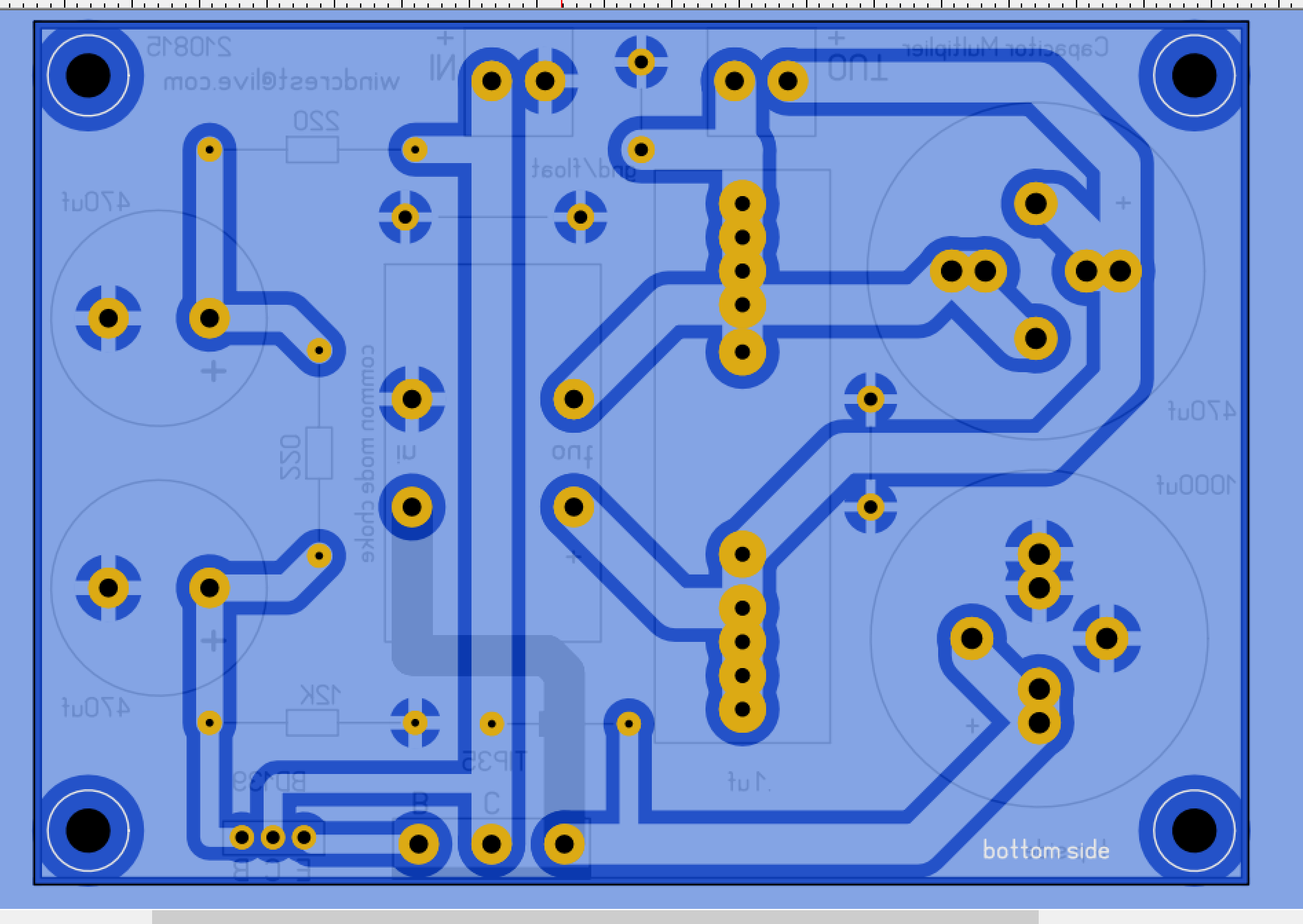

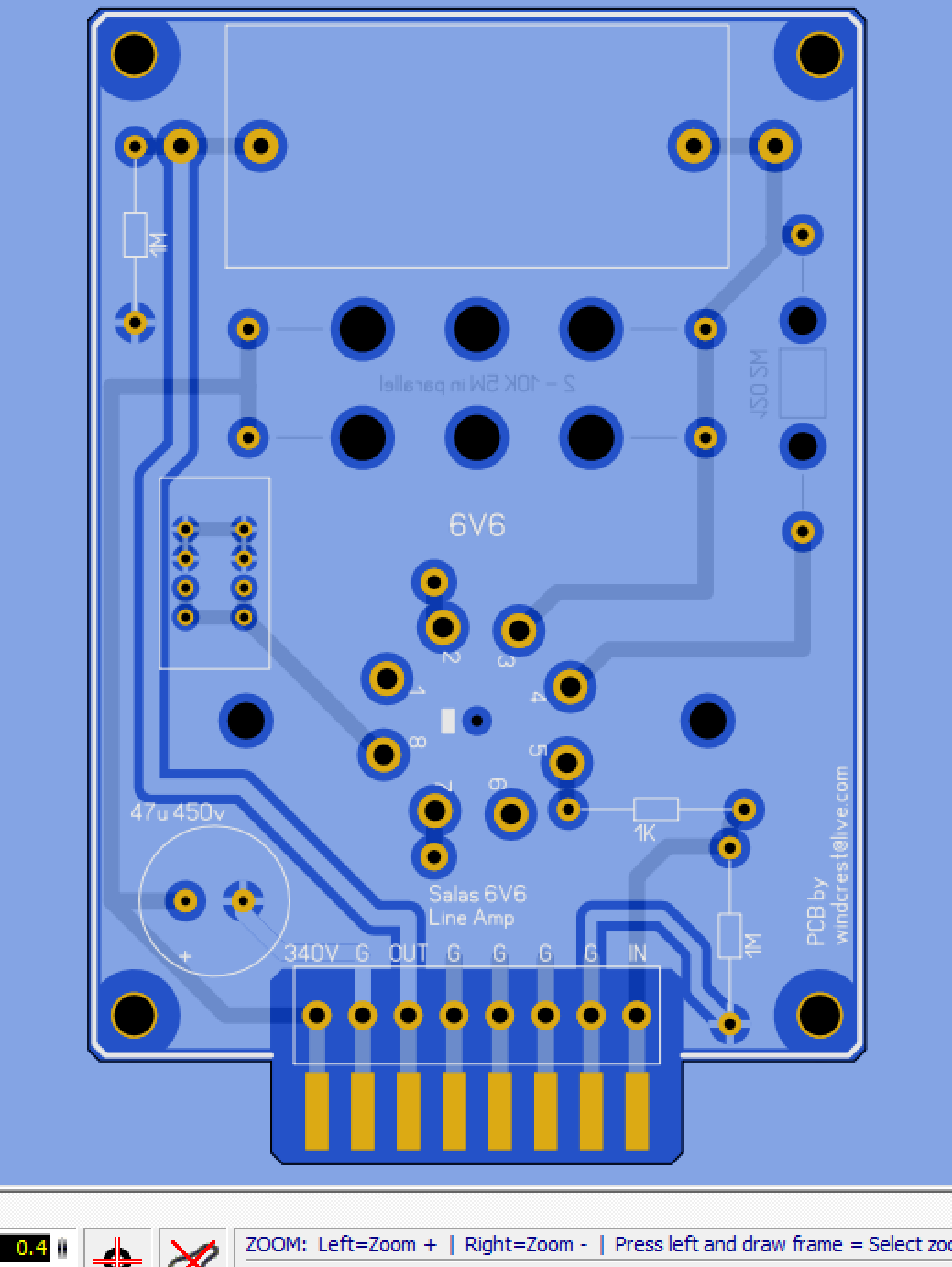

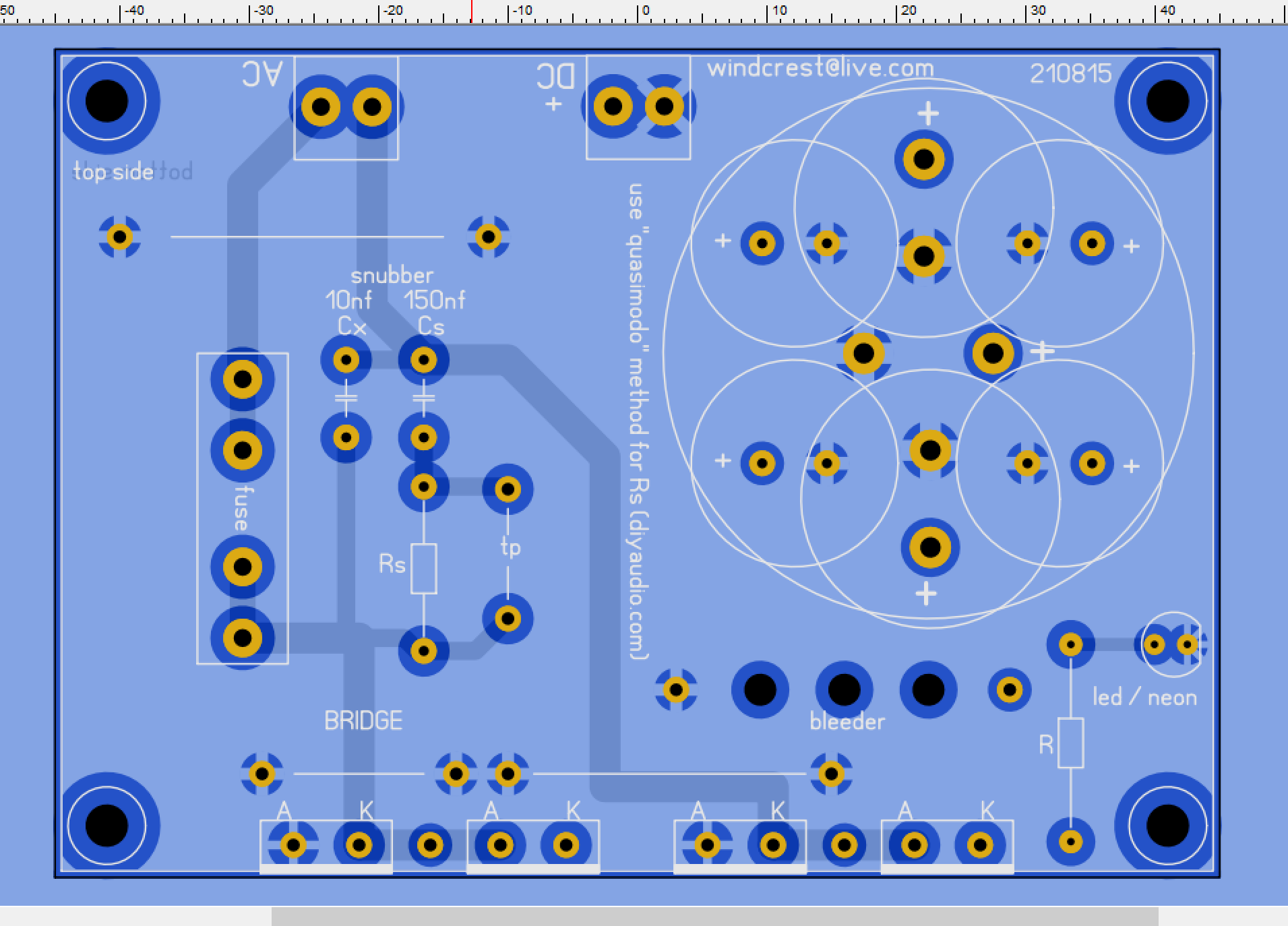

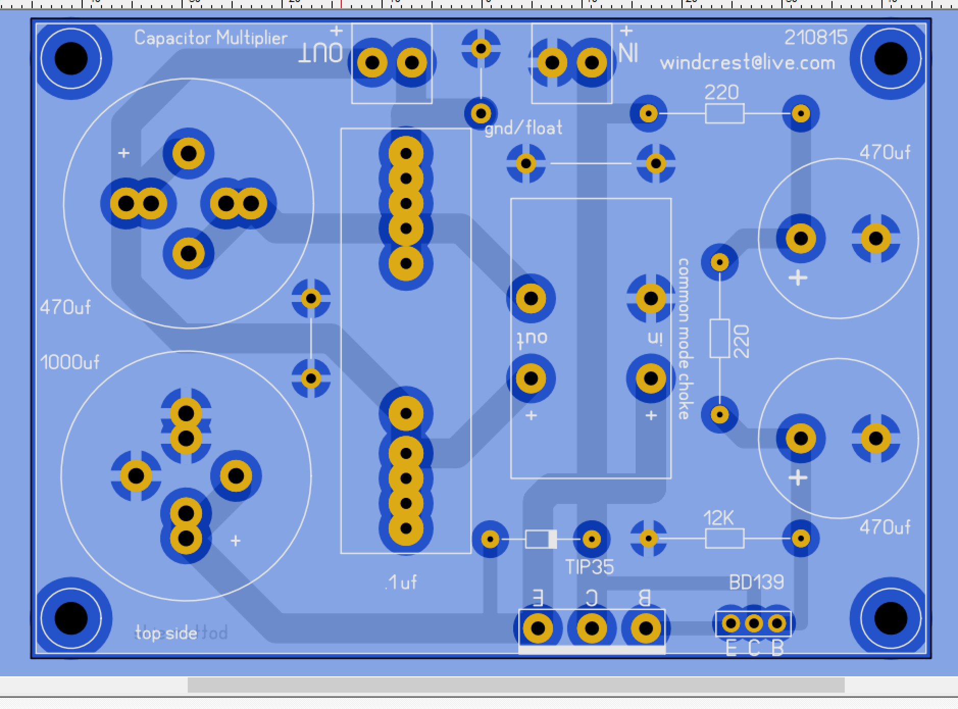

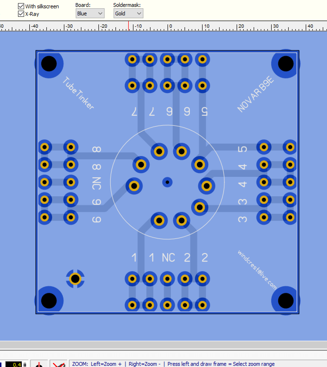

Sprint Layout 6.0, ELECTRONIC-SOFTWARE-SHOP
Elliott Sound Products Capacitor multiplier top and bottom
Salas 6V6 mono on tiny board, the cathode circuit goes on a plug edge card so I can experiment so no K circuit parts on the board just an edge card socket)
A Novar breadboarding jig (this one has a few mistakes but it works, the center hole is off). This uses 5.08 pitch spring clips for the hookup.
A general purpose bridge rectifier with Quasimodo snubber, fused secondary, bleeder, first reservoir, and lamp. Sometimes I do ground plane to ground plane jumpers when I see that I've split the ground plane with a long trace. This one uses 4 layers so I could have a full power plane and ground plane under the reservoir cap, big charging pulses. It can use a variety of capacitor sizes or counts.
