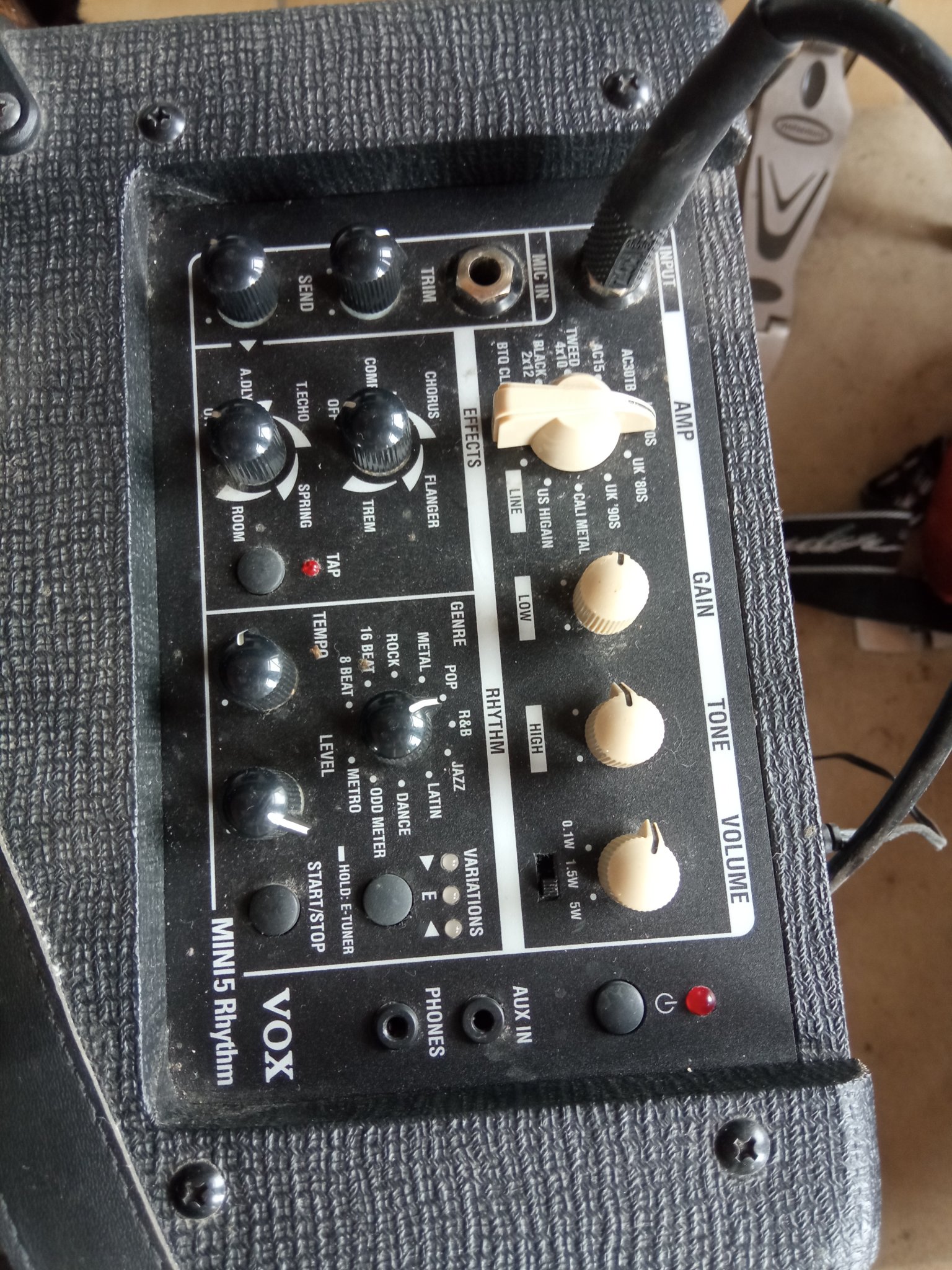

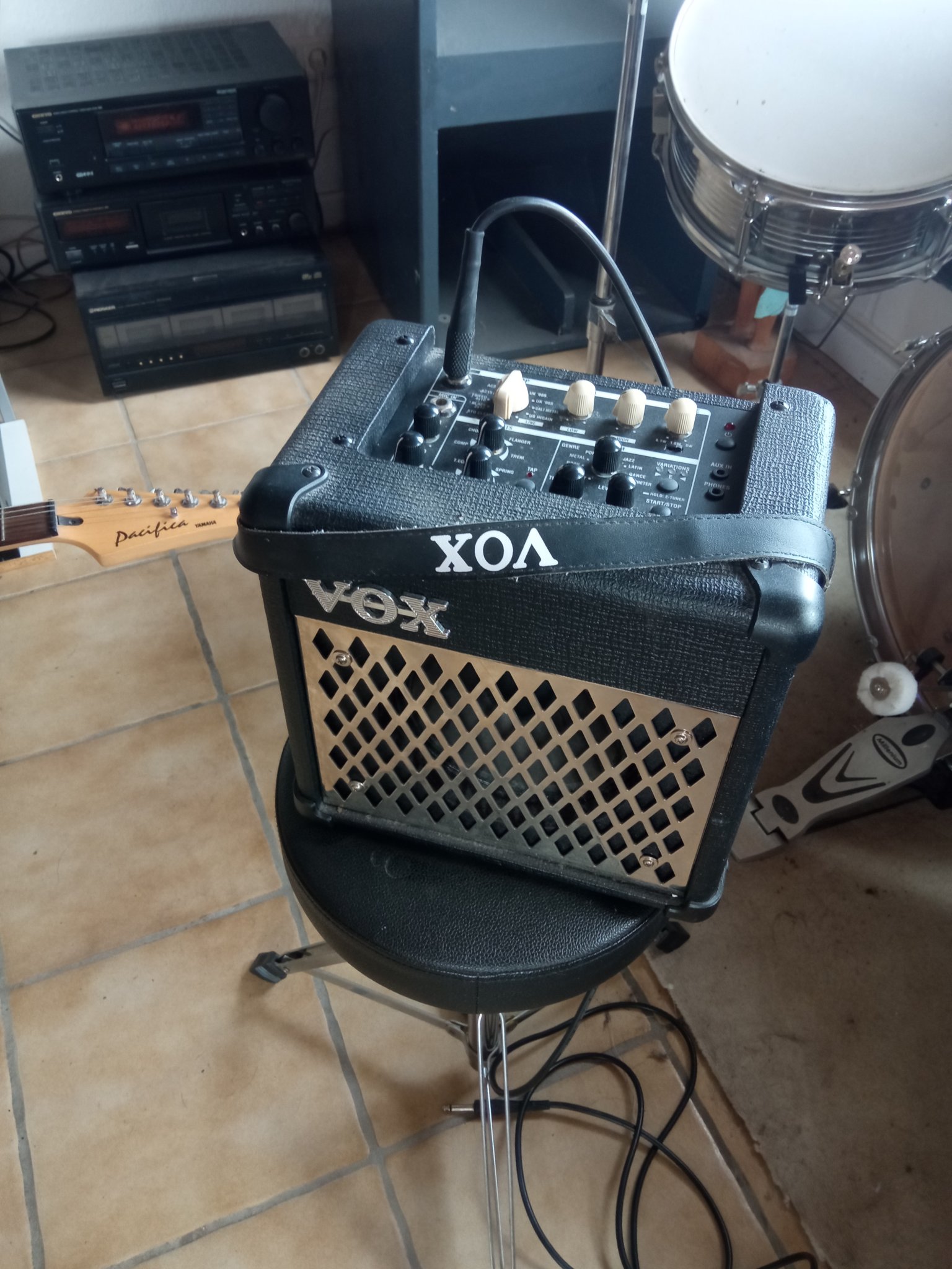

Heres is the guitar amp my daughter uses.
When she took it to her guitar teacher, he first loughed about it, then tried it, just for fun.
He ended up plugging it into his PA system and finally spent nearly 2 hours exploring all the things it could do.
https://voxamps.com/de/produkt/mini5-rhythm/

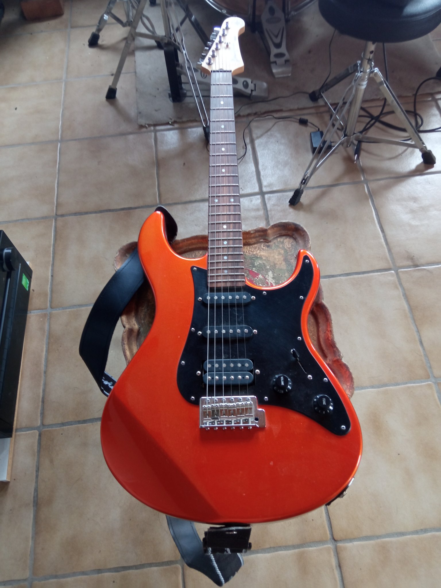

This is her guitar, in a girls color. Orange metalic Yamaha. A very capable entry level instrument.

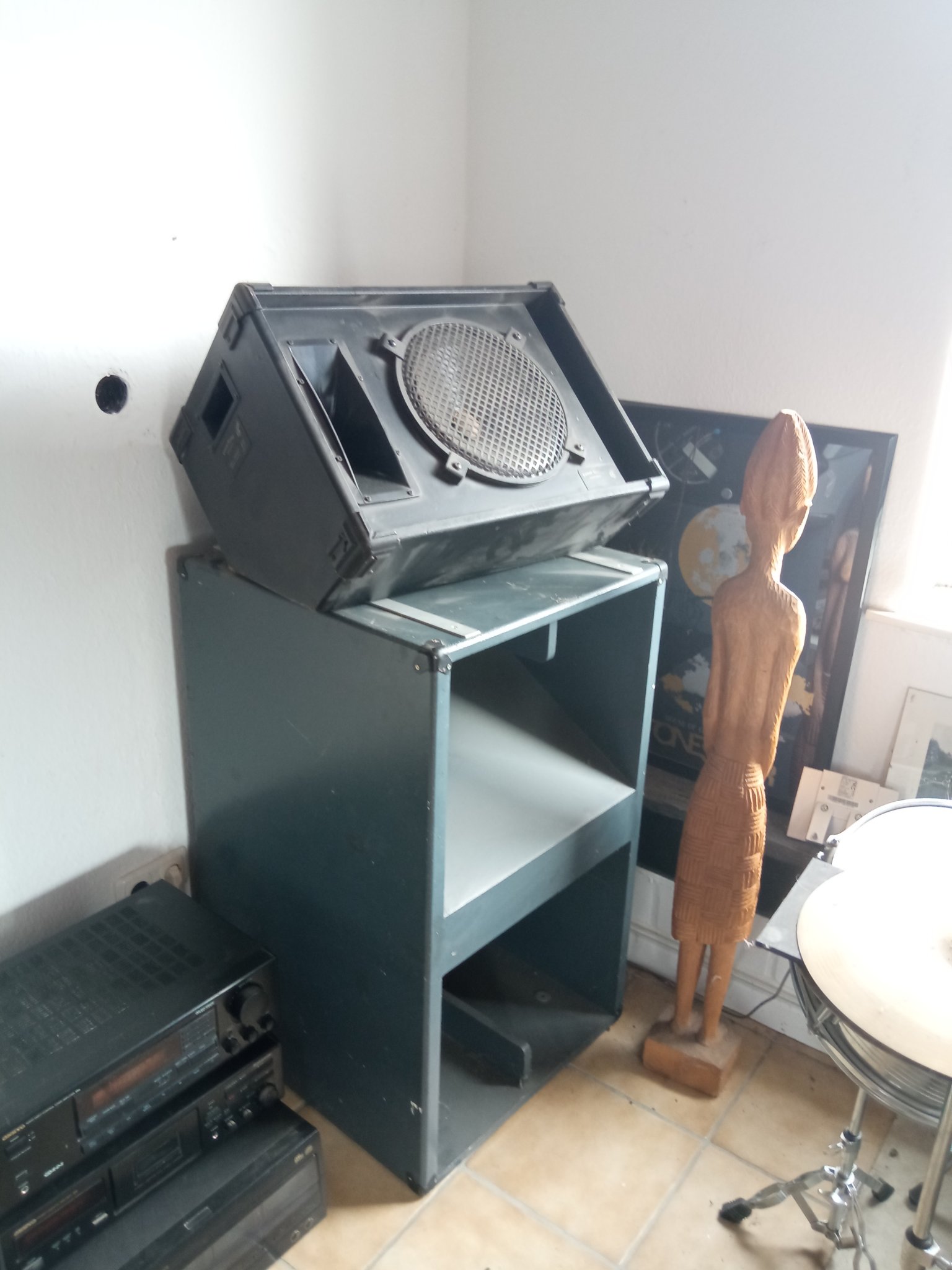

This is our home and party PA. Even as it is used for watching TV too, she connects the modeling amp to it and rock's the house from time to time. Top is a 12” wedge with a compression driver, from 120 Hz down the 15” bass bin kicks in. Only the right one shown. Stereo of course.

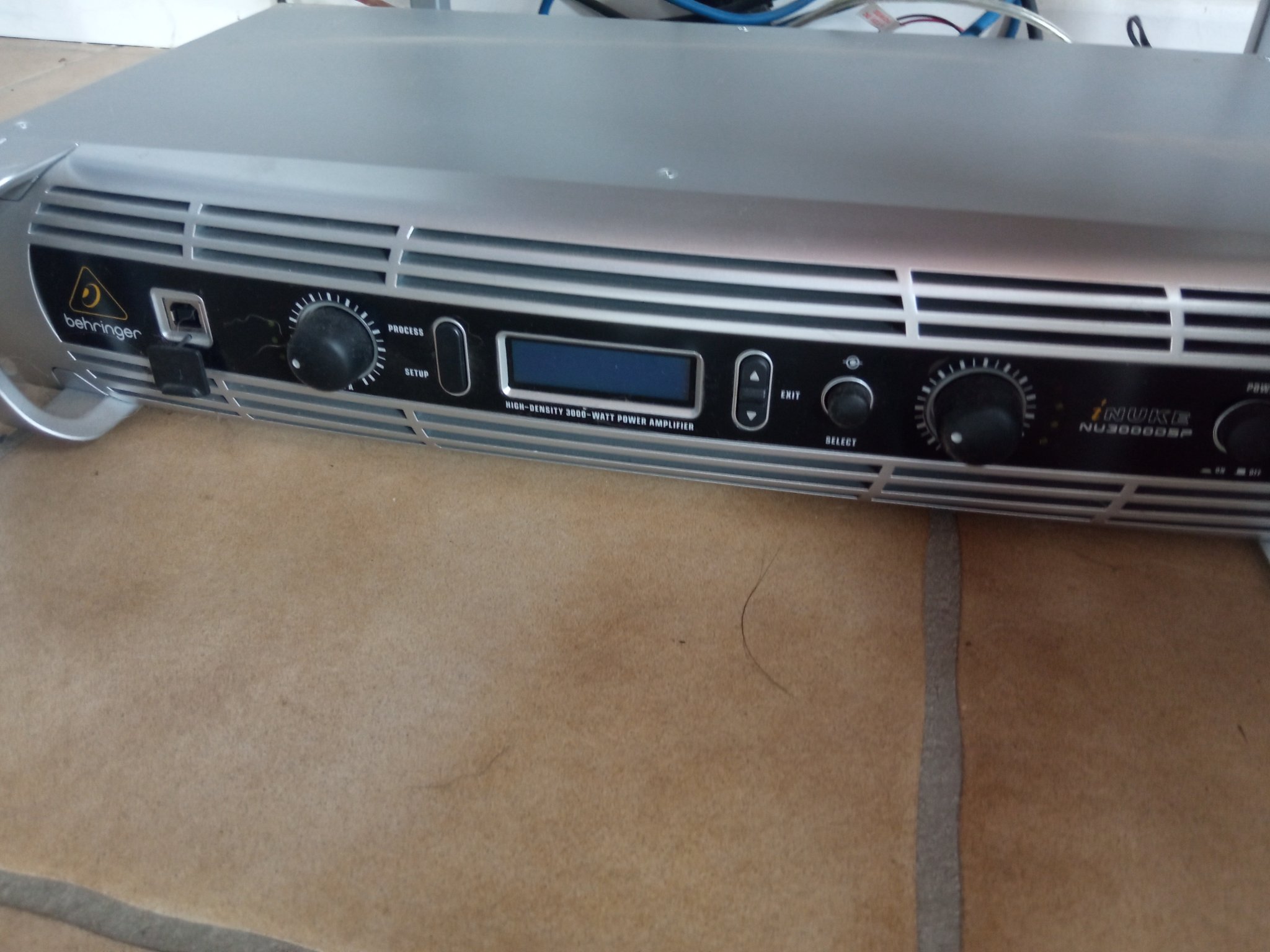

The little DSP amp (Behringer iNuke 3000) gives it some headroom.
