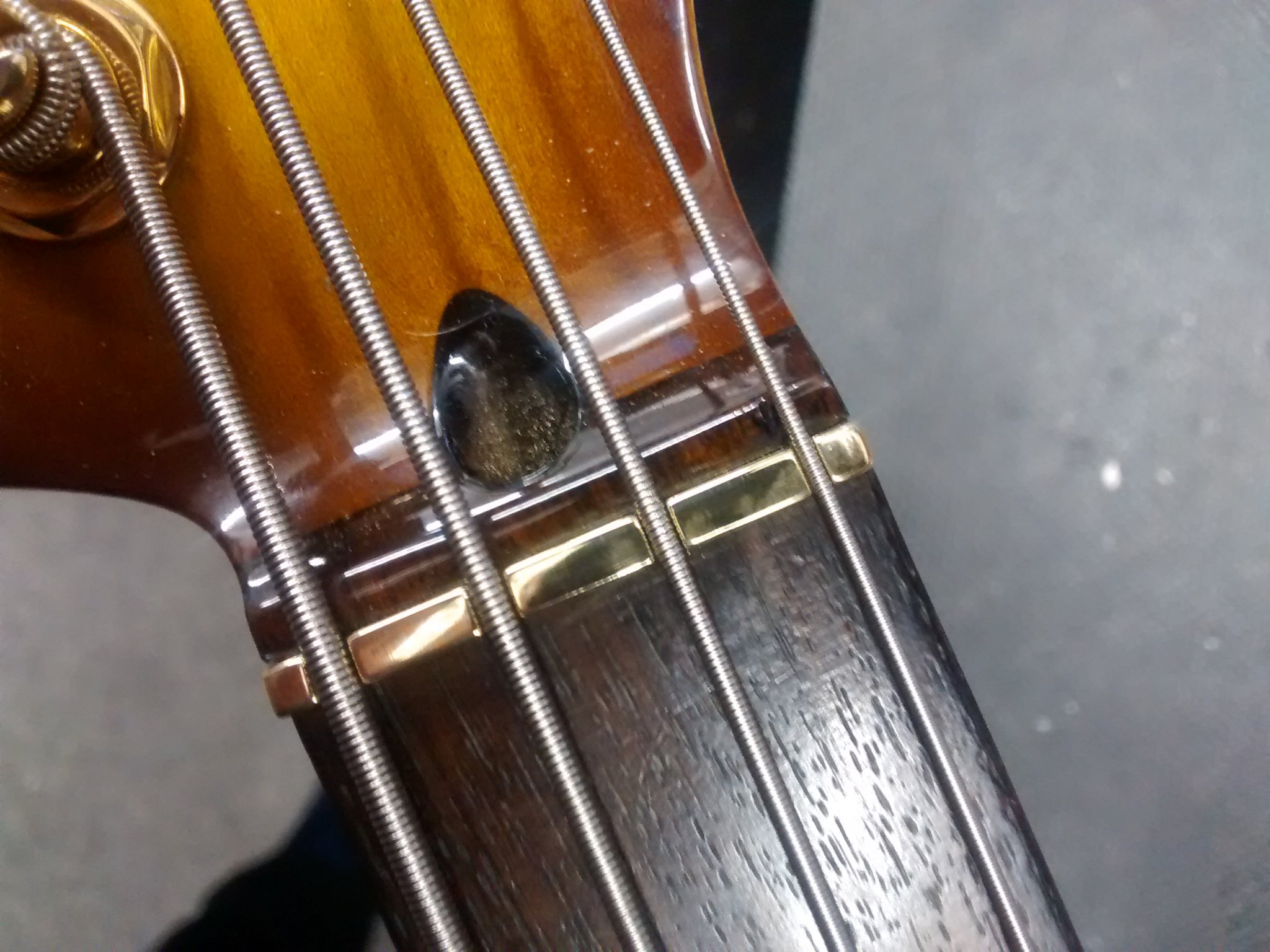

Just a quick post as many have asked about my neck jig, then we can get back to the drama and entertainment of the logitech bass revolution 😜
The jig accurately simulates string tension on the neck when the strings are removed.
Necks do not bend in an even curve like an arrow shooting bow, it's more of an uneven "S" shape as the neck approaches the body, so for most accurate fret dressing the neck must be put under the same tension as it has when strings are on and tuned to pitch.
So the guitar is strapped to the jig and the jig starts in the upright position (like when being played) so gravity can also come into play, guitar is tuned to pitch and neck straightened... the dial gauges (pressing on the centre of the neck in two positions) are zero'd... then the jig is layed in the flat position (as in photo).
The strings are then removed and the neck will back bow... tension is then applied by the little headstock jack (like mini car jack) and red pull down strap (at nut position) till the gauges read zero again.. this is as close as you can simulate a flat neck shape with strings on while strings are removed. The rods are then raised to support the neck in this position.
Traditional fret dressing is then done with an engineered beam long enough to cover all frets so the abrasion is completely even.
Nuts are a complete subject and science all to themselves, I only use bone & brass here, although I will use resin composites if people insist. Sometimes I carve more intricate designs on them but this guy just wanted large flat areas so that he could polish it easily... 1/1000" gaps are measured using gas nozzle cleaning rods... there you go, some "secrets" of guitar lutherie... there is nothing to hide, having a jig does not mean that you will be good with it, it still takes years of practice... 🙂
