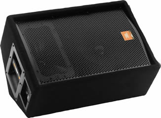

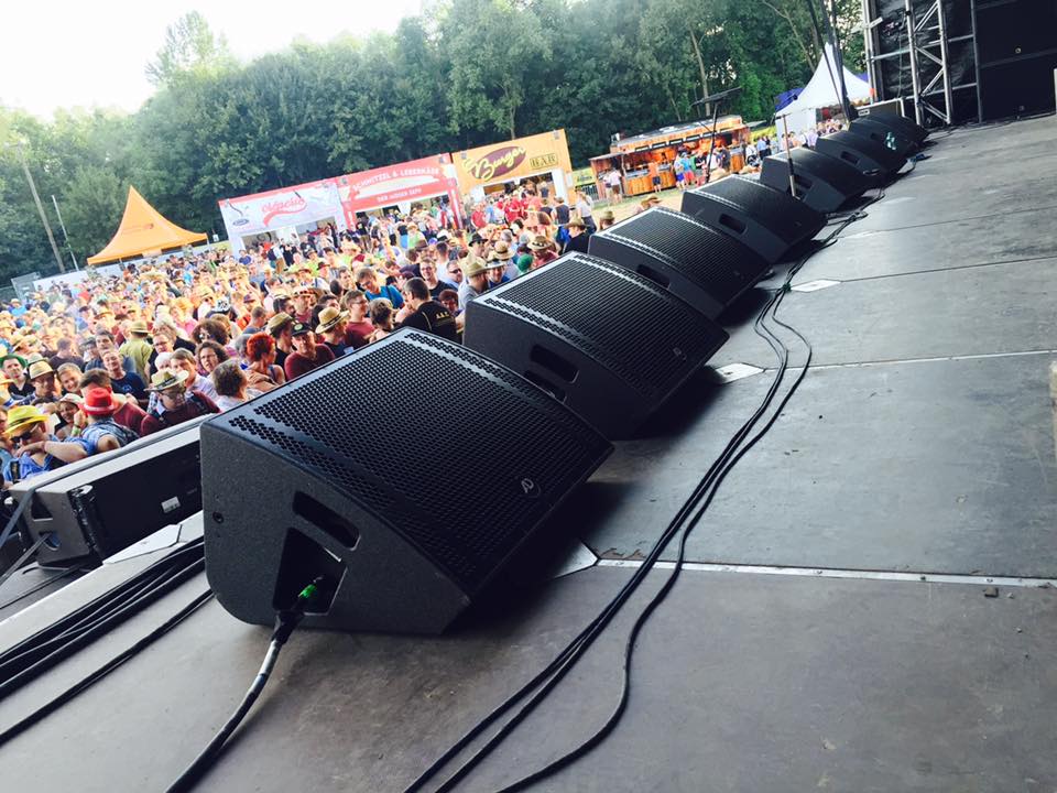

Hi, you need help, for sure.
There is a lot of PA gear that can be used in HIFI. There is hardly any HIFI gear that can be used for PA, usually even a try will melt it. The hardware talk in this thread really hurts. Sorry to say.
The best advice I can give to you: Talk to your daughters bass teacher. He should be able to point you to something useful. Do not take advice from people that want to sell you anything. You are really new to this stuff and an easy prey.
Instead of buying cheap, new gear, consider used, better stuff for the same money. Carefully check prices before buying, don't trust any seller. I often find used gear, years old and worn, for a higher price than you will pay for it, new on sale.
Musicians in most cases are poor, have lost a lot of money for their dreams and need to make profit even on old, defective junk, as most have been ripped off, too and think this is legitimate to do so with beginners. Sorry to say so. Reality bites. My daughter plays the guitar....
A very good compromise for home use may be a pair of monitor speaker's, such a thing that is sitting on the floor and points to the musician.
With a 15" speaker and a usually a small horn, this can reproduce bass guitar, lead and keyboards.
Such “wedges” are great party speaker's too and, with a sub woofer, can even make a small beginner PA.
Try before you buy!
Maybe record your own music and play it in a shop or at the sellers place, this will give you a good idea how well it may work for you.
You will need a small mixer and an amp too. Then you can start the first club tour with your family trio.
Good luck!

OP didn't mention any mixing console (with VU/peak meters), he wants to connect bass-guitar directly (via pedal box) to the hi-fi amp and speakers!
