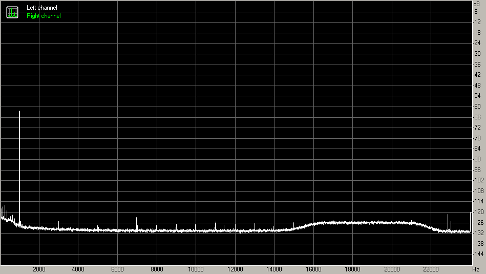

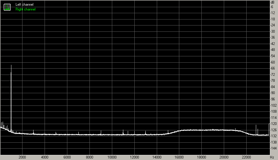

I've checked all the pcm63's I have: both the "military grade pcm63k" ($25ea) and "ultra rare pcm63p-y" ($60ea) bought from A'af. From what I can see the best of the Y's is slightly better terms of harmonics that the best 63k. The worst of the Y's is on a par with the worst 63K.
Attached is the best Y

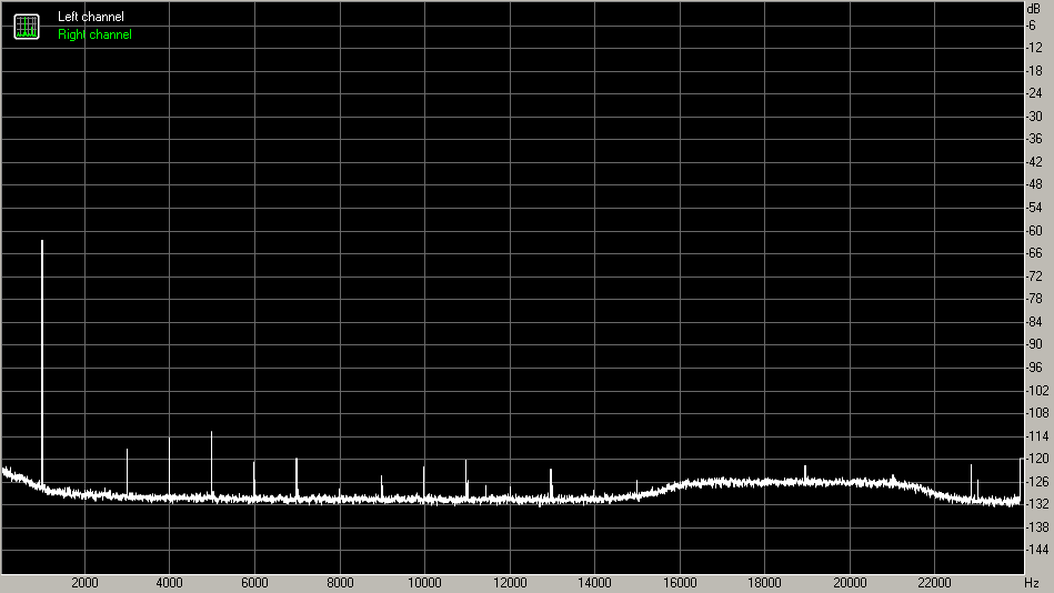

And this is the best of the "junker" PCM63K.
The noise floor seems more "jaggy" than the Y but the measurements were taken in the morning vs at night so there is possibly more rf junk. I also forgot to switch off the wifi base station so that could be contributing low level hash.

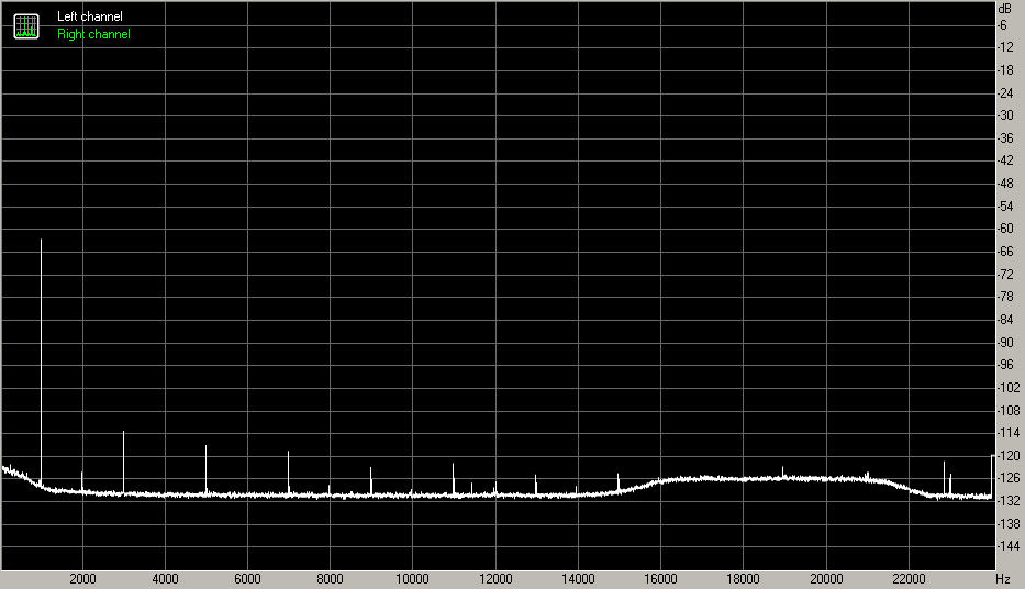

And the worst of the PCM63K for comparison.
which really just goes to underline what has been said previously: that there is no value in buying expensive stamps. You are faced with the same proposition of testing each chip to get a good performing set.
