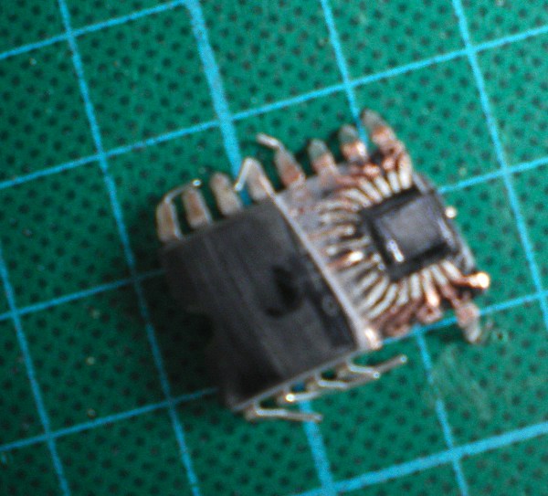

FWIW I have dismembered a Y that arrived here dead. From what I can tell there is no embedded SMD so that possibility can be eliminated from the list as far as I'm concerned. Sorry the pic is so blurry. The grey area is the wafer which finishes where the chip has been cut in half.
It is possibile the late date coded chips were TI/BB made production runs to manufacturer order after the chips were officially taken off the market.
