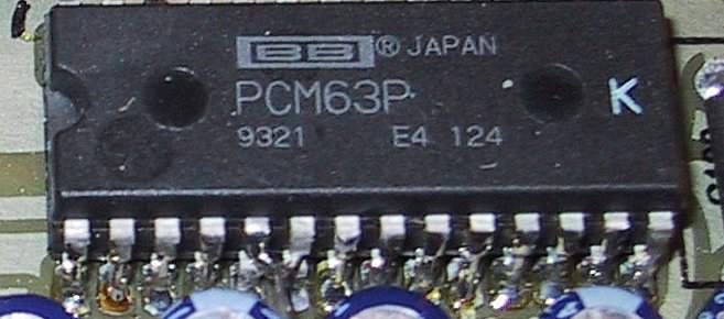

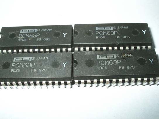

Hello, a good friend of mine oredered and recently recieved a pair of PCM63 - Y grade. Somewhere in the forum there was discussion about this not well known grade. These devices put into the contactors instead of my own pair of K grades sound very different and for sure not better. I took a detailed look at them, here they are:
What made me doubt if they might be fake is the place of "Y" grade marking - not where they put J or K, and most - the pins are so clean, shining and scratchless as they had not passed production test and had not been put in a contactor.
I wonder what you might say looking at this chips...
Maybe the Y lasered / etched (?) are produced to meet specs while K stamped are selected from production.

What made me doubt if they might be fake is the place of "Y" grade marking - not where they put J or K, and most - the pins are so clean, shining... [/B ]
I was the one who started the subject, so I see myself somehow responsible...
First, do note that I got similar "Y" Chips, and only the dates are different: 0323 E9 027.
It is also BB Japan, same colours which are engraved on the Chip.
Like Bernhard I assume that this come from some special series.
Can it be at all fake? I wonder, because if it is not PCM63, what can it be??

What I see on the picture of your DAC there is "-" sign before the grade letter "Y". On my friend's DACs this is not there. That seems inappropriate.

I've ended up with '04 DC 63P Y's as shown in the pic at the start of this thread. Unfortunately I can't compare with any "know good" PCM63's except to say they are far better than pcm63k's A'af was selling.

Now something even more strange: In all the original BB Japan PCM63 Chips (and I visually inspected ALL Japan - P, J, K, K2 and Y, chips), the letters "PCM" are printed exactly under the big “BB” letters. This is so also in your case, however not in mine (!), so if something is faked, my "Y"s have a good chance to be the faked ones... :headshot:
On the contrary, when I got the Chips, they looked just like I would expect a new-old-stock to be: The legs have been perfectly straight & symmetric. It was quite hard to put them in the sockets, and I had to "form" them correctly (!).
I would have thought that someone indeed re-engraved / refurbished them so that they will look new. However, if the were used, I would have noticed it on the legs, I am pretty sure. :smash:
My assumption: The chips are original BB, new-old-stock. However, for some unknown reason, someone have marked them new. It might have some criminal energy behind it or not.
I assume that while marking the Chips, there have been also some selection/identifications mistakes or confusion.

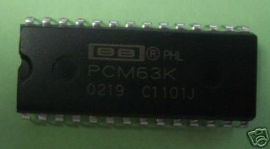

Note that there are also "K" and "K2" Chips on the market (also from A'AF) which are gold coloured; all have new dates (2002, 2003, etc). I can tell you for sure that I compared a gold-coloured "K" with a regular "K" – and there have been no different in sound - both have been a real "K"! My own experience shows that the Type which is written on the Chip is normaly correct. My "Y"s are sounding excellent.
What can you do now? If you bought them from A’AF, just send them back to him and ask for a replacement. Ask him also for the source for the chips. He is known as reliable, and usually he will react fast. Please keep me/us informed.

thanks for posting the pics. where have these come from?
