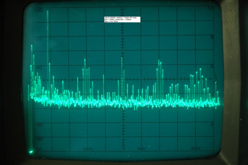

I use a hp 3580A spectrum analyzer to have this waveform on a KY chip. I think the 3580A use peak detector for the signal and this is an analogy spectrum and scanning takes a long time!
Test conditions:
Input SPDIR signal at -80dbfs, 1kHz signal
0db of spectrum scale is equale to -70dbm 600ohm
Total Span of specturm is 10khz or 1khz/div, vertical is 10db/div
The first tallest line from left is 1khz, and I can see 3rd, 5th, 7th harmonics.
The harmonics is about -105dbm max.
The IV is a common base jfet IV not a op-amp type.
I do not know why there are so many others harmonics around the 3rd, 5th, 7th harmonics. Is it due to the digital filter SM5842?
Please comment.

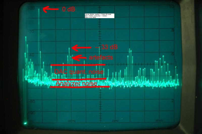

When I use the absolute scale like all of you, my PCM56 has worst harmonic -125 dB when tested with 1kHz -60dB signal 😎
The artefacts around your harmonics could come from a weak laser and disc reading problems, when playing CDR.
Looks like signal correlated noise. Listen to the signal.
Do you have other grades of PCM63 like J/K/K2 to compare ?
