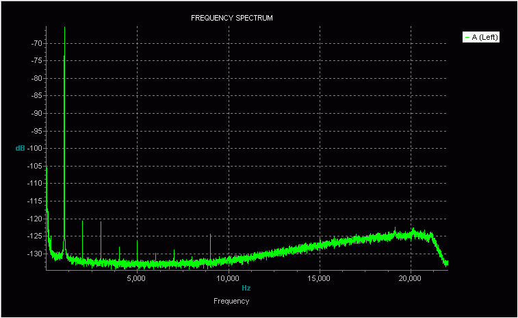

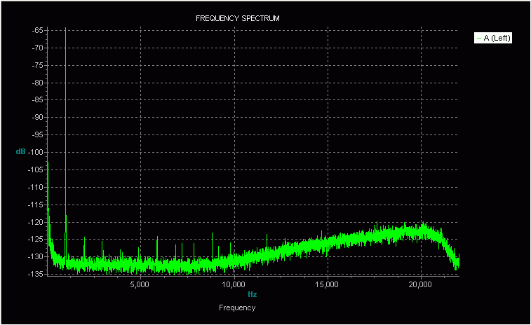

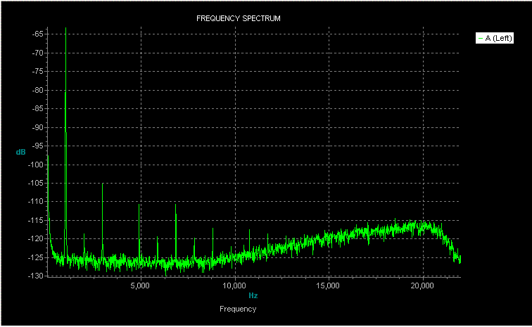

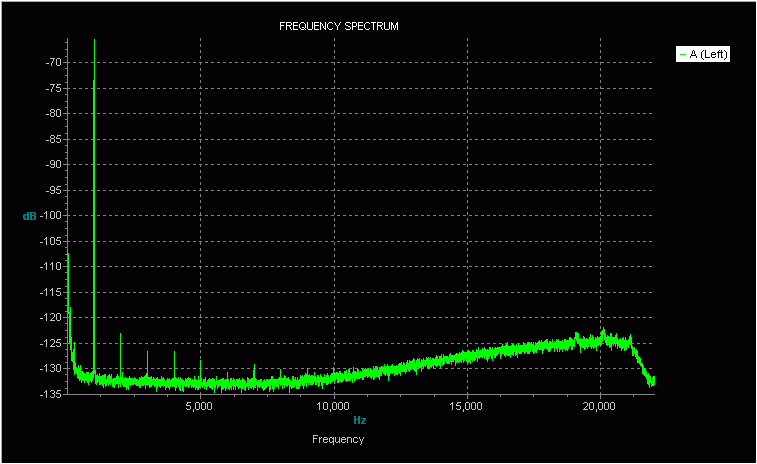

Only wanted to confirm again the finds of Bernhard and Paul.
After having redone the test shown earlier, with better resolution and more averaging, the pic got much clearer, and the spurs much more visible. And the best testing chips in my posession are the noname nostamp BBkorea ones from '98.. and the level differences are the same that had been shown.
A sidenote: if You think less spurs are the king, then try dithering:
my Rotel player measured so well because the dither was on, at level 7. [PMD100] This also forces somehow both channels more uniform.
Here it is again, dither level 7, and both channels looking like this:
(carrier level is -60db on the disc but measures like -65db here.)

Question to Paul: did You find a correlation between the sound and measurement level? I don't know, I would need more time to concentrate on it, but for me the better measuring korean chips did not sound better in the Dac, [apart from sounding horrible for the first couple hours.. though this had passed away later on]
