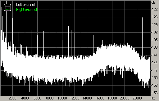

I discovered the right channel of the HDP2 is contributing the 12Khz peak and related harmonics. I have a feeling this is due to a MAX regulator chip. I'm in two minds about fixing this as the recorder was modified by Oade Brothers to their "Super Mod" standard and is sealed with a Oade anti-tamper sticker. I would have to ship back to the US for repairs to retain any kind of Oade warranty. The DIYer in me says "crack it open".
The left channel is relatively free of the 12Khz related trash, so the graphs are pretty ok.
I've found the recorded test tones files give -60dB peak while all the FFT displays seem to show a rms value? It shows lower than -60dB anyway.

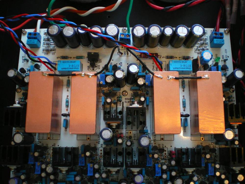

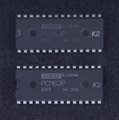

Indeed
It is as strange as my "Y" - the same kind of print, where the "PCM63" and "BB" are not perfectly one under the other, as it is usually the case with all the "normal" PCMs by BB Japan.
One can see this clearly when comparing to your old K2 Chips, even if they were not from the same bunch 😉

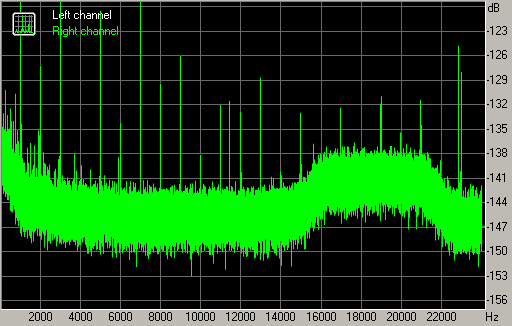

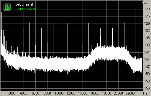

JK, IY and All,
I think the perhaps the harmonic distortion is only part of the story. The pair of the 63K that measure only slightly worse in terms on hd were audibly inferior to the Y that were worse on the basis of harmonics. The impression was of a veil over the sound coming from the channel they were installed in and the result was quite unpleasant to listen too. The DAC sounds ok with all 63K install or all Y's install but the mix and match is not pleasant to listen to due to the mis-matched sound.
Looking closer at the files I made, I summed the best two of each grade in an editor to get an idea of the effect of running in balanced mode. I found that the K's had a broader noise floor than the Y's. It looks like the noise floor could be around 2-3dB higher than the Y's, despite having generally lower peaks on harmonics. Given the listening tests showing the K's to be somewhat veiled it seems the noise floor have significant impact on perceived performance - possibly more so than harmonic distortion.
Wayne at Pass Labs said that he had a rig attached to an Audio Precision digital two which tested for distortion and linearity. The D1 chips were then matched on the basis of these tests. So seems to me that Harmonic Distortion is just a part of the equation and not the whole story.
attached is the spectrum of the summed Y's
And the summed K's.
I know these aren't taken directly from the balanced outputs but they do give an idea of the effect of cumulative noise and distortion for the two types of chip running in a balanced config.

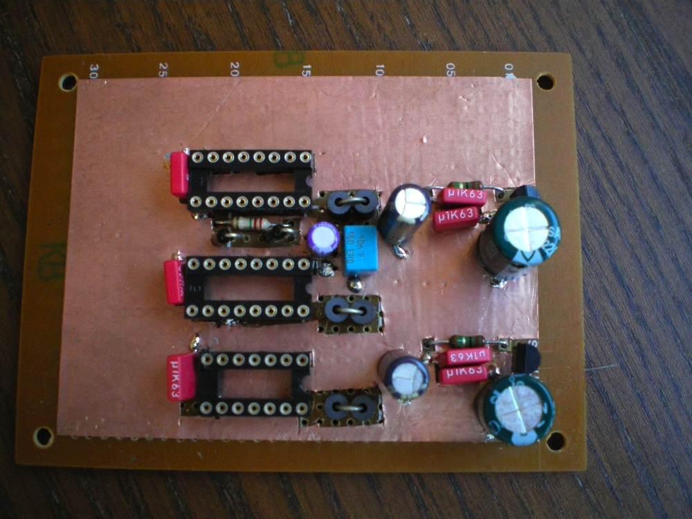

A clarification - I am running my D1V3 with a Tent vxco in a slightly modified version of the original Pass D1 secondary PLL circuit. This makes a very distinct difference in performance of the DAC. The bass and imaging is much tighter and precise than when running from the recovered clock as in the standard D1V3.
Attached is pic of the clock board during construction...
