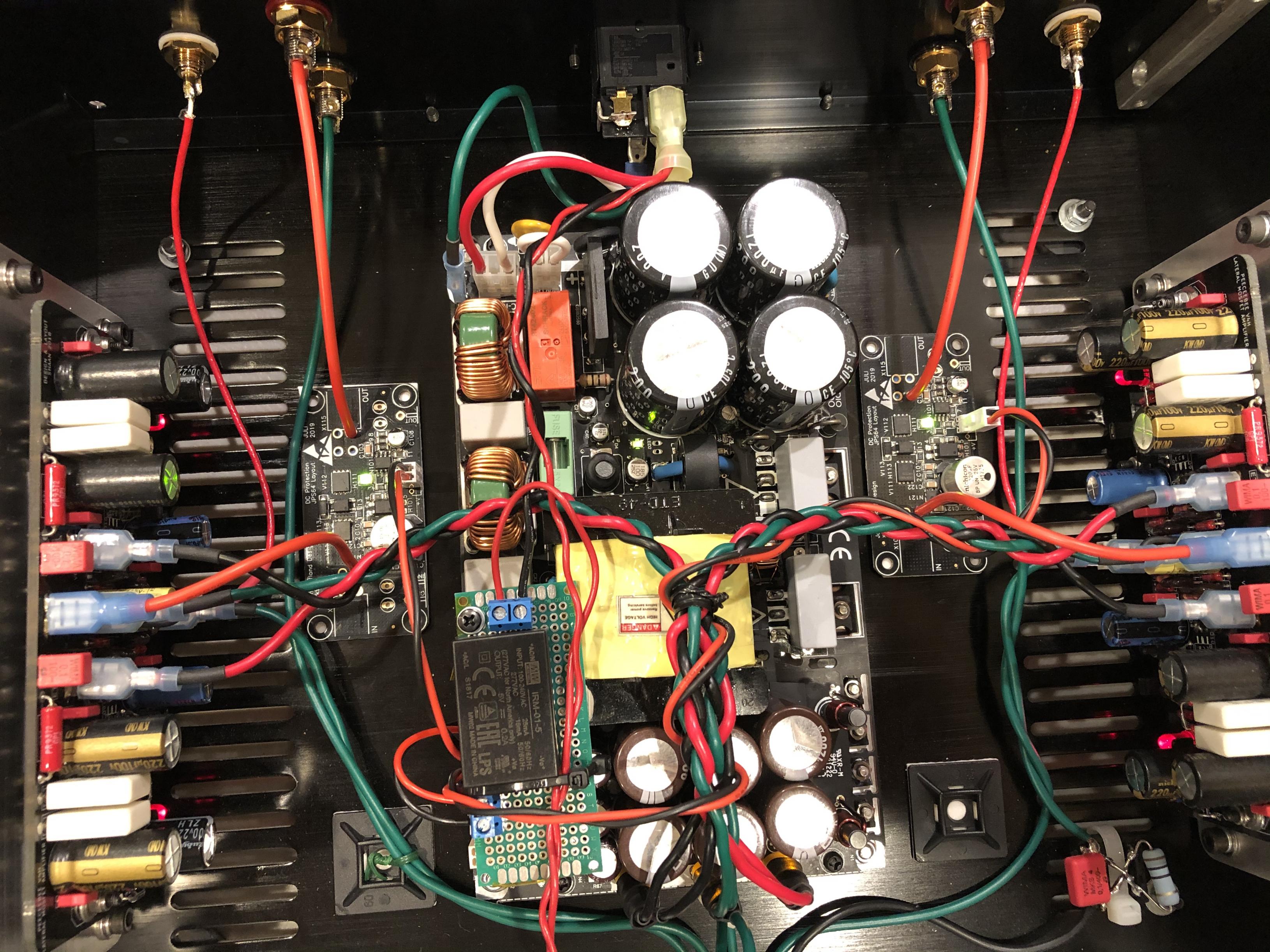

Audio inputs are XLR. PSU DC input and speaker out are all bananas. I am using two older MeanWell SP-240-24 SMPS supplies, and they don't complain about the capacitance. The only issue is their fan noise, so I am looking at the MeanWell LRS types without fan.
