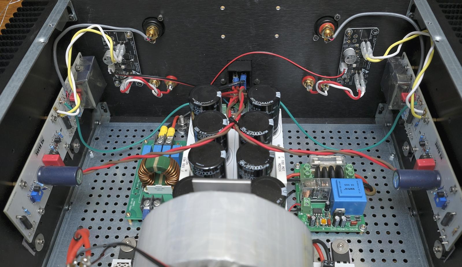

Nice work, Vunce! I see you are living dangerously - flying lead direct solder to the SSR board from the amp and speaker connector.
What’s the Meanwell 5v SMPS for?
Haha!! I know right 😉
The SSR DC protection boards are not going anywhere, so I kept hookup low profile 😀
The 5V Meanwell is to enable the Cresnet SMPS to enter standby mode. The front panel power switch turns the Meanwell On/Off.
That’s a nice looking amp, Drpro! Very clean neat and tidy implementation. I like how you mounted those RTR SSR’s.

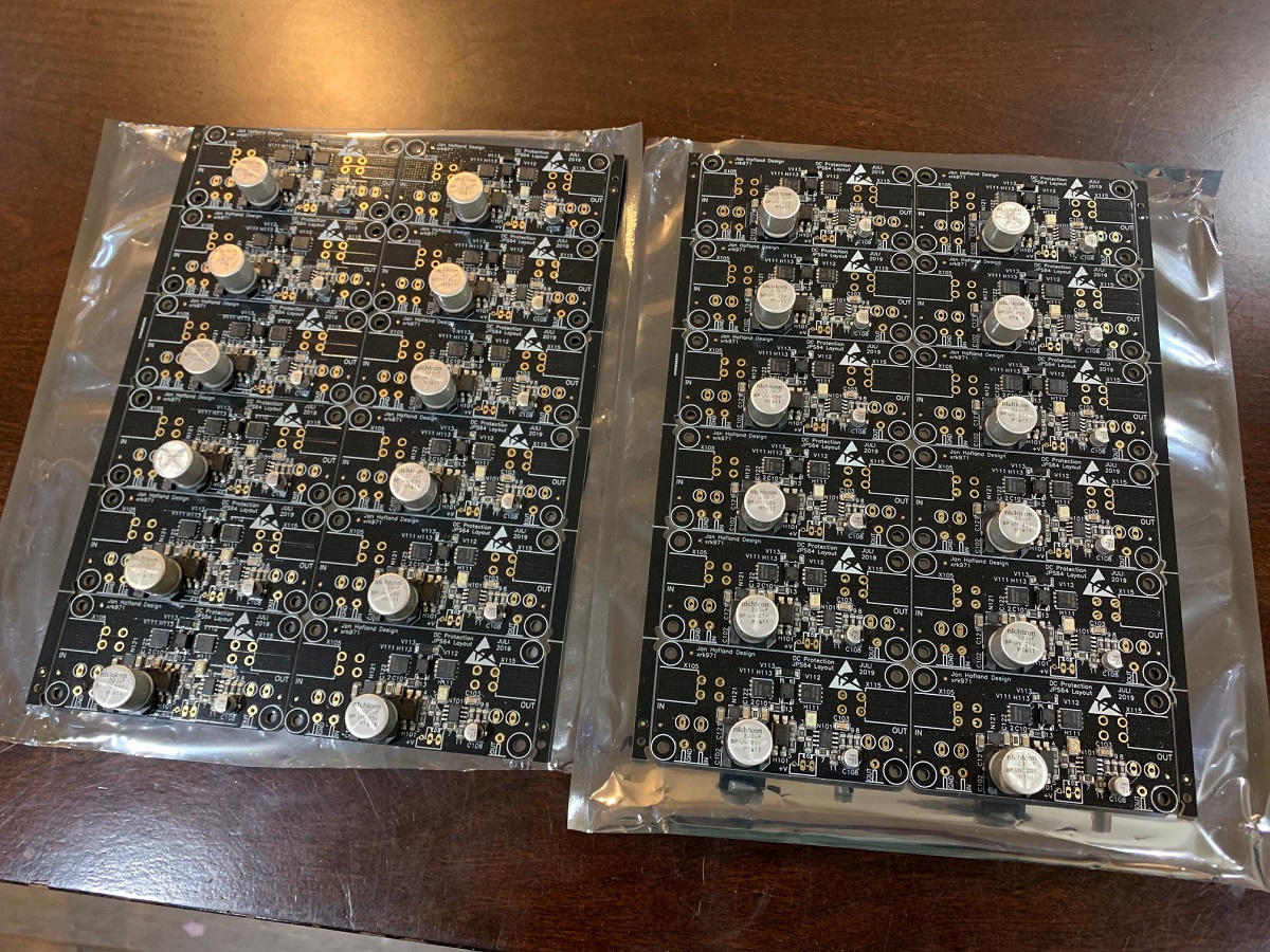

The new GB 2 boards are in. I tested a few random samples and they work. So now I need to install the 2 pin Molex KK connectors and test each one in my amp to make sure music plays. Then they can be shipped out. They are looking good though.
Just unsealed from their ESD safe bags:

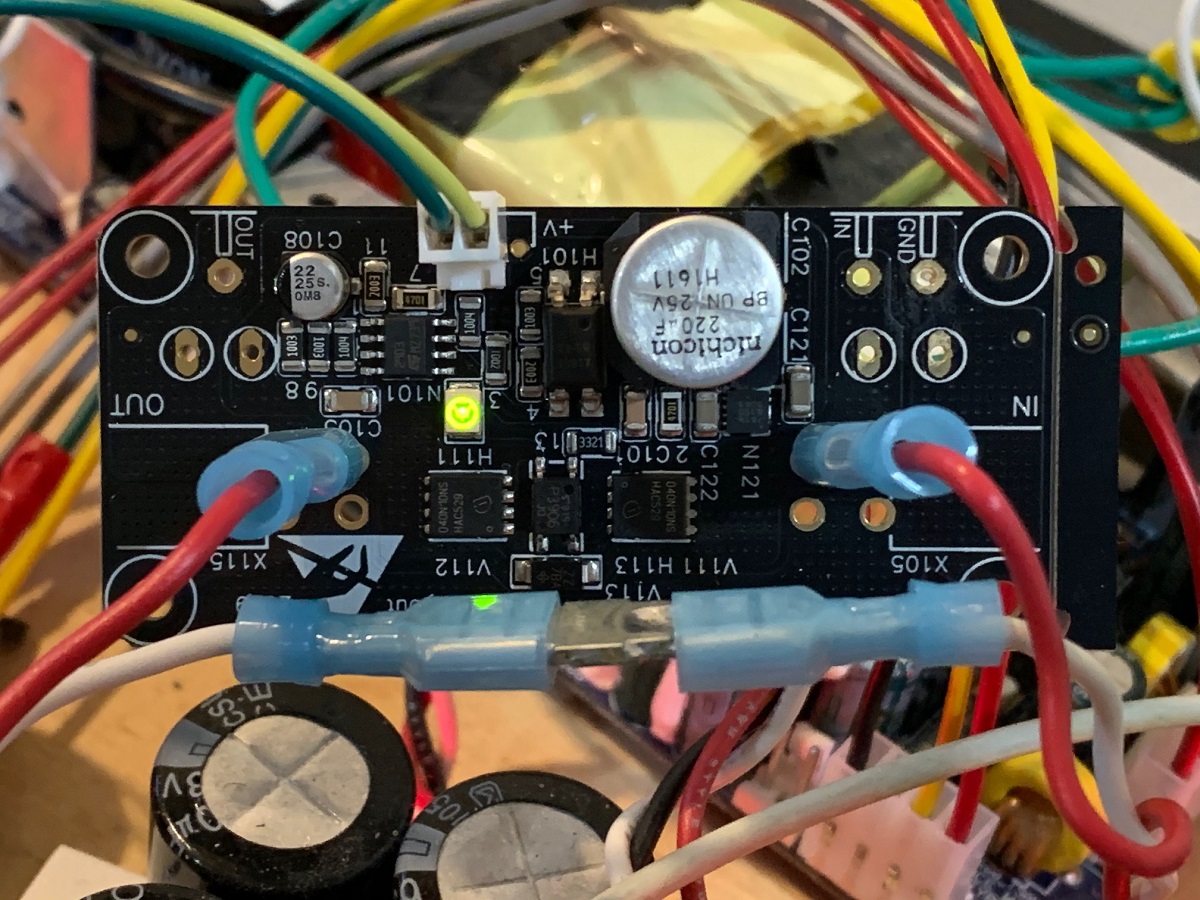

Testing with my amp:

I just finished testing 30 units and they all checked out. Need to package them up and then ship out. Just realized that I am out of bubble mailer envelopes.
