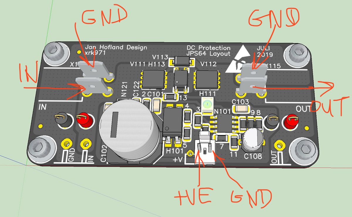

Is the ground for that power-in ground connected to the audio ground? If I have a separate power supply for the speaker protection module, I want to make sure it doesn't share the same ground.4. Also can it be powered from a separate supply - that is , it does not need to be referenced to the amp supply for the amp it is protecting.
That's correct, a 19v or 24v volt supply from a wall wart would be fine.
On the board, the Ground is shared. However, it is simply a pass-thru for the speaker. You can simply wire the amp -ve (return) directy to the speaker output binding post, or in some cases, people wire the speaker -ve directly right back to the star GND hub on their PSU, bypassing the RTR SSR completely.
Yes, I plan to wire the speaker ground directly to the output binding post. My concern, however, is with the board's power supply ground. My amplifier rails are ±60VDC, which is too much for the speaker protection module (which apparently doesn't want more than +50VDC). Therefore, I need a separate supply for the board.On the board, the Ground is shared. However, it is simply a pass-thru for the speaker. You can simply wire the amp -ve (return) directy to the speaker output binding post, or in some cases, people wire the speaker -ve directly right back to the star GND hub on their PSU, bypassing the RTR SSR completely.
If I'm providing a separate supply, then it has both positive and ground, and its ground is not the same as the amplifier's ground. Hence, my question about whether those two grounds (board supply ground and audio ground) are common on the board.
While I'm at it, I assume that supply to power the board needs to be 19V DC. I've been using cheap Chinese speaker protection modules, and I'm starting to suspect they're too cheap to trust. Hence my desire to use these boards instead. I was supplying them with 12VAC, but I can also do 24VAC with the same transformer. If I need ≥19VDC instead, then I may forego that transformer and use something like MEAN WELL IRM-01-24 to convert from 115VAC directly to 24VDC. Does that make sense?
Thanks in advance for your feedback.
Actually, the voltage regulator can handle 150v. However, make sure the voltage drop x 4mA dissipation isn’t too high. 60v - 15v is 45v x 4mA is 180mW. That should be fine. You can use the on board 60v supply.
No, 2 wires are +ve and 2 are GND. The top 2 are GND and bottom 2 are +ve from amp on left and to the speaker on right side. Just look at the traces. They are paralleled for more current.
Hi X,
Sorry, I'm afraid I have some difficulties with the schematic in your post #364.
OK, the top 2 holes on X105 (input) and X115 (output) are Ground - so I can use the bottom 2 holes:
* on X105 to take a spade terminal for the AN PCB spkr out
* and on X115 for a spade terminal which will connect to the +ve spkr terminal.
And I take Ground straight from the AN PCB to the -ve spkr terminal.
Correct?

Also, the 2-pin Molex connector down the bottom is to provide +ve DC and Ground to the SSR? The +ve DC is the pin on the left?
Correct?
(I ask this because the '+V' is actually printed next to a 3rd hole - which is unused.)
