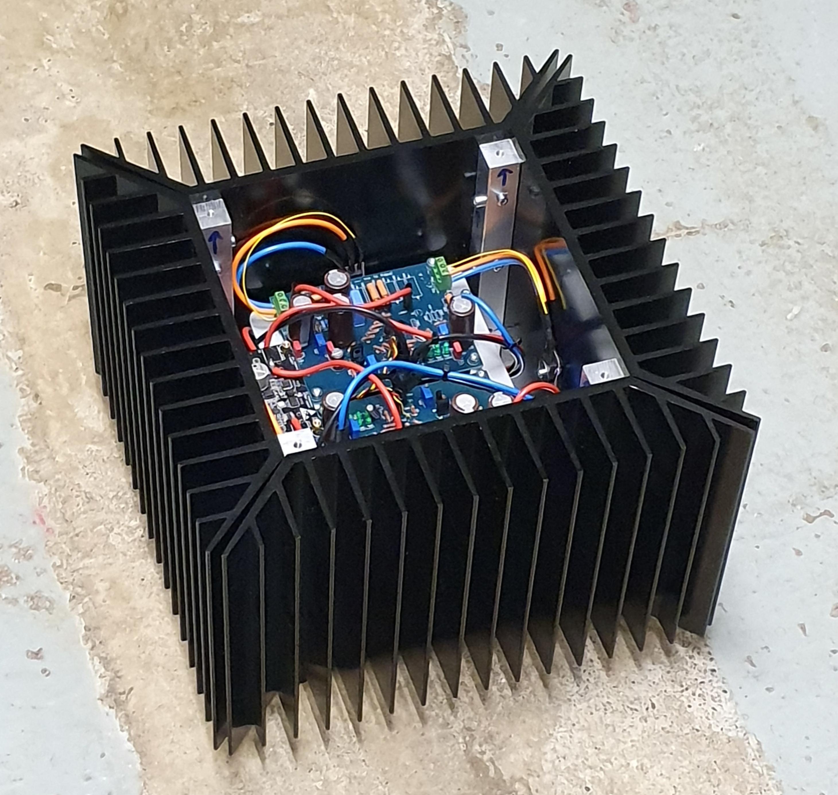

They are tiny. They work great. Here are some photos of my recent built, where I used two SSRs stacked on top of each other: Pictures of your diy Pass amplifier (post 4929)
Hi Mbrennwa,
That’s one of the coolest looking Class A amps I have seen anywhere, nice work! I see you are using remotely located MOSFETs as well. The snubber boards that come with the Alpha Nirvana are now available separately if you would like to use them. They will remove the mechanical stress of the wires bending the legs on the MOSFETs - which could lead to breakage if there is too much vibration. The RTR SSR’s indeed look small and can fit just about anywhere. How do you connect wires into and out of this box if the sides are all find? Is there a pedestal with jacks?

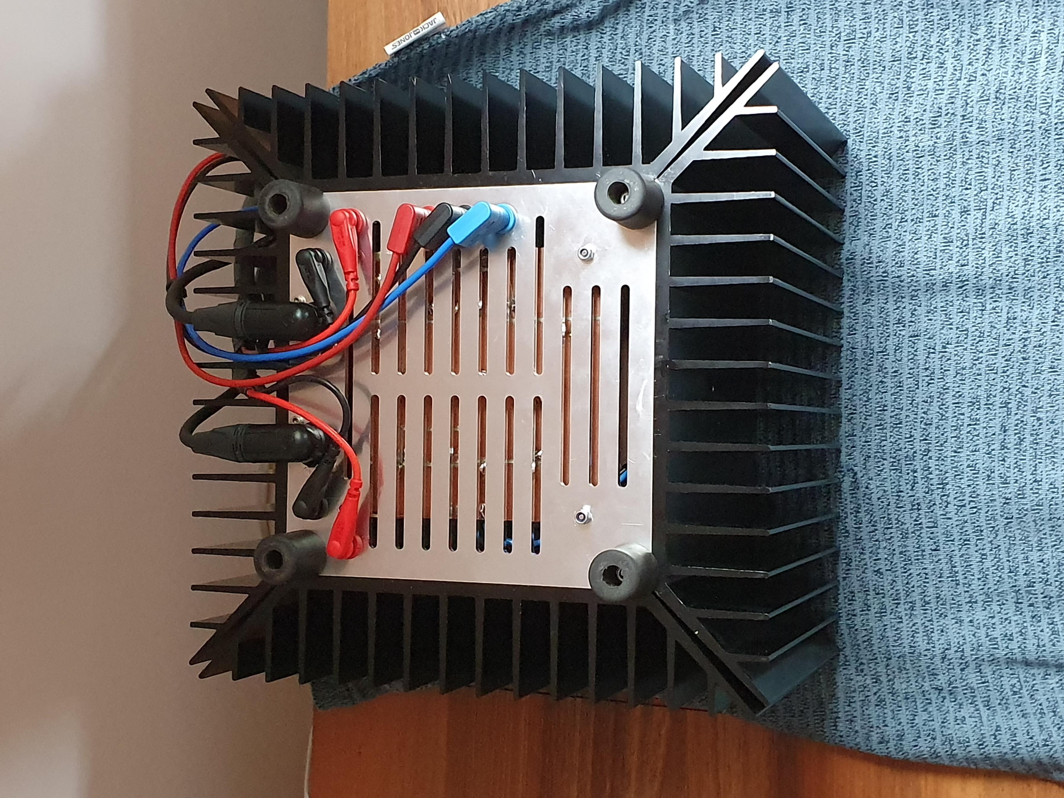

Connections are on the bottom. See attachment.
