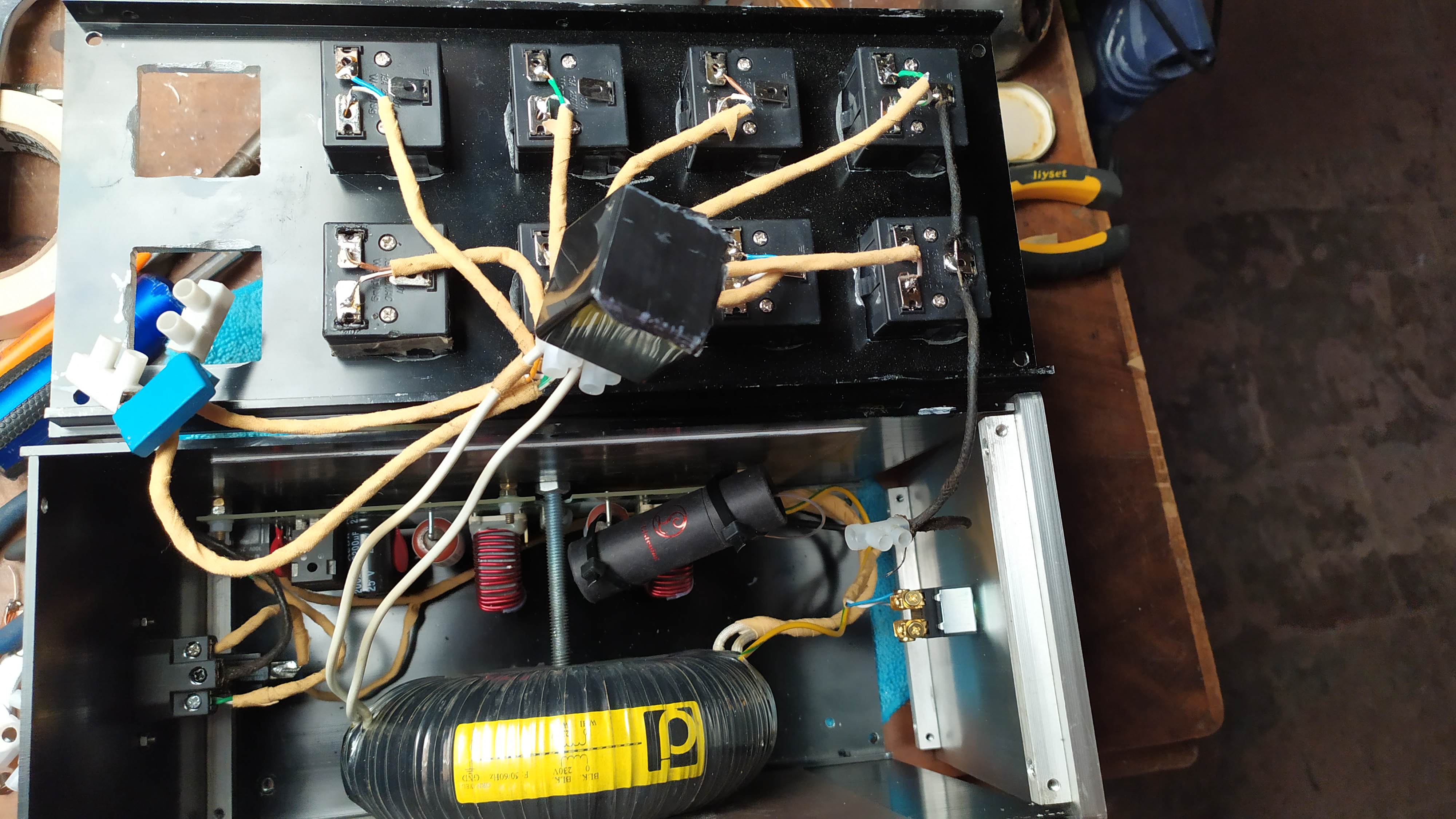

Hi Xrk, instead of inside amplifier I would like to put this soft start in my main AC filter supply case, it has a big isolation transformer 230v-230v for all components in the system (audio,computer and video).
Does it makes sense? Is there a board for one only primary leadout transformer? dissapoint not having the remote feature on a one single transformer version.
Jordi.
Jordi.
