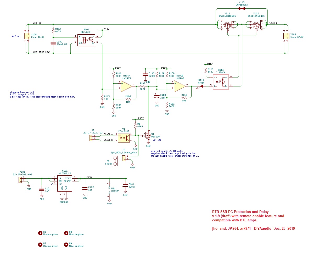

Hi Folks,
Actually, before starting production of GB2, it seems maybe adding two changes would be in order. (1) isolating the speaker -ve from the PSU ground will allow use of this with BTL amps where both +ve and -ve speaker outputs are live; (2) a remote enable feature that allows a 1mA remotely provided signal from an external logic device like an MCU or relay to shut off the SSR's (typical 3.3v or higher logic levels from micro-controller general purpose I/O pins will work). This may be useful for folks who want to control the SSR themselves to follow a certain startup or shutdown sequence, or even to provide user-directed speaker muting. It will also tie in nicely with the to be built Soft Start circuit. We think a small change of an added optoisolator, a MOSFET, a resistor, and set of PCB header pins for bypassing the "enable" feature, and a second Molex KK connector should not be too difficult to do and is a minor change that we will test and verify via P2P prior to the fabrication.
Here is the proposed circuit from Jhofland:
attachment.php
It sounds like the Meanwell has internal capacitance. 15w at 24v is capable of 625mA. The SSR’s need 40mA for the pair.
To drain 625mA in 1 second will take something like 39R 25w resistor. And it will get hot.
You could use the Meanwell to power a DC-DC with almost zero storage - that’s what I used.
Maybe something like this? (Not same as what I used)
