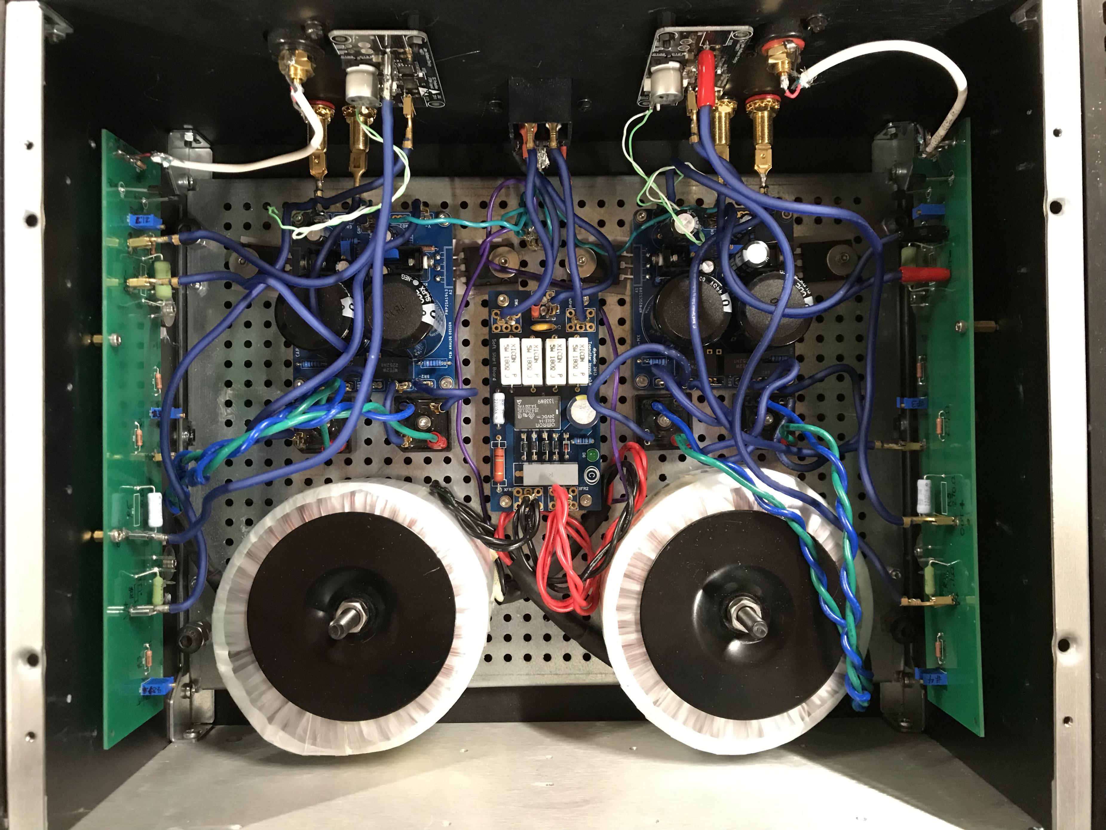

Another happy SSR user here! I installed a pair in my Class A chassis today. It was so quick and easy. Just robbed a little power off of each positive rail and hooked up the positive speaker output through each SSR. That’s it! Worked like a charm on power up. I certainly can’t hear any difference in sound quality, just as X’s measurements show. Thanks for a great speaker protection board everyone!
Looks great Jwjarch! I think I provided the matching female Molex KK 2pin connector, but looks like you soldered the leads directly for the power. I like the single screw solution to hold it all in. Doesn’t need much.
What amp is that?
What amp is that?
Thanks X. I think you did. I probably left them at the bottom of the envelope in my haste to get them installed. Going to take the amp to my friend’s place for a listening session and don’t want to blow up his speakers. 😉 I’ll go back and clean things up a little more with the KK connectors. There is another nylon standoff under each board to provide a little more stability for now. Again, I was rushing things a bit and didn’t have time to drill more holes. I just used the holes I had there from my old DiyA speaker protect board. You’re, right though, these little boards don’t need much. They can fit just about anywhere.
I hesitate to call the amp an F7 since NP hasn’t released the official schematic yet, but that’s basically what it is. Based off of Oreo382’s schematic and PCB’s. It uses Exicon lateral mosfets and Toshiba jfets in the front end. Great sounding amp!

I was very curious about it since the circuit seems so simple and I also wanted to see what the lateral mosfet sound was all about. I like it so far. Unfortunately I used the same chassis that my Alpha 20 was in, so I can't A/B them. But, from my memory I can say the bass is probably more pronounced with the F7 vs the Alpha. Sound stage and imaging are also great. Probably on par with the Alpha, but again, hard to tell without having both to compare side by side. I also switched to a dual mono PSU using the Gtose, Prasi, Mark Johnson Cap Multiplier boards. So I'm sure that also affected things...in a really good way. 😉
