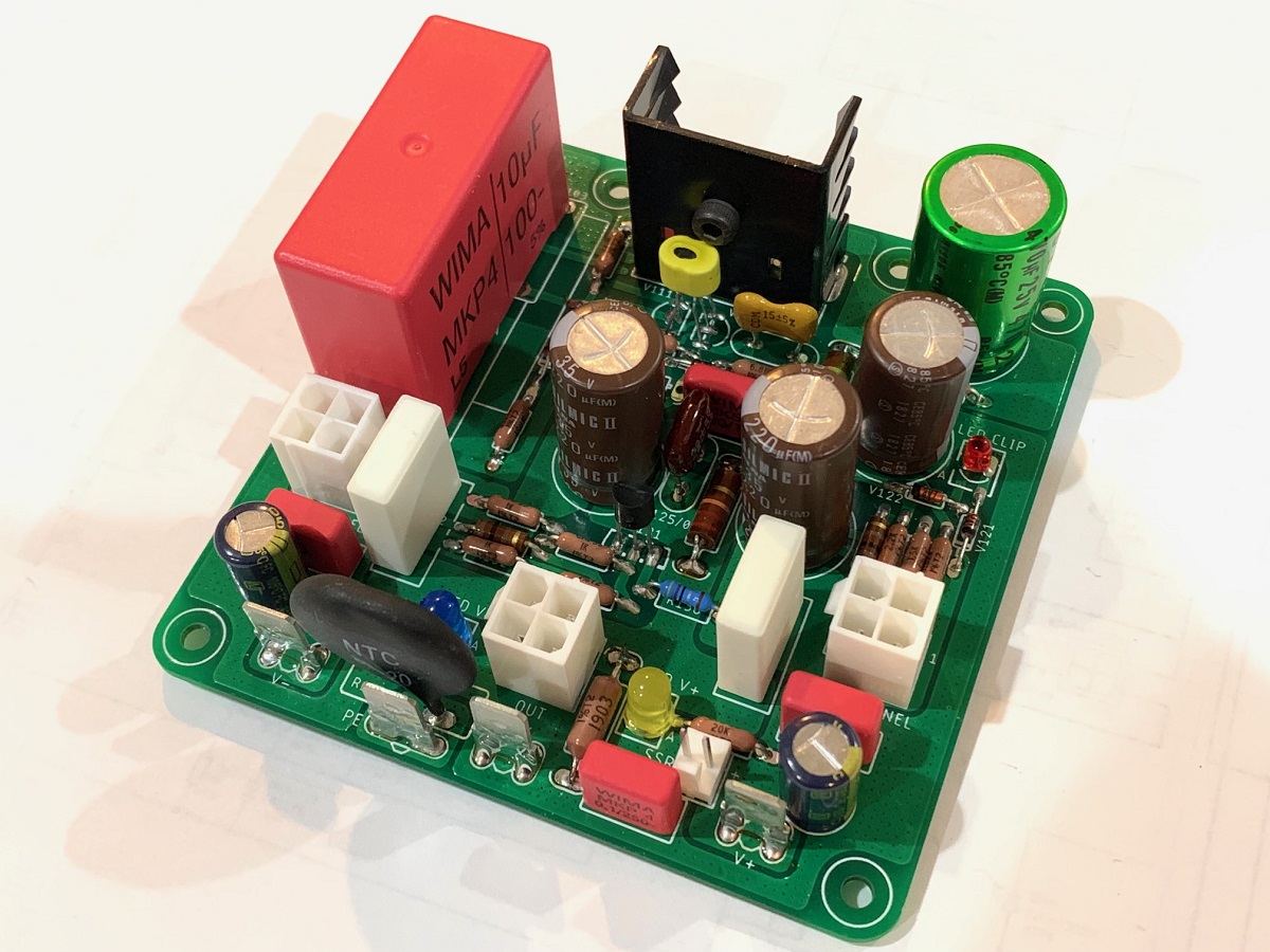

Hi X,
Can you confirm that for use of the 4 pole Molex connectors X105 and X115 for In and Out on the SSR pcb it has all 4 pins in use (so one can connect a wire to any of the 4 pins - or 2 off for higher current and more reliability).
No, 2 wires are +ve and 2 are GND. The top 2 are GND and bottom 2 are +ve from amp on left and to the speaker on right side. Just look at the traces. They are paralleled for more current.
770899d1564239251-ready-run-rtr-ssr-dc-speaker-protection-delay-gb-ssr-dc-protect-render-01-jpg

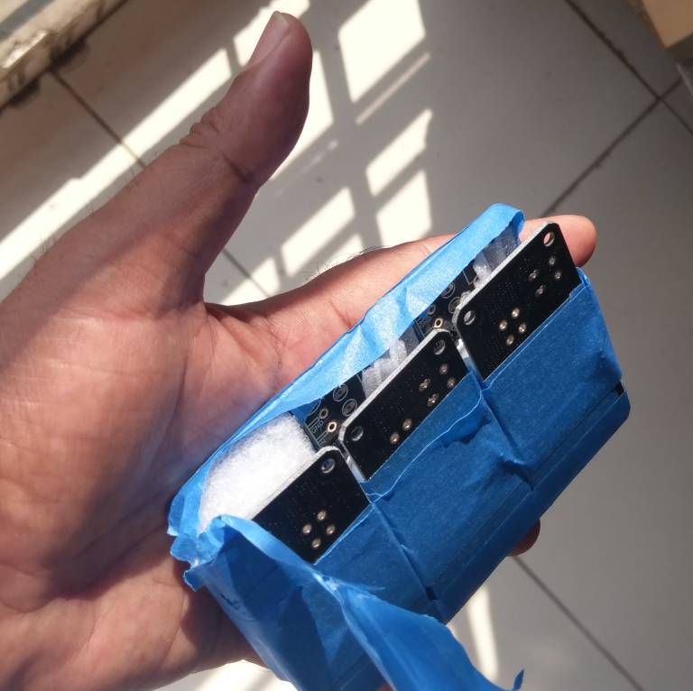

Hi Tcpip,
Thanks for the note to let us know it all got there in good shape. Thanks for your order - 6 is a lot to send to Bombay! I think the packaging worked out well then.
Let us know how they work out!
X
I most certainly will (let you know). I'm currently slightly worried about electrostatic damage to the MOSFETs in storage, since I'll take a few months to put together the amps which will use these modules.

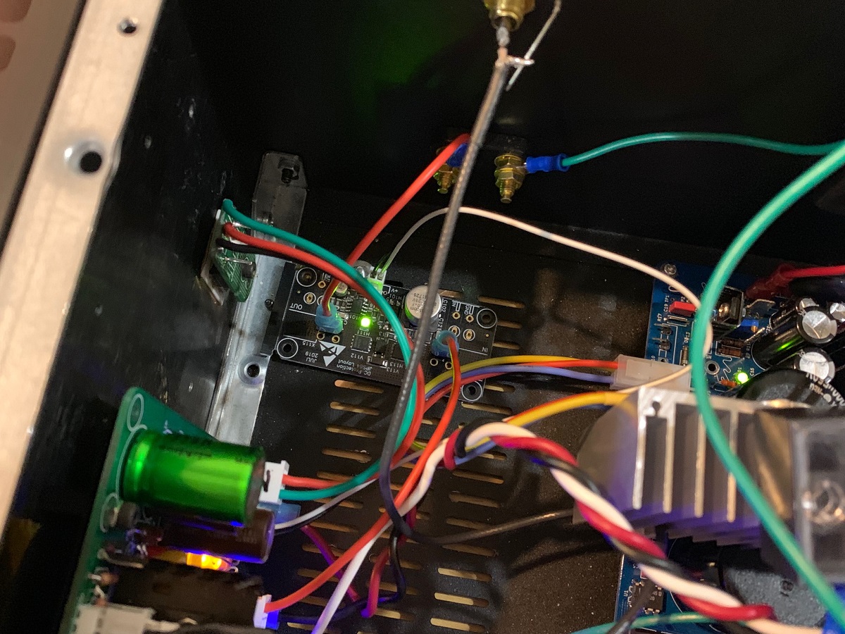

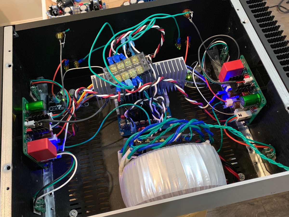

I just finished installing a set of these SSR's on my new Alpha Nirvana amp. Using only a single spade connector for IN and OUT and a Molex KK with amp PSU (provided through matching Molex KK header built into the Anlpha Nirvana PCB for the SSR). Sot it was all very easy and quick work to have SSR speaker protection now in place. No more turn on thump!
attachment.php
attachment.php
See the 2pin Molex KK connector at the bottom right of the PCB?
797234d1574584334-alpha-nirvana-39w-8ohm-class-amp-build-prototype-completed-main-02-jpg
