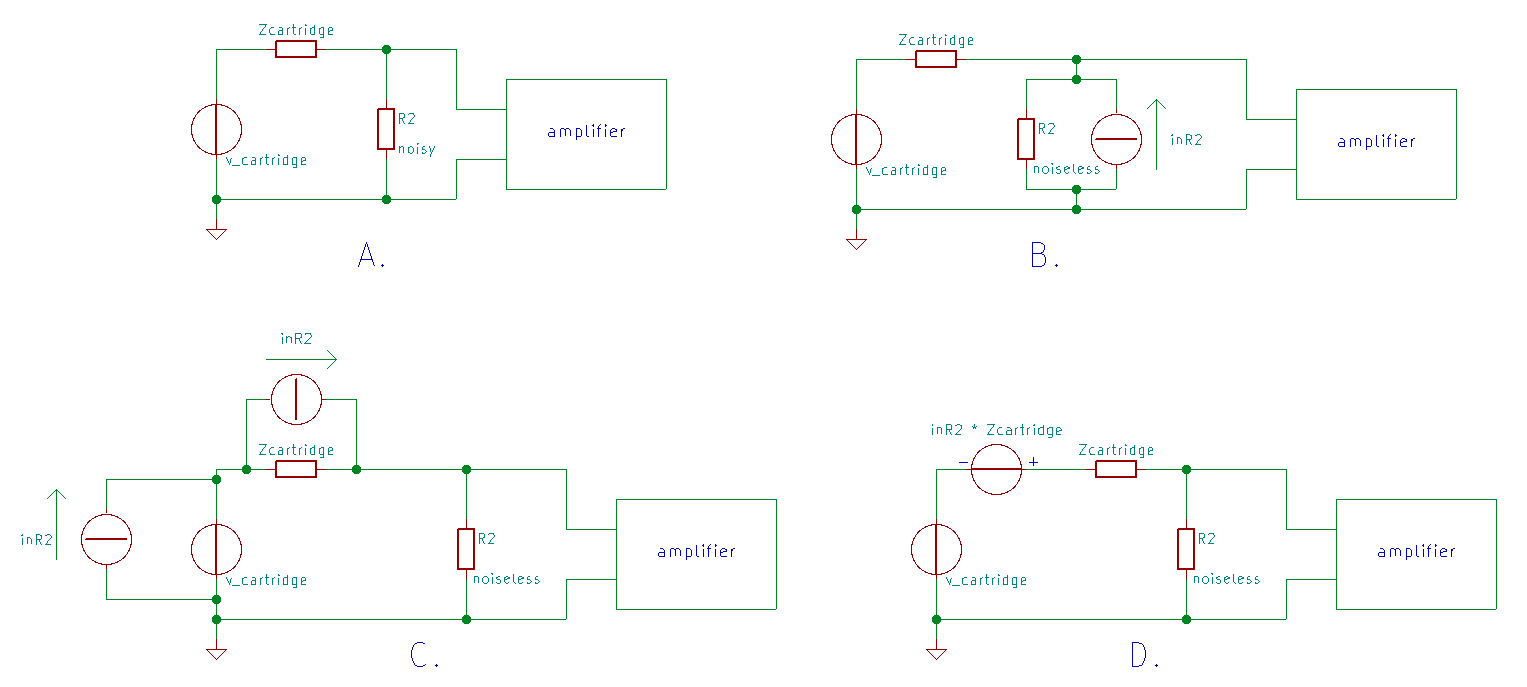

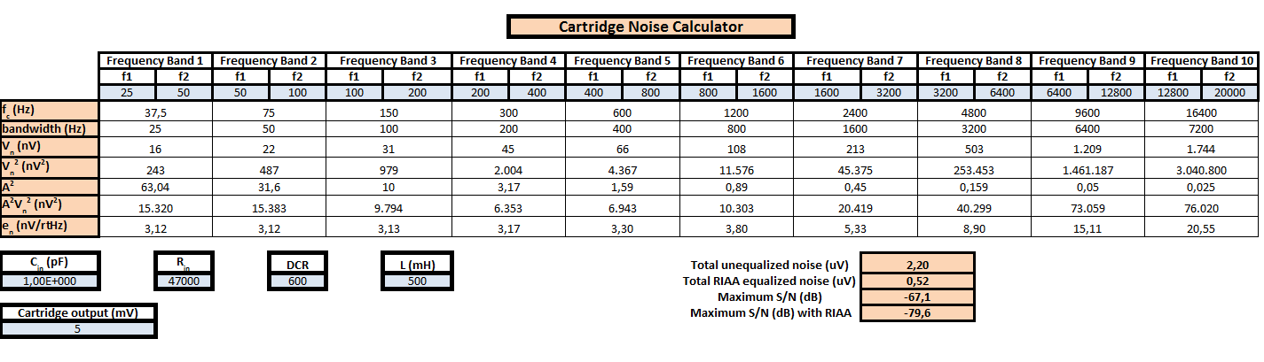

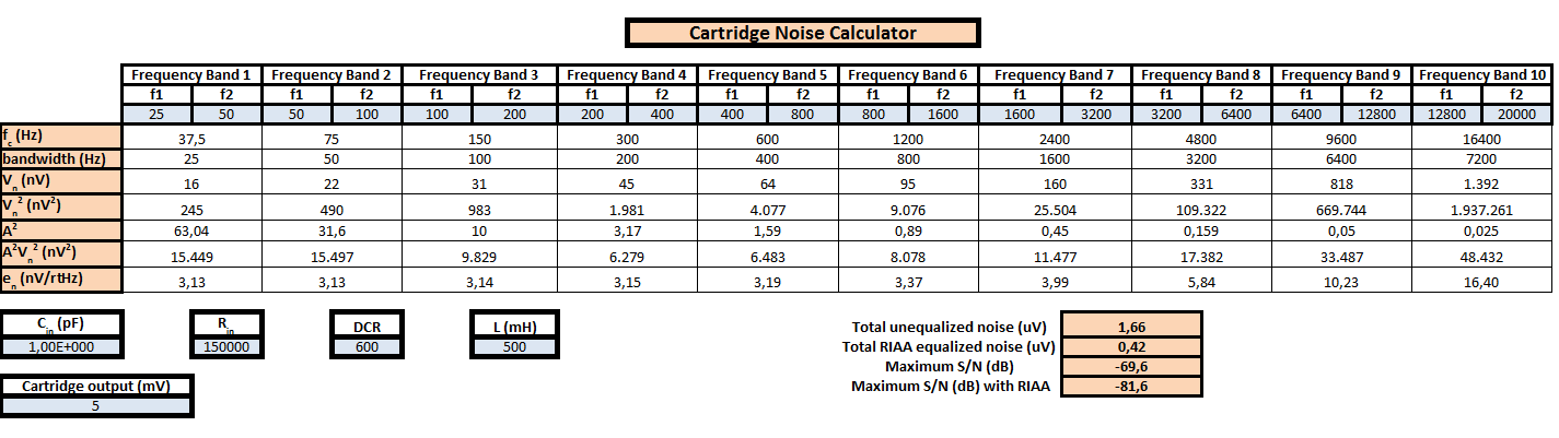

"|Zcartridge|" times ...Now apply a Norton-Thévenin transformation to the cartridge impedance and the current source in parallel with it, and you end up with part D, which has a noise voltage inR2 Zcartridge directly in series with the Thévenin voltage of the cartridge. The spectral density is |Zcartridge| √(4kT/R2) (and the power spectral density is therefore |Zcartridge|^2 4kT/R2). Note that this increases with decreasing R2.

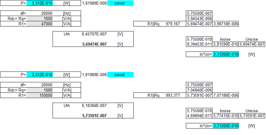

Nothing is easier to implement in the noise_n_.exe program than this suggested transformation from the dispute thread.
84pA * sqrt[ (Rcart)^2+(omega*Lcart)^2 ] =Uth
U_noise_47k = Uth * R2 / sqrt[ (Rcart+R2)^2+(omega*Lcart)^2 ] = 0.9709 * Uth
vs.
47pA * sqrt[ (Rcart)^2+(omega*Lcart)^2 ] =Uth
U_noise_150k = Uth * R2 / sqrt[ (Rcart+R2)^2+(omega*Lcart)^2 ] = 0.9925 * Uth
518.9nV vs. 299.03nV
bw=20kHz
The all-important question is: may* (here) R2 be transformed into a substitute noise current source for this mesh, viewed as a ring.
*is it permissible?
If this is the case, then a (here) R2, as a parallel part of the input resistance of our amplifier, naturally leads to this gain! Unoise at the input of the system would then be inversely proportional to R2||r_inp, so ~1/R2 !
because now R2 is typified as the source of i_n in [A/sqrt(Hz)].

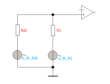

If you comprehend the true input of the system is v_catrridge, not amplifier input, it became not so crazy. It's noise, my friend, and even the sum of two uncorrelated noises is exactly equal to their difference !Unoise at the input of the system would then be inversely proportional to R2
And here is the paradox
R2 in Marcel's nomenclature is simply not a noise-current source of the ring (or the mesh), but both active (working) resistors are noise-voltage sources - and only these are correctly transformed into current source models, whose currents can then be geometrically added to a total current ..!
u_noise is now proportional to this current or also to the equivalent resistance (formed as Rdc||R1, in my nomenclature).
If Z(jOmega)= Rcart+jXcart were noise-free, then the Sukhov&Marcel-Story would be correct, but then you could also turn it around and consider R1 (or R2) as noise-free and
i_n = sqrt(4*T*k*df * Rdc)/Rdc ...
and so on.
and so on.

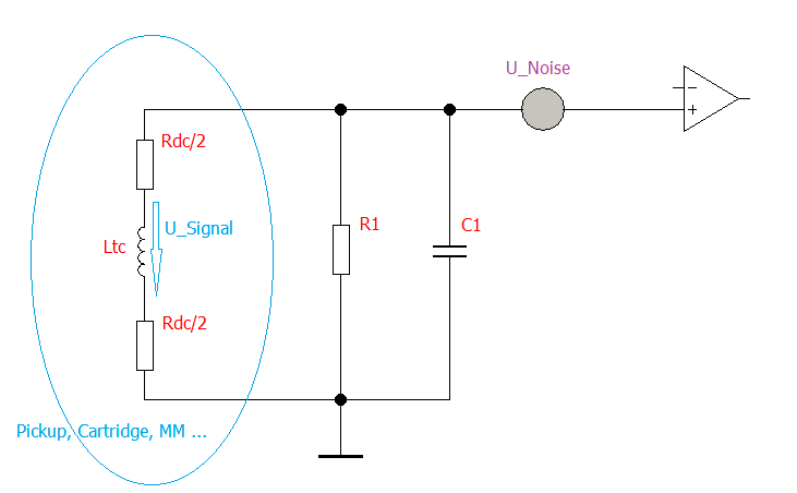

the transducer-coil is the SignalSource and all that follows is the AC impedance of the amplifier (the input). Rdc , the DC resistance of the coil wire is of course a component of the signal source (at the input of the amplifier).

Two uncorrelated noise voltage sources arithmetically added or subtracted would lead to the same random chaos, that's true. They are not phase-locked to each other.If you comprehend the true input of the system is v_catrridge, not amplifier input, it became not so crazy. It's noise, my friend, and even the sum of two uncorrelated noises is exactly equal to their difference !![]()
If we want to consider the ideal voltage source V_cart, which in reality does not exist, as the ultimate input of the entire system - whether this is permissible is still up in the air - then we must of course move (all) the (noise) sources to the far left.

The key point, however, is that we need to shift (let's just say bundle) the equivalent total (voltage) noise to the input of the operational amplifier.
When will the knot of this paradox finally be untied?
HBt.

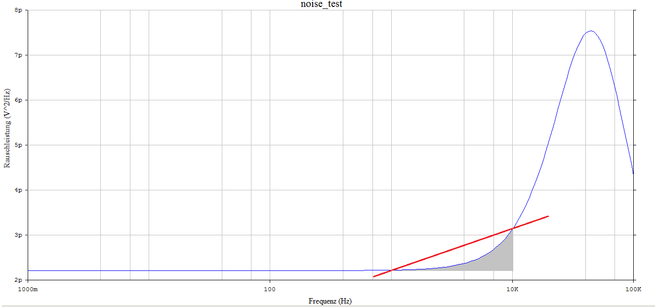

Note:
The OP is currently considered noise-free, so the gray area represents the "resulting thermal (voltage) noise" of the pickup plus cable plus termination.

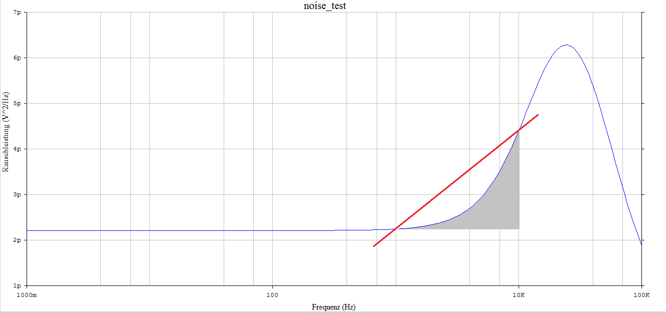

Note:

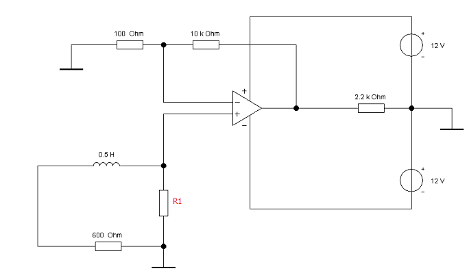

transferring noise sources from one place to another requires additional recalculations according to Kirchhoff's and Ohm's rules; in my opinion, it is much simpler, faster and more error-free to assign these operations to a circuit simulatorthen we must of course move (all) the (noise) sources to the far left
If we consider the operational amplifier as ideal, i.e. completely noise-free, and the larger of the two thermally noisy resistors as the drive (in the ring), i.e. a current source, and the much smaller resistor as a voltage source with (noise-free) internal resistance, then Nick&Marcel's assumption is correct.
But:
This is the common (and correct?) consideration of the simple relationships at the input of the amplifier, both noise voltages...
But:
That's all true, Nick.transferring noise sources from one place to another requires additional recalculations according to Kirchhoff's and Ohm's rules; in my opinion, it is much simpler, faster and more error-free to assign these operations to a circuit simulator
Yes, a simulator, and especially the MC-12, is great.
Still, for a basic understanding, the rocky road is the best, the one with the later, very steep learning curve.
The weighting factors are really not that trivial to determine; source shifting is very abstract. But, You can find them in textbooks that deal precisely with this topic. Okay, I admit, this model world is something for academics.

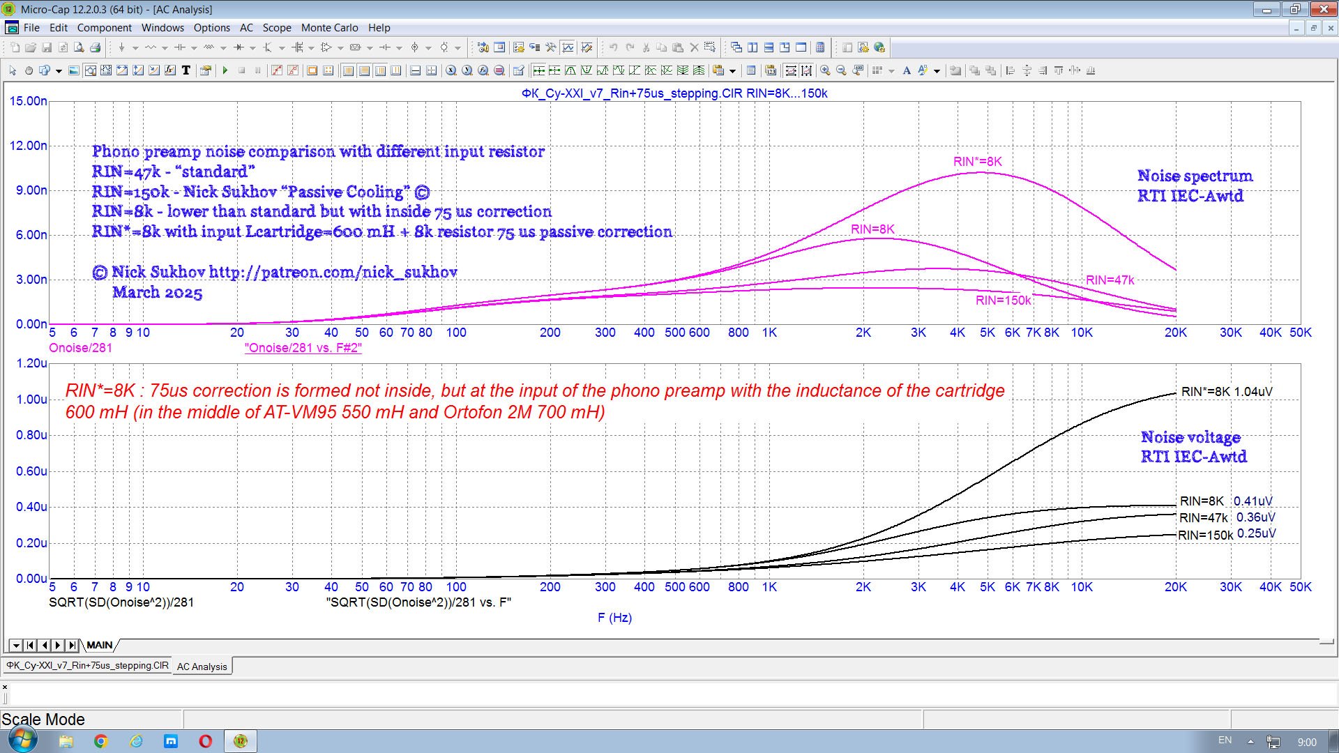

The simplest thing would be a comparative measurement, not a comparison of a digitized LP playback! So we need Pavel's help: he can increase the termination to 150k in his test setup (OpenPhonoOne - of course, C1 must be removed and the MM cartridge (magnetically shielded) must be connected directly, without a cable).
- Analogue Source
- Quick comparison -> OP-Amp Noise -> Simplified calculation
