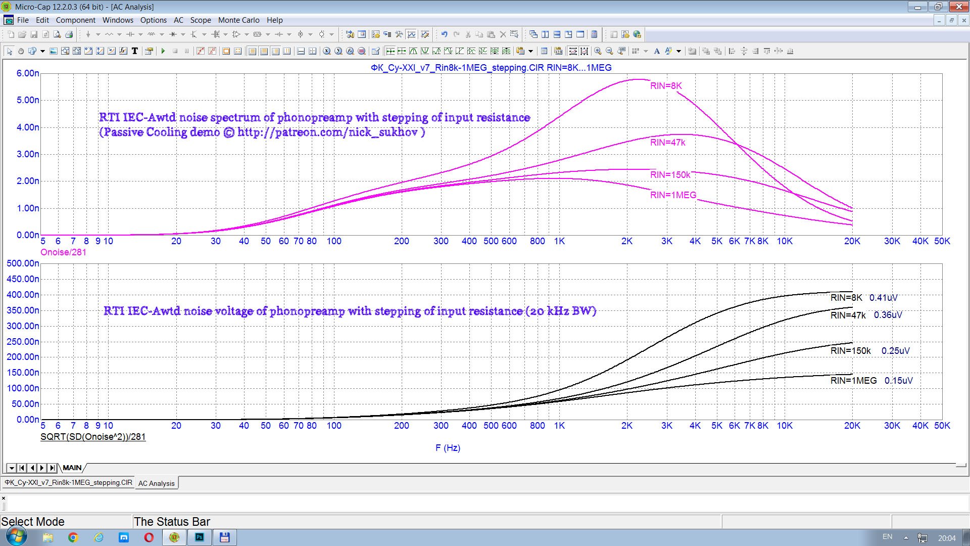

Quick comparison -> OP-Amp Noise -> Simplified calculation
Now we want to find out very quickly whether there is actually a gain between the termination with 150kOhm compared to the standard 47kOhm - and ask noise_1_3.exe for advice. The OPA627 serves as our DUT.

Nevertheless, a 150kOhm resistor produces more thermal noise than a 47kOhm resistor, the trick is hidden somewhere else.
With the usual (and often in different places simplifying) methods, both cases perform almost equally, or show clearly that the total equivalent noise voltage must of course be somewhat lower with the 47k resistor. However, they do not take into account the influence of the voltage divider at the input on the final SNR. The whole trick is the voltage divider, nothing more. If you only look at the noise, the pendulum always swings to the side of the lower impedance termination, never the other way around.
This physical state of affairs cannot please Nick S., even though his EQ is great - the advertising must not now claim that the higher impedance termination leads to less noise.
HBt.
Erm, no, it generates more voltage noise, but less current noise, and into a matched load all resistances at a given temperature produce the same noise power, otherwise thermodynamics doesn't work!
The circuit topology matters.

The winner in the SNR game is Nick's 150k termination ("passively cooled").

I think a common issue seen is current noise often being completely ignored, with the assumption that there is only voltage noise.
Understanding that there is current noise (more generally that there is a noise impedance associated with a device), is useful to avoid pitfalls such as thinking a MM cartridge preamp using an AD797 is a good choice.
So I see remarks like "150k noisier than 47k" as examples of this confusion and jump in to clarify that its a bit more complicated than that...
The truth is that sometimes you can ignore current noise, but also sometimes you can ignore voltage noise, and sometimes both matter.
And there's also 1/f noise to worry about too sometimes.

There is no point doing calculations assuming 150k Input Z instead of the 'standard' 47k cos no MM cartridge maker designs their MM cartridges to have flat response with 150k
True, but @Nick Sukhov found out that many of them have a pretty good response, actually better than with the specified load, with 150 kohm when you keep the load capacitance very low. A consequence is that the phono amplifier has to be built into the turntable.
So my entry for Single number RIAA noise calculation / simulation is
  1. First find out the correct method
  2. Simulate noise using LTspice to give nV/rt(Hz)
  3. Weight the noise
  4. Sum the weighted noise Equivalent to using an RMS meter..
you can do all 4 of your points with one mouse movement in Microcap, with the same reliable result. See my attachment. Replace LTSpice with MC12 [ free here https://www.patreon.com/posts/podstrakhoval-12-84096514 - zip installer only 17 MB ] and you will save a lot of time.
Reactions: kgrlee and hbtaudio
