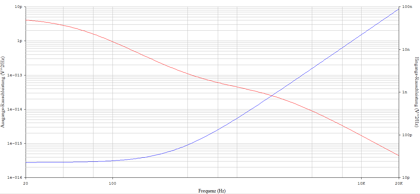

What we do not want is an RMS power spectrum that increases with increasing frequency as y in the x direction.

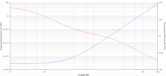

A noise voltage behavior that increases with frequency is what we want to avoid at all costs. We don't want an unpleasant, sharp-sounding noise with a lot of energy in the upper octaves.
(...) from the curves Mark posted in #9, I don't think a single figure ITU-468 ranking will differ much from what you'd decide by looking at the curves ... which you have to generate anyway to get the ITU-468 number.
We all opt for the OP of the black curve.

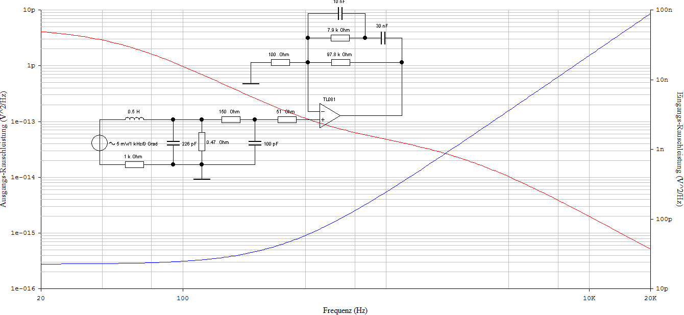

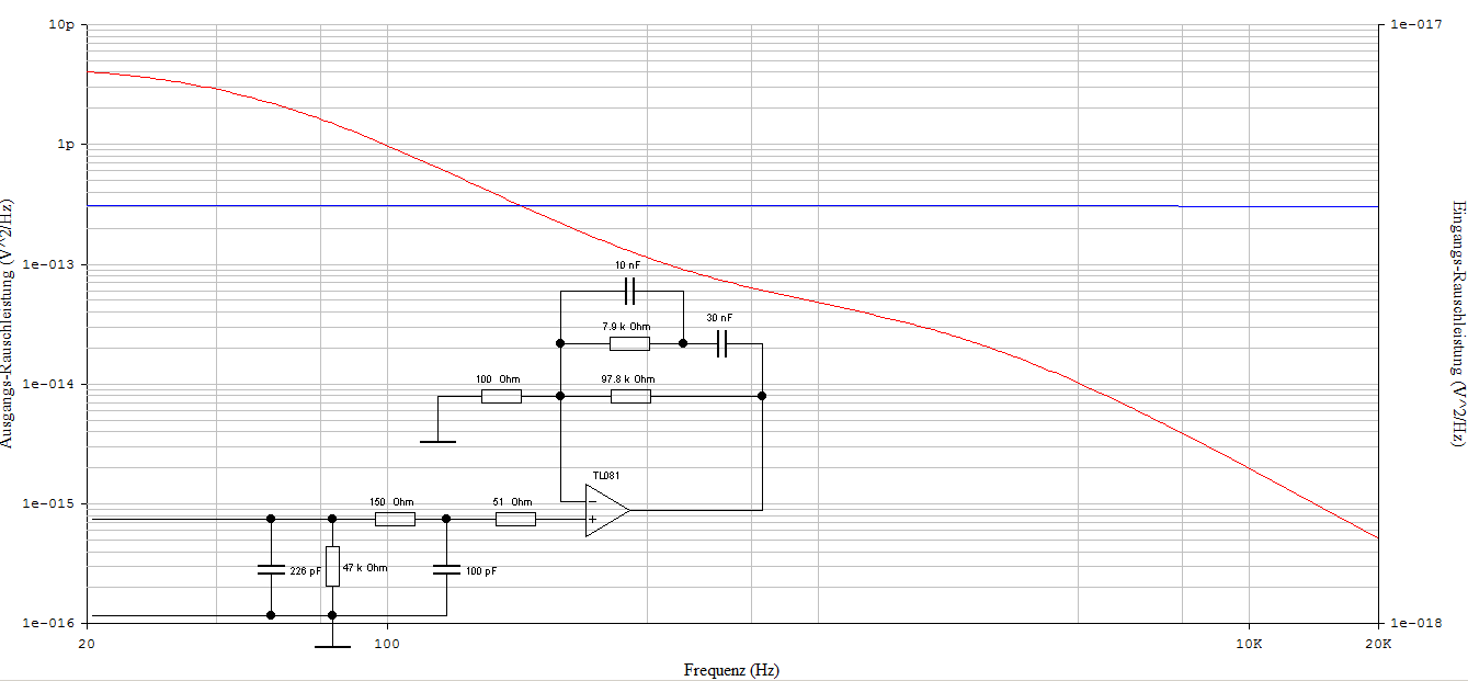

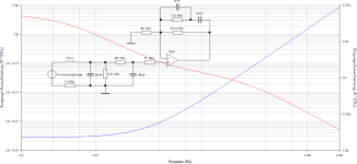

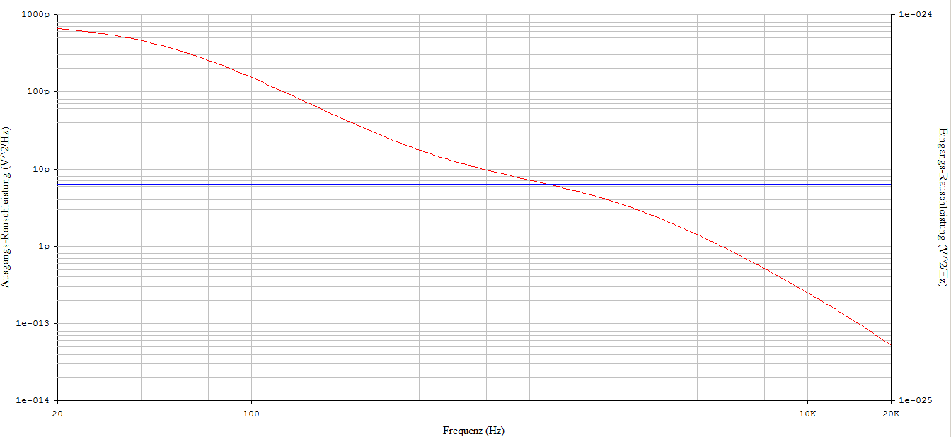

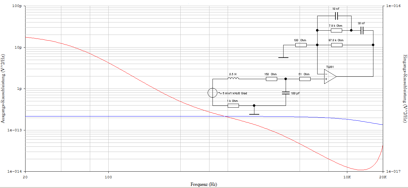

A picture says more than a thousand words, please take a close look at the red curve.

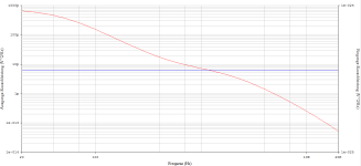

Another comparison can also be made, namely between a hypothetical SNR determination with an open input and with a shorted input, at full bandwidth and the maximum gain by weighting with the RIAA low-pass filter, related to a tone with a frequency of 1kHz.
Then you can already see between which limits (here a TL081, as noiseless device) a maximum characteristic value (here the SNR, Uout nominally 500mVrms) with a connected MM system can theoretically move. These limits shift almost equally and simultaneously upwards or downwards, in the first simple approximation, depending on the op-amp used.
In other words, the subjectively perceived loudness of the (white) noise is only half as disturbing and is masked during operation, i.e. when playing a record. Thank goodness we color the noise and now it is far more than a quarter as loud, even less disturbing due to the loudness ratings of our hearing apparatus.
And so on and so forth ...

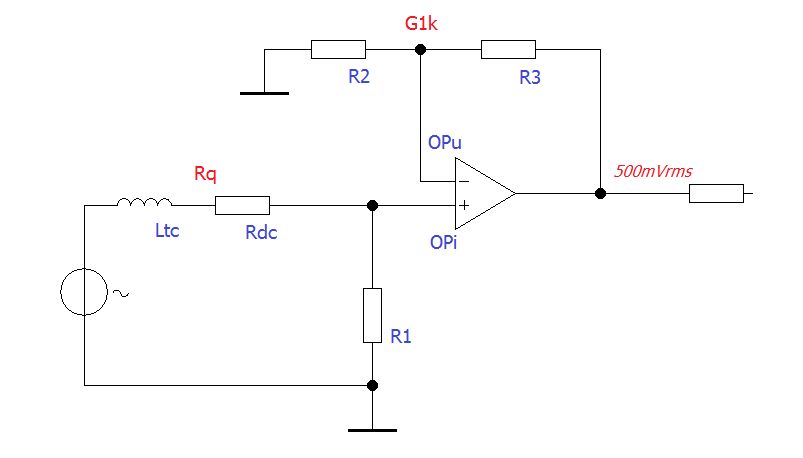

I think, slowly but surely, no reader can really follow the red thread anymore, because he does not know it yet and has forgotten that we (EEs) do not have to use absolute level measures, but that we very often use relations, i.e. ratios ... and declare them to be the measure of all things. In plain language, this means that it is relative and not absolute. But the comparison is absolute within the staking out (the agreement and the reference there).
The last value within the third output line is decisive, because only it takes into account all weighting factors and shifts all sources correctly. The usual, i.e. all other simplifications (of technical articles, textbooks) are inadequate ... as is usually confirmed by measurements in reality.
My personal thanks go directly to Pavel M., whose recent interventions on the subject ( @PMA ) have provided metrological proof - completely unintentionally. Often we are not aware of what we are triggering.
The correct weight factors result in (I won't reveal any more) :
A0=1
A1=( Rq/R1)^2
A2=((R1+Rq)/R1)^2
A3=(R2/(R2+R3))^2

If we look at the entire circuit diagram and also take into account the influence of the nfb, a completely different picture of the ranking list emerges:

Now the "rudimentary calculator" (because that's all it is) looks like this:
OPu=
OPi=
G1k=
Rq=
Ltc=
Rdc=
R1=
R2=
R3=
df=
T=
99.0099 7500 3112.292 10000 100 3333 47000
2.234235e-007[V] 2.256577e-005[V] 86.3153[dB]
4.939737e-007[V] 4.989135e-005[V] 79.4238[dB]
short 1.749524e-005[V] 89.121[dB]
open 0.0001110145[V] 73.07181[dB]
infinite 1.914475e-005[V] 88.3384[dB] Riq= 3333[Ohm]
reference: 0.4668905[V] 4.598169e-005[V] 80.1326[dB]
reference: 0.4668905[V] 0.0001852986[V] 68.02686[dB]
543.4783[V/A] 3.000000024113862e-009[V/sqrt(Hz)]
9.661835019487091e-006[A/V] 3.999999842123142e-013[A/sqrt(Hz)]
45.59516394204096[dB] 103500[Ohm]
