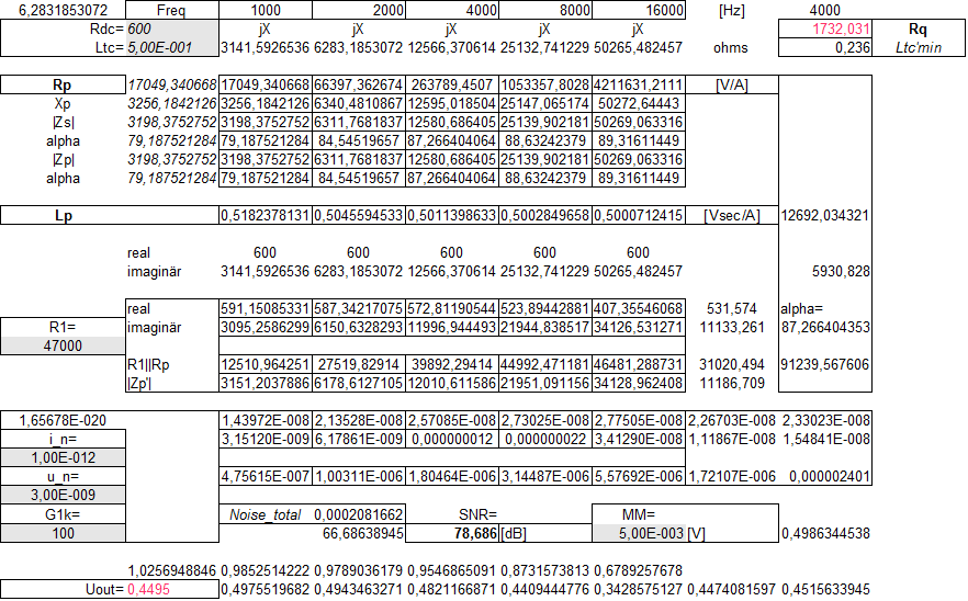

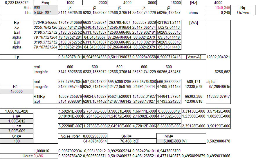

Now here is a spreadsheet, it confirms what we all know 150k is greater than 47k and therefore his rushing contribution is also, in the first instance, higher.(...) or even a spreadsheet, then it would run on other OS's.
But, a calculation of this kind still neglects three points - later I will submit a complete calculation, which takes into account the influence of the complex voltage division at both inputs, related to all variables to be considered.
Among other things, Cp and the RIAA network are still missing in the negative feedback branch, as well as the +1 error.

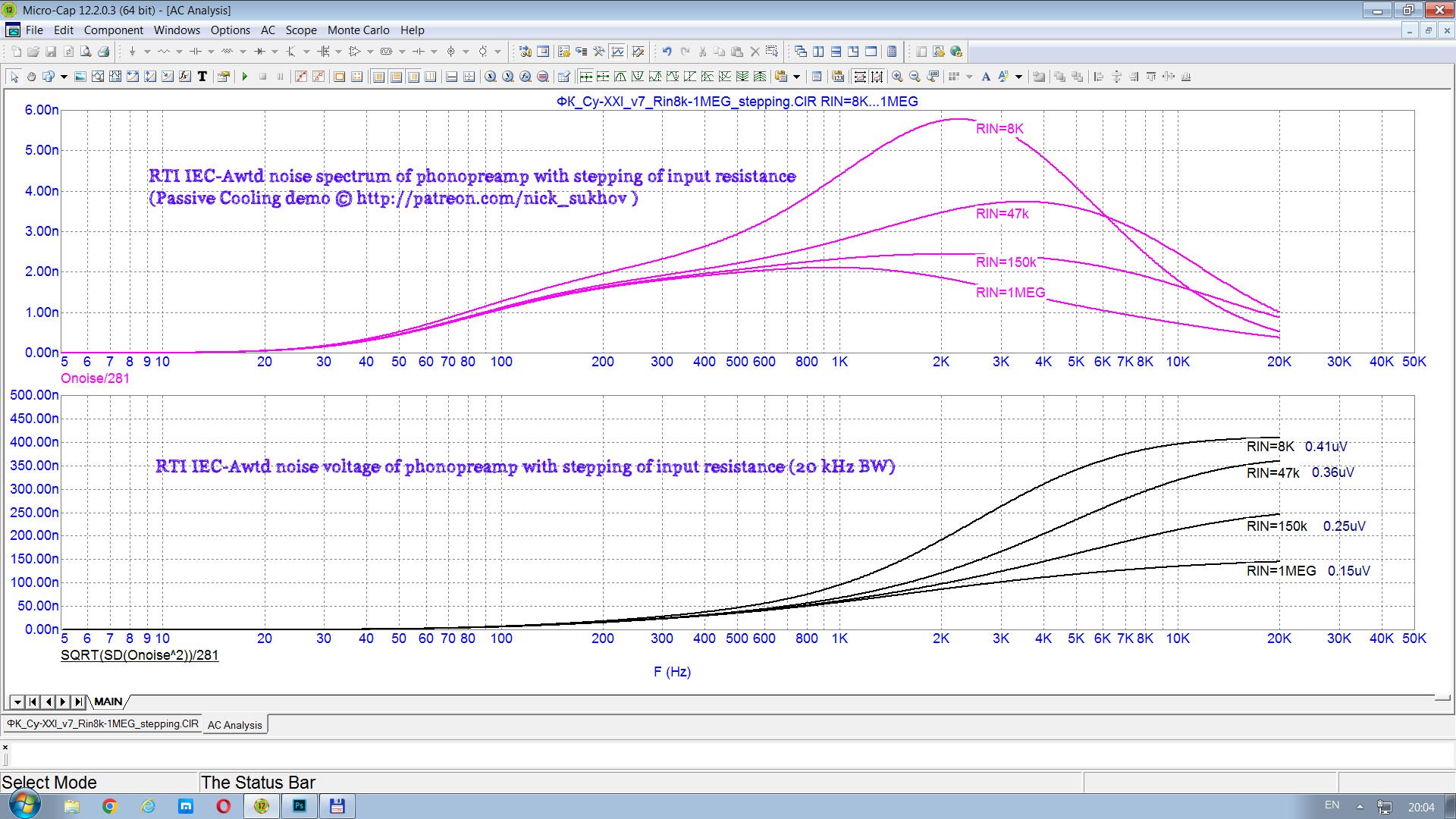

Wrong. see attached file. You must keep in mind cartridge inductane @ input + RIAA + A(or ITU-R)weightingwe all know 150k is greater than 47k and therefore his rushing contribution is also, in the first instance, higher.
Please don't get me wrong Nick S.,Wrong. see attached file. You must keep in mind cartridge inductane @ input + RIAA + A(or ITU-R)weighting

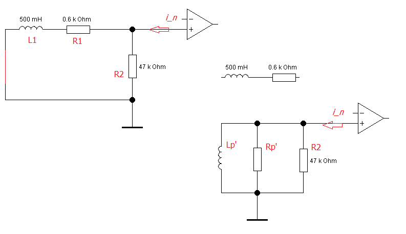

under no circumstances do I want to start the old dispute all over again. I'm only interested in the discovery process, in untying the knot. The node consists of the fact that the thermal noise, the average amount we consider and name as equivalent noise voltage: ((4*K*T*BW) * R)^0.5 and this part is definitely getting bigger!

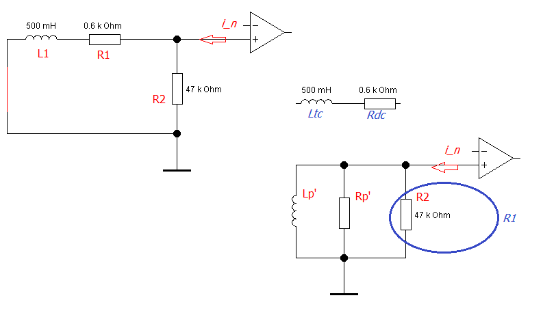

The node consist of not naked input resistor 150k or 47k but with attached @ input of phonopreamp cartridge with average standardized inductance of 500 mH. It has much lower inpedance vs both of 150k or 47k, then cartridge shunts input resistor (the lower freq, the bigger shunting) with his noise current ((4*K*T*BW) /R)^0.5. After that you have RIAA with +20dB @ 20 Hz and -20dB @ 20kHz, and in the end a IEC-A weighting with -50dB @20hz and -10dB @20kHz. The noise voltage at the output of the phono preamplifier must be divided by its gain at 1 kHz to obtain the input-referred noise level (RTI). Without all of the above elements, discussions about bare resistor noise are completely meaningless.The node consists of the fact that the thermal noise, the average amount we consider and name as equivalent noise voltage: ((4*K*T*BW) * R)^0.5 and this part is definitely getting bigger!

If I assume that MC-12 presents us with a correct result at the end of the entire evaluation /schematic, or if you, Nick, as a human, present a manual calculation that also confirms the result, then the fundamental error lies in the general transformation of the equivalent two-terminal-pole at the positive input of our operational amplifier.
And that's exactly where it lies; but it's somehow very difficult to grasp because it seems illogical.
To unravel the knot, it would certainly be helpful if you explained the necessary transformations in detail. Preferably in handwriting, as Marcel often does, and then posted the image or PDF file here.

Yes Nick S.The node consist of not naked input resistor 150k or 47k but with attached @ input of phonopreamp cartridge with average standardized inductance of 500 mH. It has much lower inpedance vs both of 150k or 47k, then cartridge shunts input resistor (the lower freq, the bigger shinting) with his noise current ((4*K*T*BW) /R)^0.5. After that you have RIAA with +20dB @ 20 Hz and -20dB @ 20kHz, and in the end a IEC-A weighting with -50dB @20hz and -10dB @20kHz. The noise voltage at the output of the phono preamplifier must be divided by its gain at 1 kHz to obtain the input-referred noise level (RTI). Without all of the above elements, discussions about bare resistor noise are completely meaningless.
I completely agree with you. My spreadsheet program takes these points into account (except for IEC-A).
Let's unravel the knot (in our /my heads) with a concrete, hands-on example. Paper and pencil.
Please don't be angry at /with me. I'm not insisting on this out of silly joy, but rather I'd like to see a method of calculation, like the ones we used to do in school or university. Just a few months ago, I heard on campus again that students need numerical examples for better understanding. In other words, calculation examples. The lectures and scripts alone weren't enough for them.here it is in #71

Exactly.Without all of the above elements, discussions about bare resistor noise are completely meaningless.

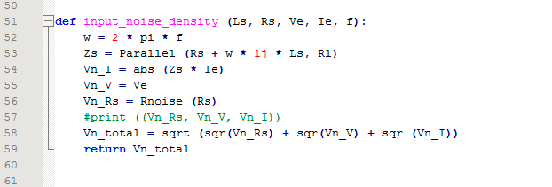

Do you think Mark's algorithm is correct? Please take a detailed look at the source code.

I don't work with Python, but I regularly have to be able to read sources from students.
To avoid possible (further) confusion, this little picture now shows that I use the blue nomenclature in my spreadsheet. R1 is the termination of the system. Rq (i.e. a purely resistive replacement component) is not used here, the SSheet is not the win32 program noise.exe.

The correct calculations consider each resistive noise source separately and figure out its contribution at each node in the circuit as either a Thevenin or Norton source, then use superposition to combine them all at nodes you are interested in (which for noise is calculated using root-sum-squared for separate, uncorrelated noise sources). Its a bit more cumbersome - LTSpice can do the work for you...
The code is doing the standard 3-part calculation, device voltage noise Vn_V, device current noise reflected into the input impedance Vn_I, and source resistance noise Vn_Rs. Since these are uncorrelated they root-sum-square to the result
