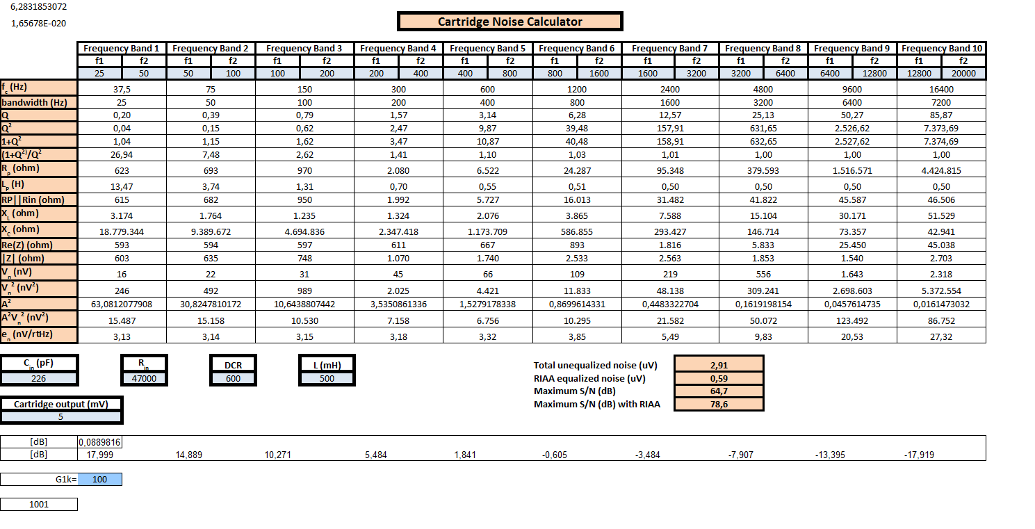

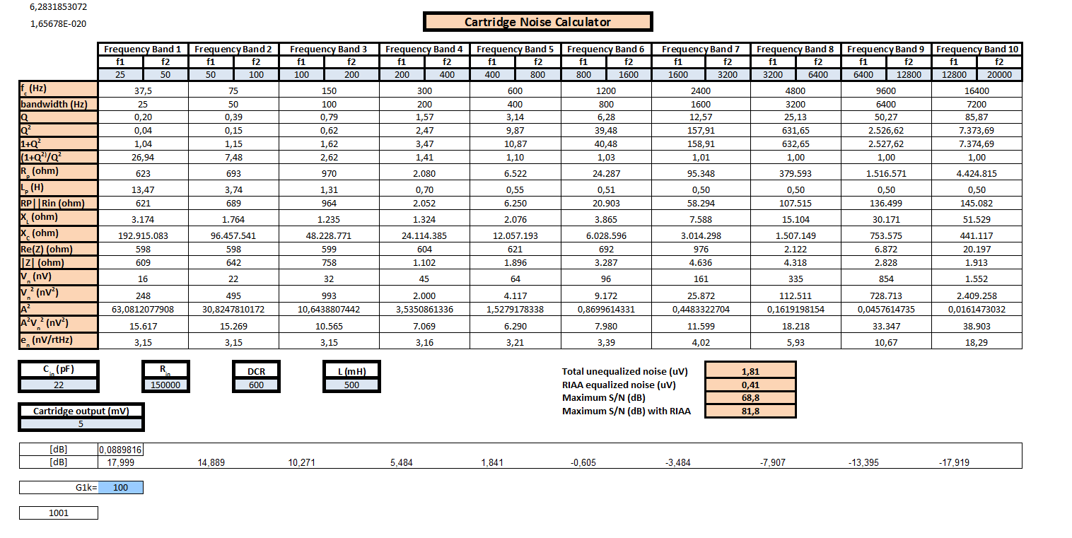

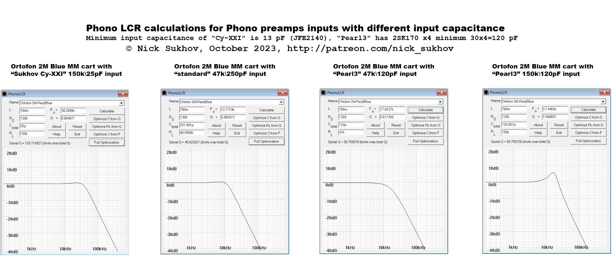

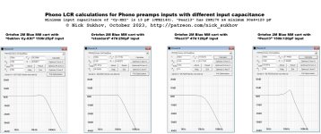

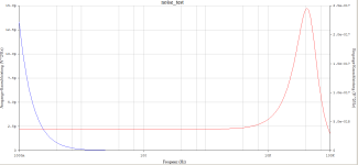

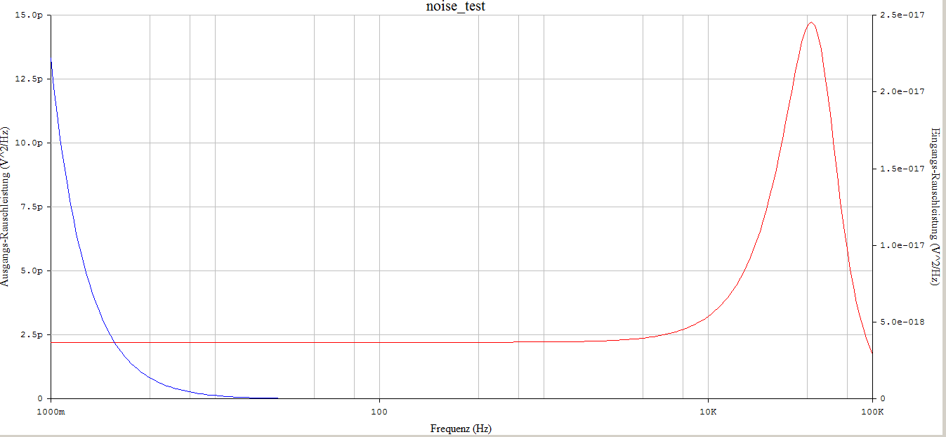

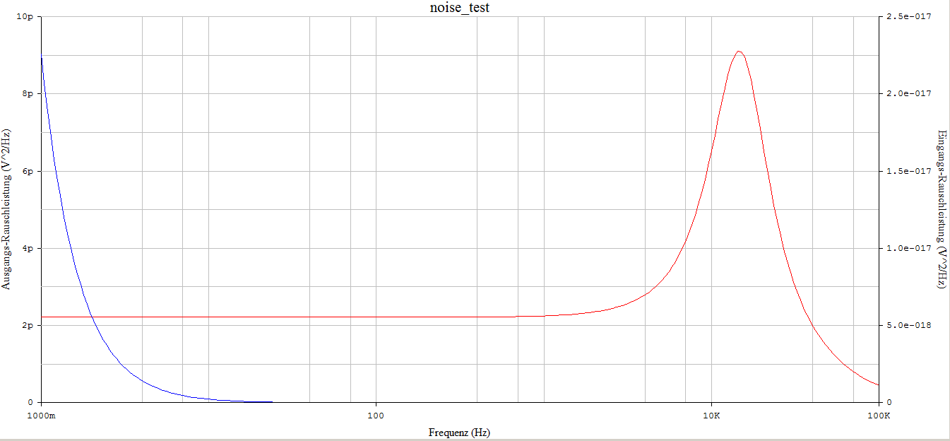

Quick comparison -> OP-Amp Noise -> Simplified calculation
shifted to the coil as signal-current-source ..!
with Cp, now there is a huge advantage in the upper frequencyrange till 10kHz.

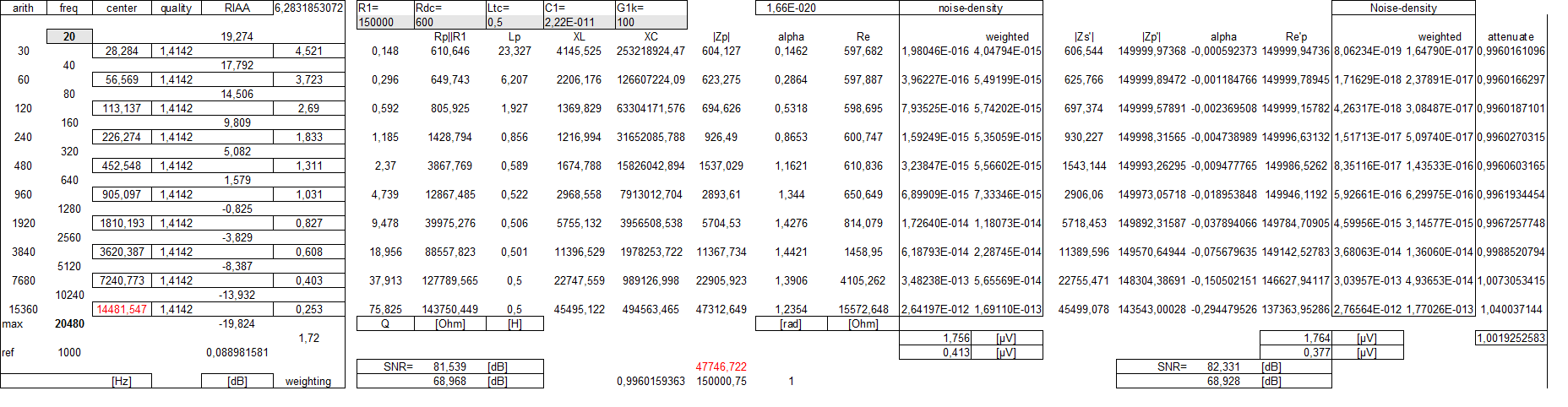

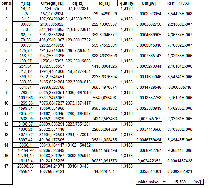

If you need the spreadsheet, here it is in *.ods format. The original is from @SY, I just edited it a bit ..!
fc = sqrt(fh*fl)
and
not
fc=(fh+fl)/2
it is actually the geometric mean and not the arithmetic mean, whether this is of elementary importance for the entire approximation (because it is not anything other than an approximation) remains to be questioned.
HBt.
Psst
The Uth^2 in the bands is added up, formed from 4*T*k*BW_n * Re(Zp(jOmega_n)). That is a very interesting point, because the real part of the complex equivalent parallel resonant circuit is used as a very simple equivalent of the much more difficult to understand relationship with the correct thermal noise current - in conjunction with the magnetic pickup.

The comparison of methods provides interesting insights. In the left part of the table, the quasi-equivalent band noise of the real part of an equivalent (RCL-parallel-equivalent) circuit is approximated and in the right part the more complex Sukhov-Gefel-Method is applied.

Long story short:
It is now fair to assume that an SNR value of 79dB (81dB) will never be achieved. It gets worse with the inherent noise of the connected RIAA preamplifier and especially its i_n.
If we are looking for the best possible SN distance, we have to fall back on Nick's method. The preamp belongs in the chassis, directly at the end of the tonearm cabling.
But, and this is (very) confusing, nowhere in the technical literature (that I know of) is Nick's or Marcel's calculation approach presented - but the termination with 150k compared to 47k should theoretically show a gain of somewhere between +5dB and +10dB. The two example calculations show a gain of between 4.814dB and 7.307dB. Whether my RIAA low pass center of gravity weighting is correct (for equivalent bands), I do not know. Since we can solve everything numerically much more elegantly than with a 10 keypoints spreadsheet - I like an approximation in the form "over the thumb" better: 69dB + 12dB(RIAA gain) = 81dB limit.
HBt.

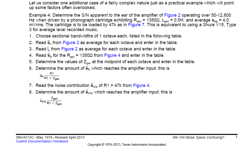

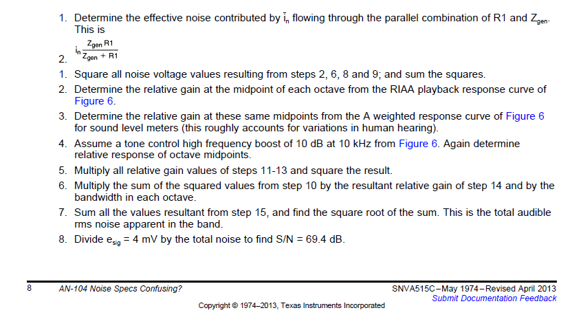

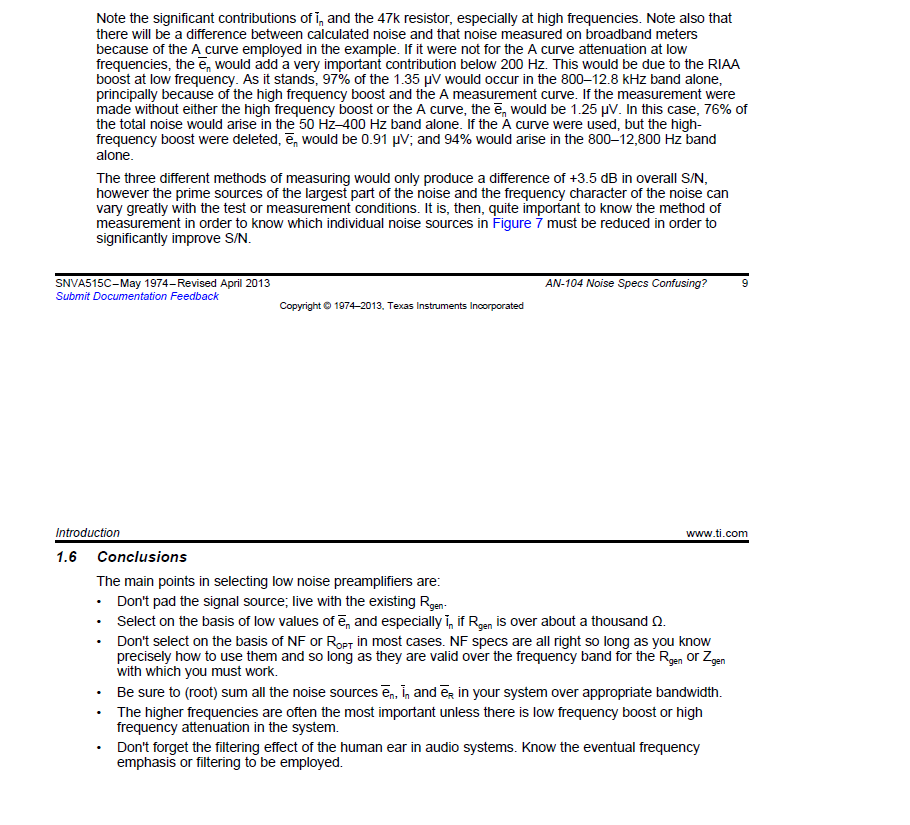

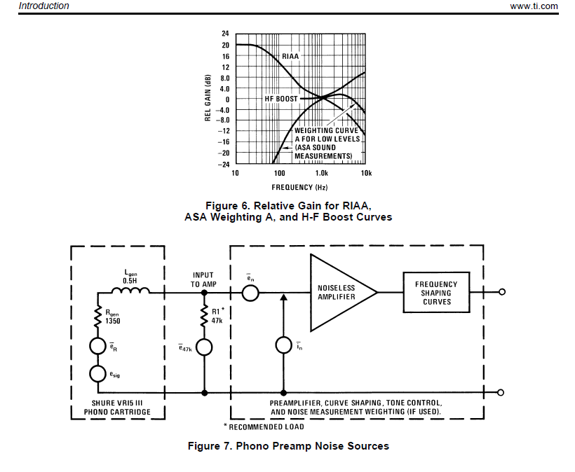

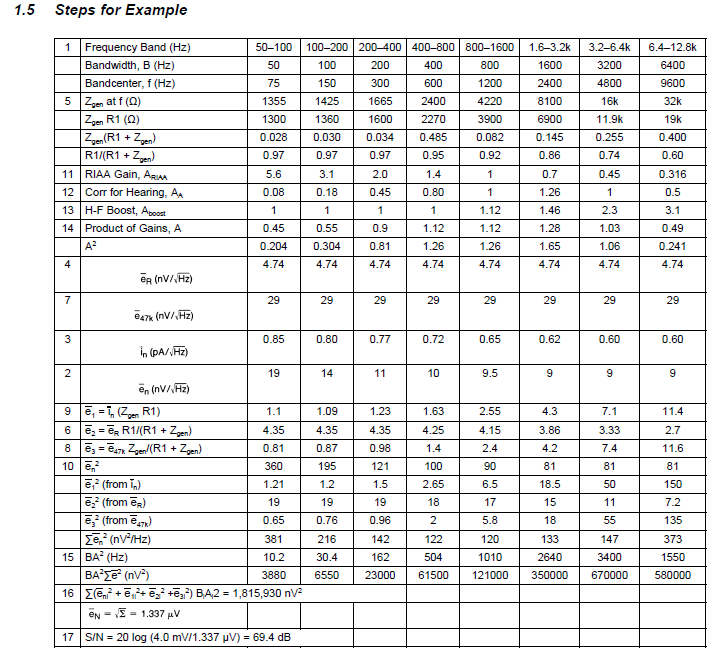

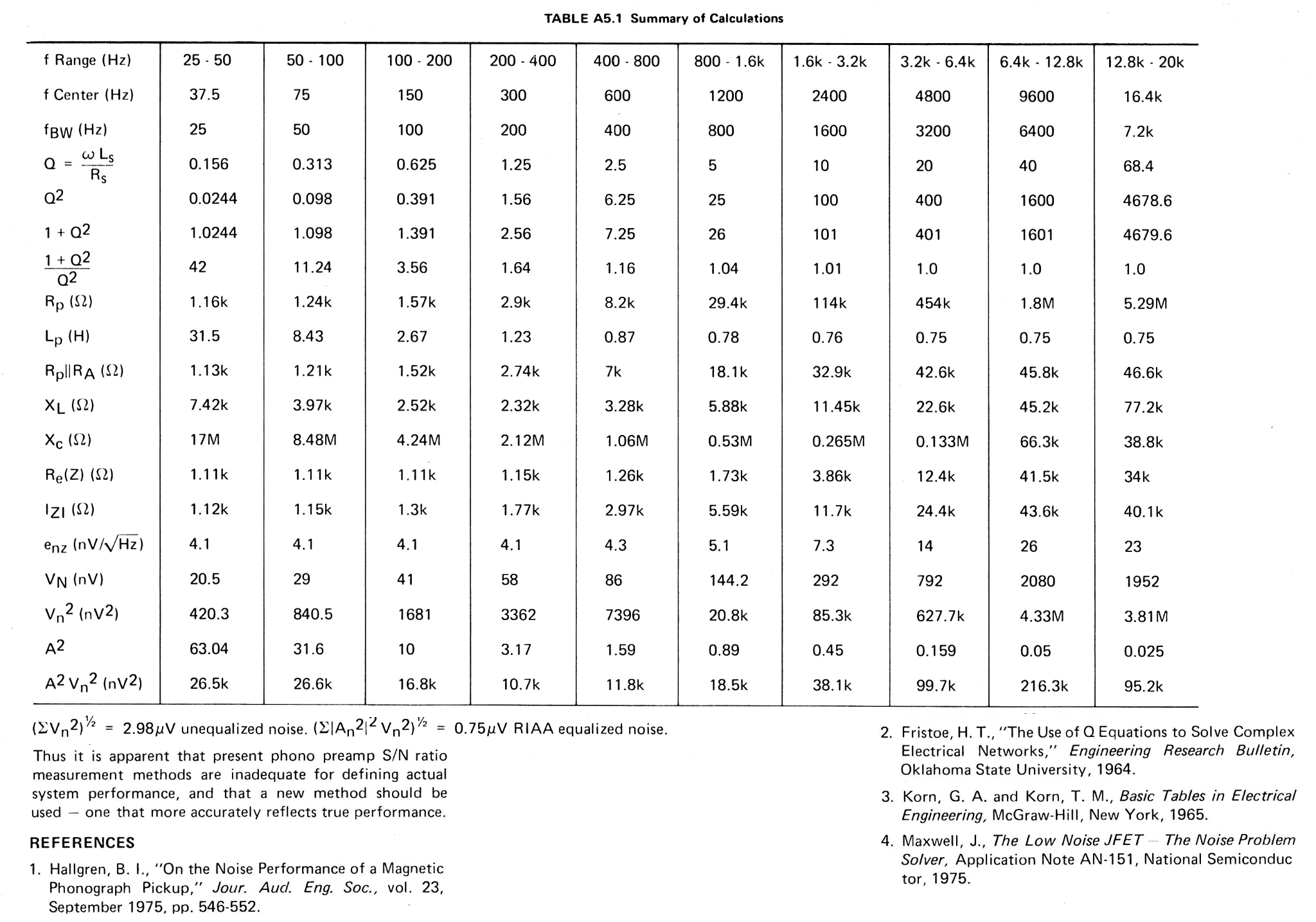

Anyone have the 2 makers datasheets which show the precise calculation of RIAA preamp noise spectrum? They were precise & easy to understand. I think we found both papers in Wayne Kirkwood's thread on his website. My single remaining brain cell dun unnerstan htbaudio's calculations.
The important bit in each frequency band IIRC, is transforming the Complex Impedance of the cartridge (which includes the 47k & any capacitance) into an equivalent noise series resistance and a series inductance.
I might be wrong as I last did such hard sums in da previous Millenium
Reactions: hbtaudio
The National Semiconductor note is AN 104 https://www.ti.com/lit/an/snva515c/snva515c.pdf see sections 1.4 & 1.5 IIRC, the AD note was an early OP27 datasheet.
It came about from a discussion on Wayne Kirkwood's site https://www.proaudiodesignforum.com/forum/php/viewtopic.php?t=423&hilit=ricardo+riaa&start=10
There's links to NJM 2068 tests and loadsa Real Life noise measurements with various MM cartridges & OPAs.
Many memories from the time when my single remaining brain cell had enough shelf life to pose as a pseudo guru even with the likes of Gurus Wurcer, Wayne & John Roberts present 😊
I'm surprised that 10 yrs on, 5532/4 is STILL one of the best for RIAA MM ... only beaten slightly by a few HUGELY $$$ FET OPAs like OPA 627 and Unobtainium stuff like NJM 2068
In theory, any FET i/p OPA with env < 3nV/rt(Hz) & low 1/f, popcorn bla bla noise should trash 5534AN with a real MM cartridge.
I now have enough info to redo my own version of AN 104 to get a "single noise number" using CCIR 468 2kHz instead of EVIL A wt ... but don't hold your breath waiting cos there's loadsa beach bum issues in the way.
Reactions: hbtaudio
It can only ever be the real part of a complex impedance/ resistance (not reactance). Either you carry out the transformation mentioned by Marcel and Nick, or you work with an equivalent, parallel two-pole.
These (generally valid) points always amaze me too, because they clearly show that no real development in a further positive direction has taken place.
Bear in mind that I am not a fan of the rating /weighting filters either.
