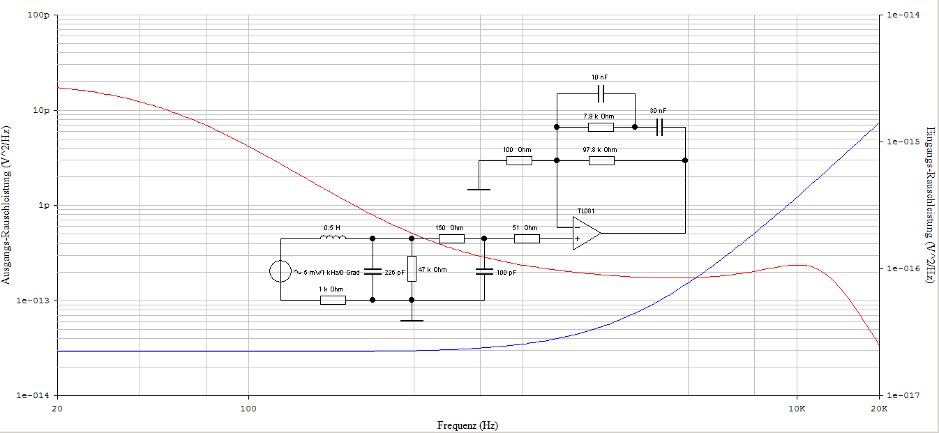

Quick comparison -> OP-Amp Noise -> Simplified calculation
The recent disputes regarding the lowest-noise operational amplifier, mainly as a single-stage phono EQ, have prompted me to ask:
how can I get a concrete reference point as quickly as possible, comparing individual types of OP?
Whether absolute values are generated is irrelevant, it is the comparison that is of interest. The type with the highest SNR wins.
SCHEMATIC
The win32 program noise.exe opens a cmd and presents itself as follows:
OPu=
OPi=
G1k=
Rq=
Ltc=
Rdc=
R1=
R2=
R3=
df=
T=
1.730631e-007[V] 1.747937e-005[V] 88.53378[dB]
99.0099 7500 3112.292 10000 100 3333 47000
OPu=
C:\Windows\System32>
enter as a normal floating point variable or confirm with the enter key, the rest will become clear as you play.
  • OPu stands for en in V/sqrt(Hz) and OPi stands for In in A/sqrt(Hz) of the operational amplifier used
  • Rq stands for the resulting effective resistance of our pickup, alternatively a DC resistance (in ohms) and a coil inductance (in H) can be specified
  • df stands for the desired bandwidth of our thermal noise (in Hz)
  • T for the temperature (in °C) ...
If you assign a value to OPu after the first run, the input starts from the beginning (you can simply confirm (the stored default values) with the enter key).
Have fun with it - and of course I cannot guarantee correctness and correct operation.
However,
the theoretical calculation of the noise, manifested here in the SNR (last output value of the first line), is actually trivial.
Nevertheless,
I could have made a dozen mistakes.
HBt.

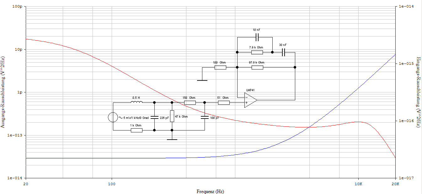

4)
LM741 -18.5dB
OPu=20e-9
OPi=0.3e-12
6.775719e-008[V] 6.843477e-006[V] 96.67876[dB]
99.0099 66666.67 3112.292 10000 100 3333 47000

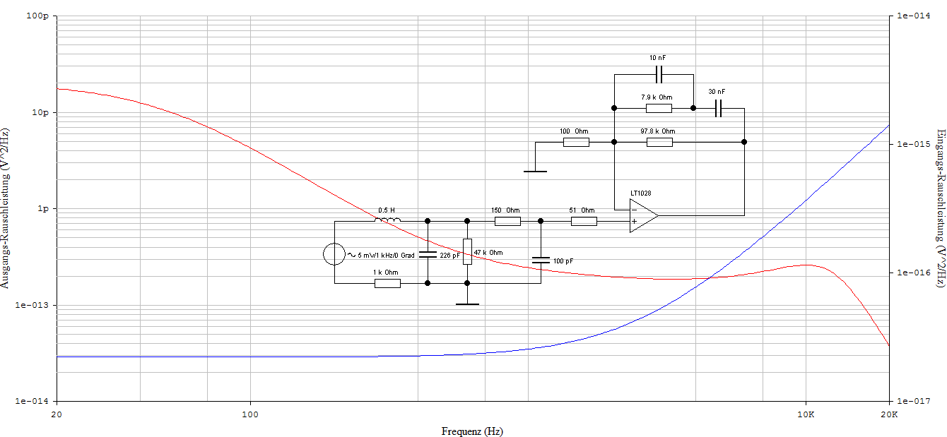

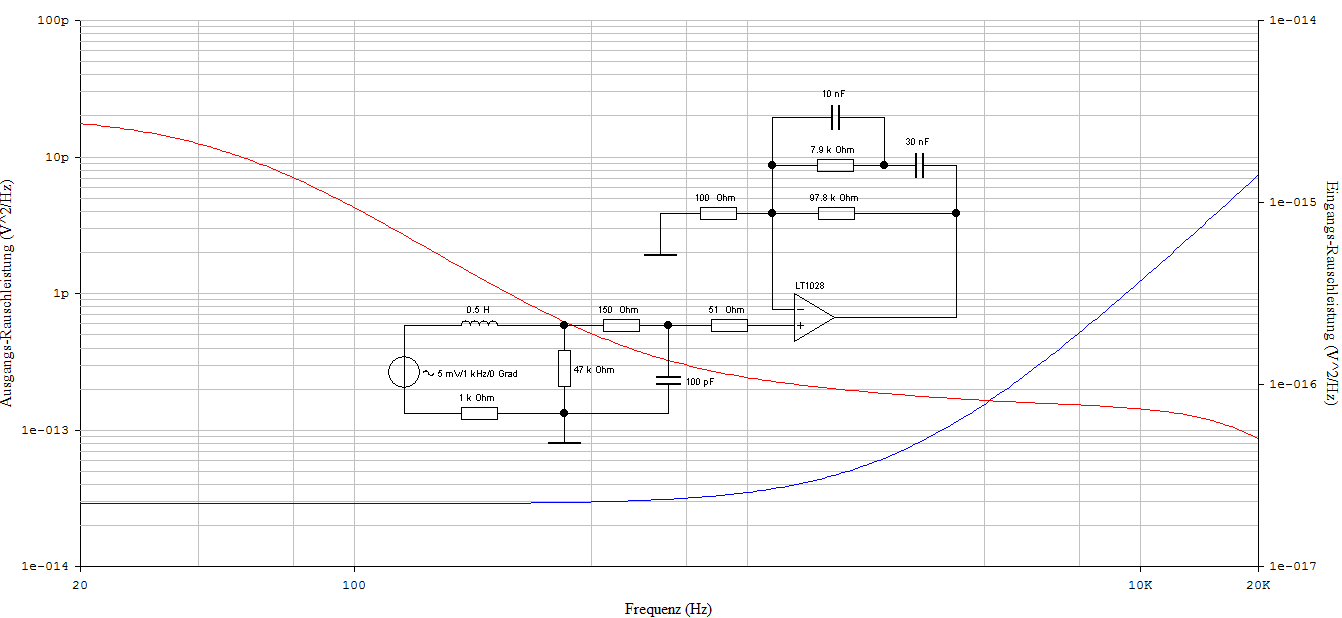

LT1028
OPu=0.85e-9
OPi=1e-12
G1k=100
Rq=10
Ltc=
Rdc=
R1=47000
R2=10
R3=
df=
T=
1.950825e-009[V] 1.970334e-007[V] 128.0868[dB]
9.90099 850 9.997872 1000 10 10 47000

OPA627 in PMA's OpenAmpOne
OPu=8e-9
OPi=1.6e-15
G1k=
Rq=
Ltc=
Rdc=
R1=
R2=
R3=
df=20000
T=
2.532218e-008[V] 2.55754e-006[V] 105.2279[dB]
99.0099 5000000 3112.292 10000 100 3333 47000
1.639439e-006[V] 0.0001655833[V] 69.00397[dB]
OPu=8e-9
OPi=1.6e-15
G1k=
Rq=
Ltc=
Rdc=
R1=
R2=
R3=
df=2000
T=
8.007577e-009[V] 8.087653e-007[V] 115.2279[dB]
5.184361e-007[V] 5.236204e-005[V] 79.00397[dB]
... with good correspondence to the measured SNR.

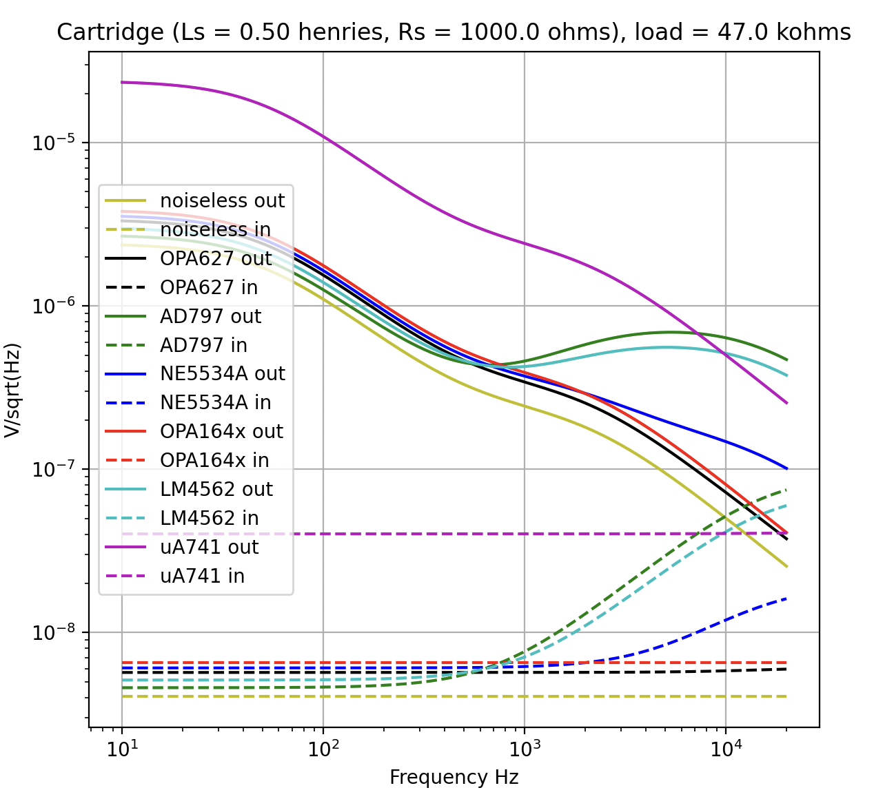

But you haven't provided the source code so we have no idea if you've done the right calculation! Why not use something portable too, like Python or even a spreadsheet, then it would run on other OS's.
Reactions: hbtaudio
Thermal noise only, band-limited to 2kHz:
2kHz? Why? And its not thermal noise only is it as the device current and voltage noise must be in there or what's the point?
Also if you are modelling the inductance of the cartridge you are interested in the frequency distribution of the noise, if so then surely it makes sense to model the RIAA network which also contributes to the noise frequency distribution?
Had a play at a Python noise plotting function, source provided...
Setup a few noise models for opamps, graph results:
The variation in voltage noise is fairly small except for the glaring exception of the uA741 (!), but the current noise contributions are very different - just look at the massive improvement of switching to NE5534A from LM4562, two bipolar opamps, and the fact the FET opamps are free from the HF bump.
I plotted both input and output referred noise densities, with an assumption of 60-fold gain at 1kHz (35.56dB).
In practice the higher frequency noise is the most audible (ears more sensitive, less competition from other sources), so the lesson is current noise is everything in a MM preamp, so long as you don't use a uA741...
Also I don't know of any bipolar opamp that beats the NE5534A for this application.
You're right, I hadn't really thought about these points. At the end of the project, or rather the trip, I might catch up on this.
I have expressed myself misleadingly, I also consider the currentnoise of the OP in both algorithms. In the first run, I transform back and forth so that I later have a simple network, a model that consists only of noisy voltage sources, so I break it down to thermal noise. The first approach is an alternative, intuitive approach, so to speak, while the second definitely delivers a correct result in the absolute sense.
"df" can be chosen freely, but a band limitation of the white noise to 1/(2PI75µsec) can be regarded as the simplest form of weighting.
The actual point is the development of an algorithm, i.e. a calculation method that directly allows an abstraction between a model concept and the circuitry of the op-amp, i.e. network theory.
I'm sure it sounds overly intellectual and therefore incomprehensible, I apologize. Basically, it only has a didactic background.
Both functions can be applied retroactively so that everything is weighted. In my opinion, however, this is unnecessary for comparative indications, or too much processing input. For didacticians (and methodologists), reduction is always the key to success, so you have enough reserves up your sleeve.
HBt.
ref #9
Hello Mark!
First of all, thank you for setting up a source as well. Great,
average density is
5e-9 V/sqrt(Hz)
for df=20k
this results in an SNR of 76.9dB

Results of noise_1_0.exe upper limits (which can never be achieved in practice)!
OPA627:
OPu=4e-9
OPi=48e-15
G1k=60
Rq=
Ltc=0.5
Rdc=1e3
R1=47e3
R2=168
R3=
df=2e3
T=27
6.025627e-008[V] 3.675632e-006[V] 102.0839[dB]
165.2459 83333.34 3080.806 10080 168 3296.915 47000
3.997795e-007[V] 2.438655e-005[V] 85.64752[dB]
AD797:
OPu=0.9e-9
OPi=2e-12
G1k=60
Rq=
Ltc=0.5
Rdc=1e3
R1=
R2=168
R3=
df=
T=
2.916356e-007[V] 1.778977e-005[V] 88.38712[dB]
165.2459 450 3080.806 10080 168 3296.915 47000
4.706507e-007[V] 2.870969e-005[V] 84.22996[dB]
NE5534A:
OPu=4.5e-9
OPi=0.4e-12
G1k=60
Rq=
Ltc=0.5
Rdc=1000
R1=
R2=168
R3=
T=
1.472599e-007[V] 8.982856e-006[V] 94.32224[dB]
165.2459 11250 3080.806 10080 168 3296.915 47000
4.163698e-007[V] 2.539856e-005[V] 85.29435[dB]
OPA164x:
OPu=5.1e-9
OPi=0.8e-15
G1k=60
Rq=
Ltc=0.5
Rdc=1000
R1=
R2=168
R3=
df=
T=
7.020351e-009[V] 4.282414e-007[V] 120.7568[dB]
165.2459 6375000 3080.806 10080 168 3296.915 47000
4.274287e-007[V] 2.607315e-005[V] 85.06666[dB]
LM4562:
OPu=2.7e-9
OPi=1.6e-12
G1k=60
Rq=
Ltc=0.5
Rdc=1000
R1=
R2=168
R3=
df=
T=
2.524234e-007[V] 1.539783e-005[V] 89.64134[dB]
165.2459 1687.5 3080.806 10080 168 3296.915 47000
4.490003e-007[V] 2.738901e-005[V] 84.639[dB]
µA741:
OPu=40e-9
OPi=0.16e-12
G1k=60
Rq=
Ltc=0.5
Rdc=1000
R1=
R2=168
R3=
df=
T=
3.523207e-008[V] 2.149156e-006[V] 106.7452[dB]
165.2459 250000 3080.806 10080 168 3296.915 47000
1.946388e-006[V] 0.0001187297[V] 71.89935[dB]

In da old days, we used to calculate noise spectrums for RIAA preamps & real MM cartridges in 1/3 8ve bands taking into account RIAA, effective series resistance bla bla in each band. IIRC, there were at least 2 OPA makers who showed this method in their datasheets, one of them being AD.
But I think your point is the most important one
There is no single number that tells you which OPA 'sounds' quietest. You need to look at the spectrum and listen to the noise.
IMHO, one of the reasons good MC cartridges 'sound better' than MM is that they don't have that 'HF bump' in their noise spectrums ... provided they get good matched LN amplification of course. 😊
This suggests a good MM cartridge with OPA627 preamp might come even closer to a good MC cartridge. I'd love to put this to a Blind Test. Difficult to do full DBLTs properly with different cartridges though you can do different preamps.
More recently, I've been looking at capacitor microphone noise and there are similar issues.
Might do a note on the relative obtrusiveness of each mike noise contribution ... if I can tear myself away from the beach.
Absolutely correct, that's how it's actually done and I have a pile of notes lying around somewhere where I have practiced this procedure exactly. I just don't feel like disturbing my mess by looking for my notes.
It is also easier, namely to sketch a bode-diagram and determine the area below the band from 20Hz to 20kHz. b=19980Hz and the theoretical SNR-gain due to the filter weighting is now around 7.385dB. Unfortunately, it doesn't produce white noise on its own /alone, but this tool should suffice for an initial rough comparison or reference point. In addition, MC-12, for example, can provide us with detailed information, verified by real measurement on the test subject.
Hopefully @Nick Sukhov will disagree here.
Here I immediately agree with you, you have to listen very carefully to all the resulting noise.
(...) Might do a note on the relative obtrusiveness of each mike noise contribution ... if I can tear myself away from the beach.

Unfortunately, I can't explicitly add e_n and i_n to the models in my old spice editor. In terms of noise sources, every OP is therefore considered to be non-noisy.
Is that correct?
Then, looking at the result, we can never possibly crack an SNR of 88dB, never!
