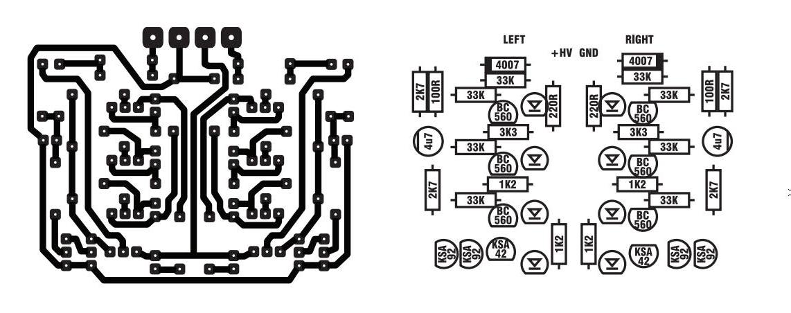

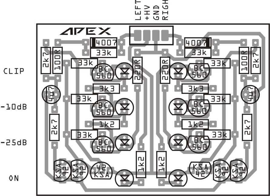

Will VU work with Quasi?
@nazirdigi
Nice! Can you share the pcb editable file of VU? I will only use it for one channel. TIA 🙂
@nazirdigi

@apexaudio
@nazirdigi
This VU work with any amp without adjust.
I´d like to have it!RE-SIZED.
if anybody need PDF pls ask. I'll share.

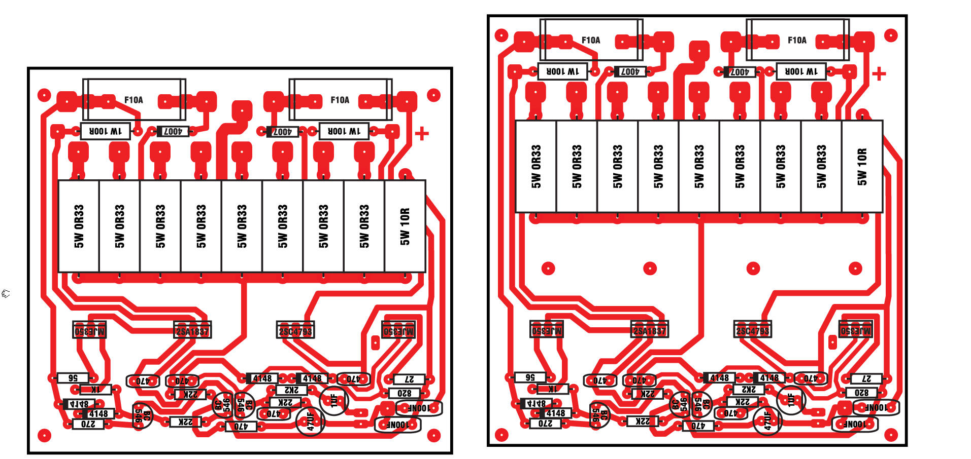

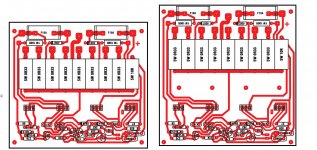

dear nazir,
is this protection pcb.thanks regard
that is power amp pcb.
dear sir
do you have this pcb with protection(pcb with relay)as i saw some where?
thanks.sorry for my bad english
Hi
Need to add a resistor of 0.33ohm/5W on the transistor 2N3773 or 2SC2922 (for Ucc=+/-70V) in the emitter of the negative branch of power supply.
Ceers😉!
dear sir
can i use these .22ohm2 or 3 watts resistors in place of 5 watts resistor.thanks your ever masood
The 0.22Ω in each individual transistor will be dissipating about 1W average power assuming 300W/4Ω with four pair of outputs, so a good quality 3W is probably adequate.
Remember that most resistor ratings are specified with a Delta T of 250°C, so a 3W part running at 1W will have a Delta T of 88.3°C above ambient. This will be over the boiling point of water if the amplifier is run at full power for any length of time, but it should be OK.
Apex the output transistor it is applicable to add as many as I can? Example 10 pair how much power output. Thanks
