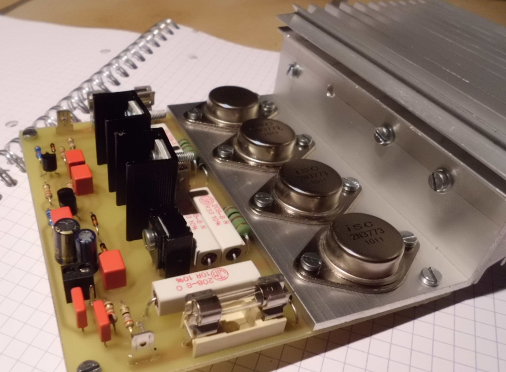

I built the amplifier with two pairs of transistors and it works with +-40V DC. The Sound ist great.
Thanks apex, very nice for beginners (like me ;-)

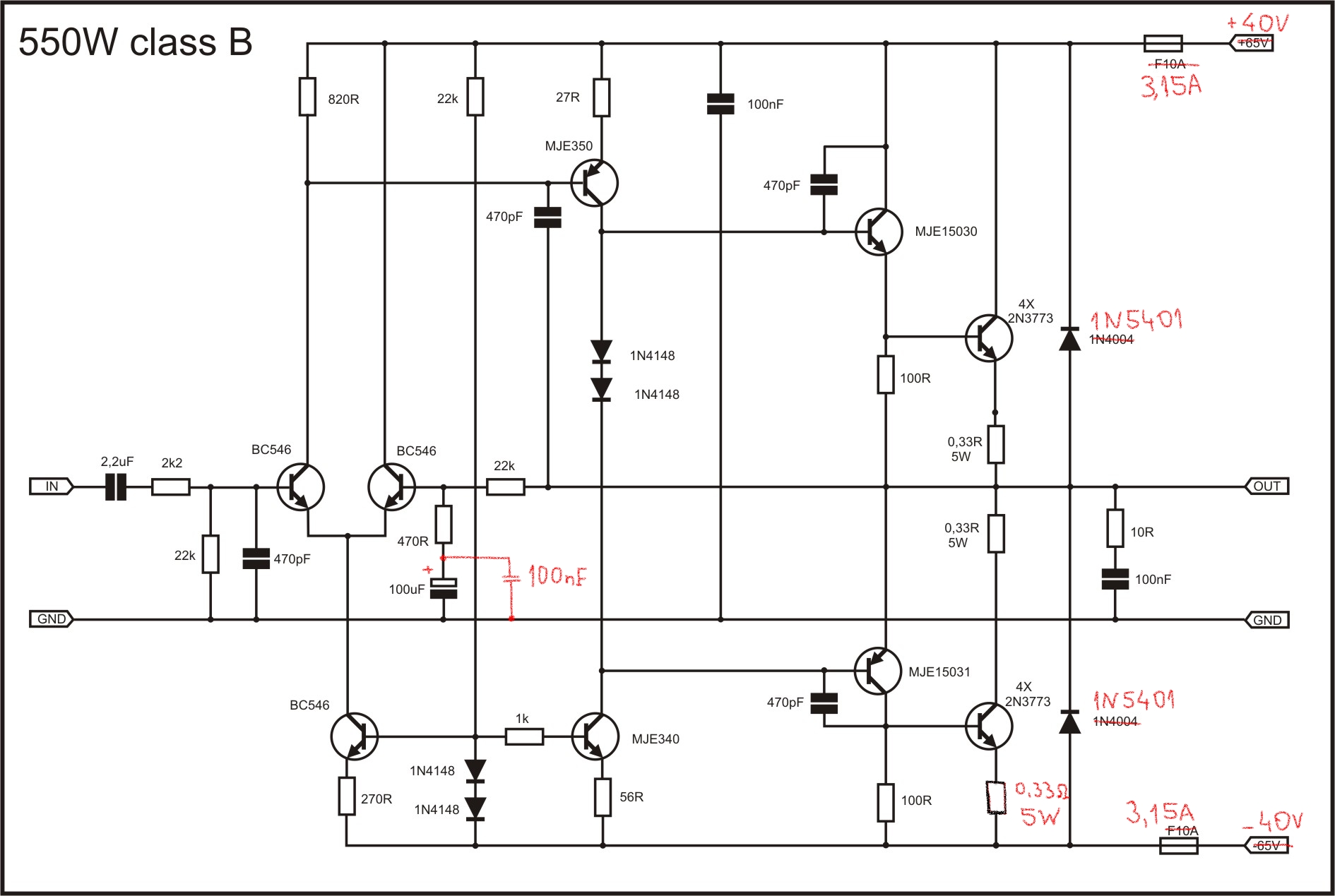

According to this schematic, where you worked?😕
Since the standard schematic error is ( take a look topic?!)
Such should be!!!

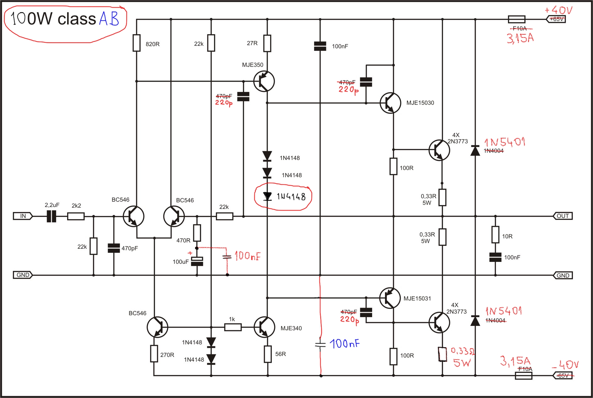

100W/4R class-AB amplifier
Hi, all!
Thus the amplifier can work in class AB!!

100W/4 class-AB amplifier
Hi, all!
Thus the amplifier can work in class AB (see schematic-1)!!
Tnaks and cheers!
Hi, all!
Tnaks and cheers!
Why well not?!Not very well.
Probably badly.
A higher "quiescent current" (about 100mA), audio amplifier goes to the class-AB!
Class-AB less THD distortion, ....

I built the amplifier (picture see post #663) with two pairs of 2N3773 and I use +-60V DC. Now the Transistors MJE350/340 become to hot. I can touch them for only 3-4 seconds and I think it is a bit critical.
Should I reduce the voltage (have regulated power supply) or are there any other things I can do? I changed the heatsink to a bigger version for TO220 like the MJE15030, but gave no better result.
Can anybody help me?
regards
Olaf

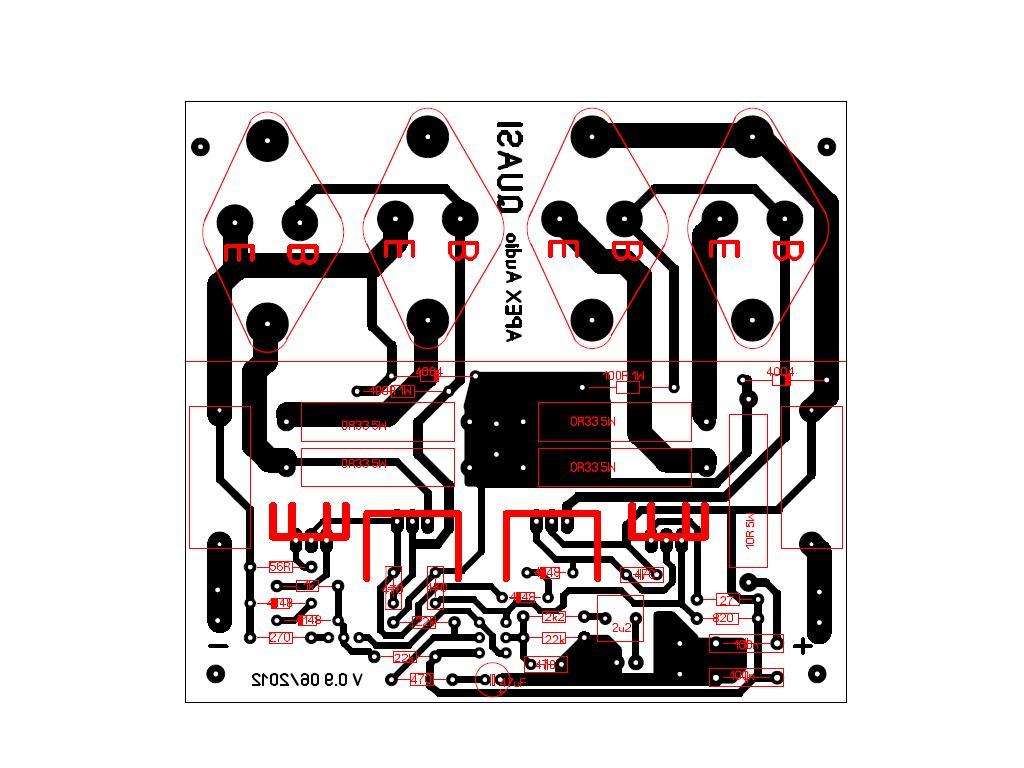

Nice work, MJE340/350 work in class A and must be hot but use 100R resistor instead 56R around MJE340 and this will reduce current in VAS CCS and disipation on MJE340/350 also.
Can you share your pcb?
Regards
Hi Apex,
it works. Thankyou.
Here is PCB.
regards
Olaf
Nice PCB, thank you.
