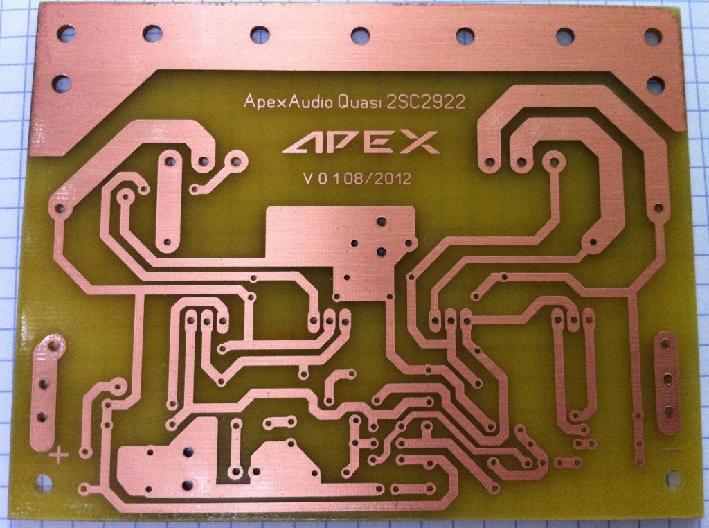

Can you share only PCB without parts in pdf, please? I would like to try your version with two pairs of transistors on output.

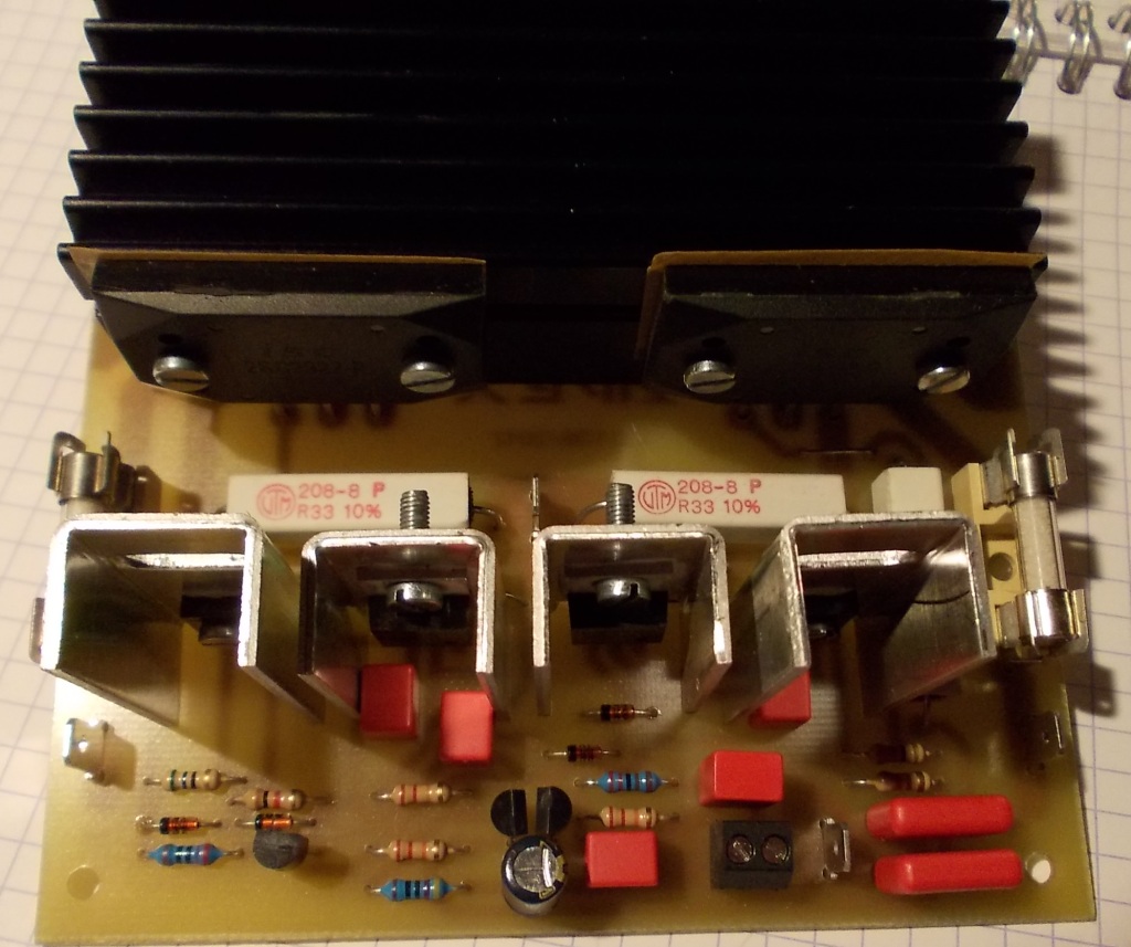

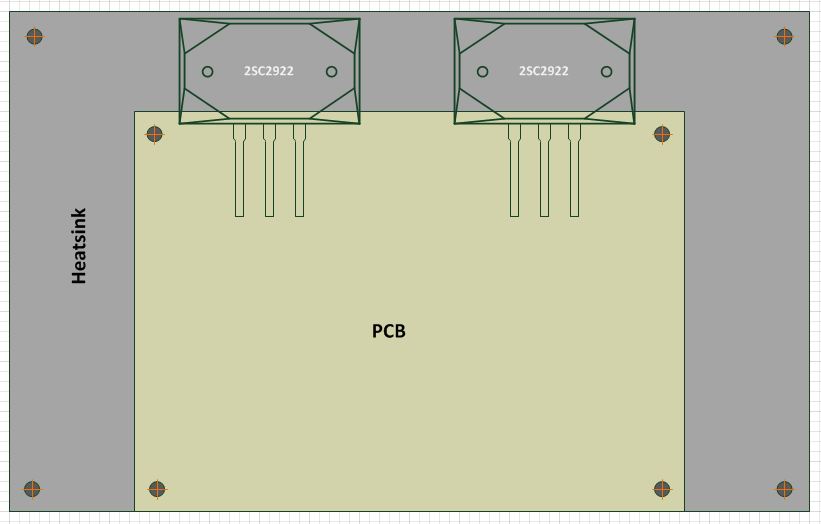

I will test a version with 1 pair of 2N2922. Hope it will be a nice compact modul.
(Picture is layout work in progress ;-)
regards
Olaf

Hi Apex,
thanks. I will post pictures.

Prototype is ready. The sound is as good as expected. PCB needs some replacements, some cosmetics and nice heatsink. Then should be ok 😉.
regards
Olaf

Olaf,
you have the output devices fixed to a fin of the heatsink.
This is not a good way to cool.
You should have the outputs fixed to the backplate of the heatsink.
The fins and the backplate of the heatsink should be vertical for best cooling.
The devices are not in a good place to dissipate heat.
They would be much better cooled in the devices are located about 40% up from the bottom of the vertical backplate. And the fins must be vertical.
Locating as you have shown will leave the devices and the top edge of the heatsink quite hot. The bottom edge and much of the middle of the heatsink will remain quite cool in comparison. This wastes much of the dissipation capability of the heatsink.
