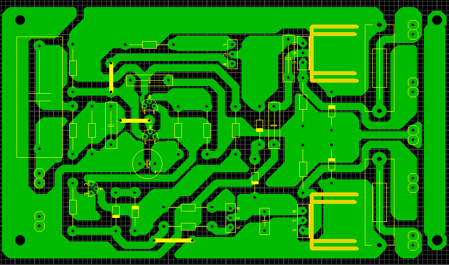

Just share PCB layout,
let me know if there is an wrong place 😀

Hello Petruv, building power amp circuits on veroboard is ok for small amps using chip type amps but not for high powered ones as this is asking for trouble.
If you look over the forum there's many ideas along with foil lay outs to aid a building first class amplifiers.. Trying to get huge power from small power 220 packages at low 4 ohms is again not good and there for your better off using t0-3 or transistors such as 2sc5200.
Regards A.
