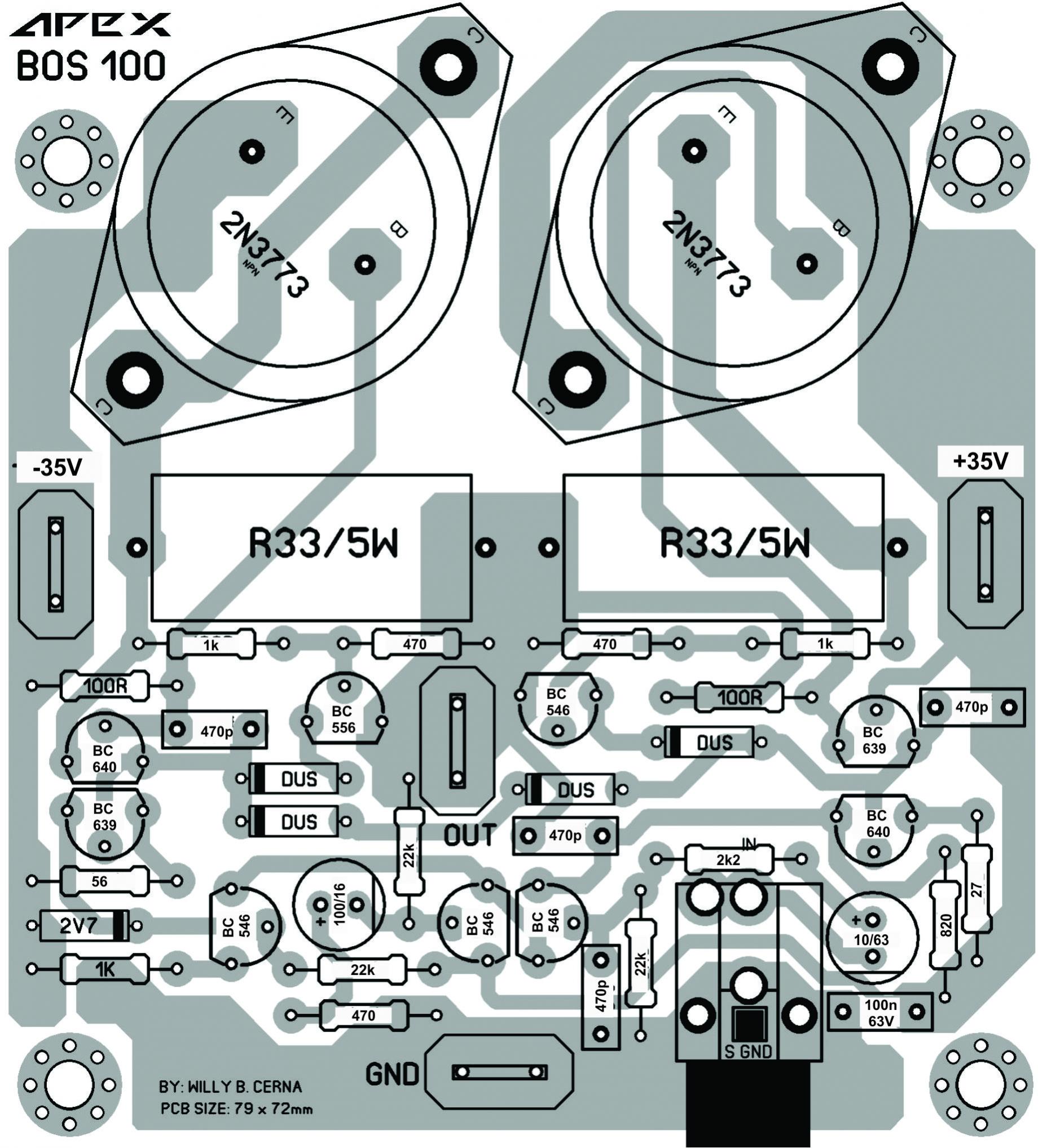

I used mje5032,5033' then mje350'mje350, then the bc546 i change to 2sa970 what resistor i change to handle 100vdcpk. Thanks..
Iwant to get 1000 watts in one channel ten pair 2sc5200 output.

What's the value of those caps and diodes?
DUS = 1N4148
Use this pcb as start point and AX11 schematic with MJ15003/15004 in output... and you will have nice smal PA amp with overcurrent protect (BC546, BC556, 1k, 470R...)
