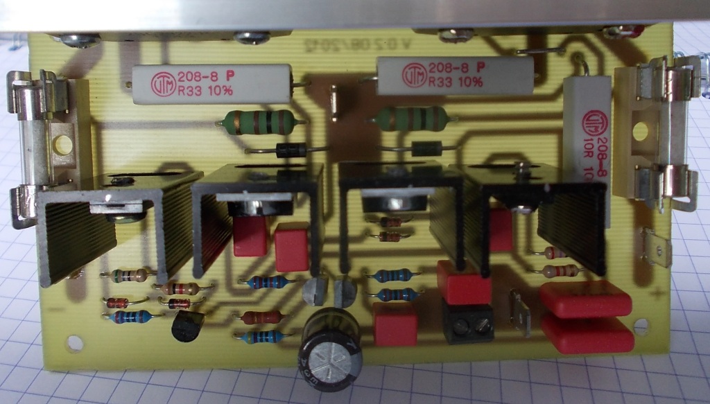

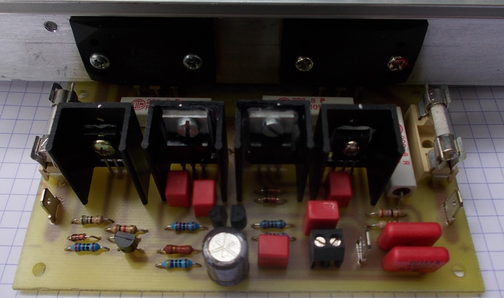

Hi olafk,
Can you share your pcb layout in pdf file using 2n2922? Thank you in advance.
regards,
Boyet
Hi olafk,
regards,
Boyet
i will upload the file tonight.
regards, Olaf

Hi olafk,
regards,
Boyet
Hi Boyet,
here are the files. Hope, you will have fun.
(Size is 110x85mm).
regards, Olaf
Hi Boyet,
(Size is 110x85mm).
regards, Olaf
Hi olafk,
Thank very much for your kindness. I want to try this to my subwoofer. Again thank you.
Boyet
