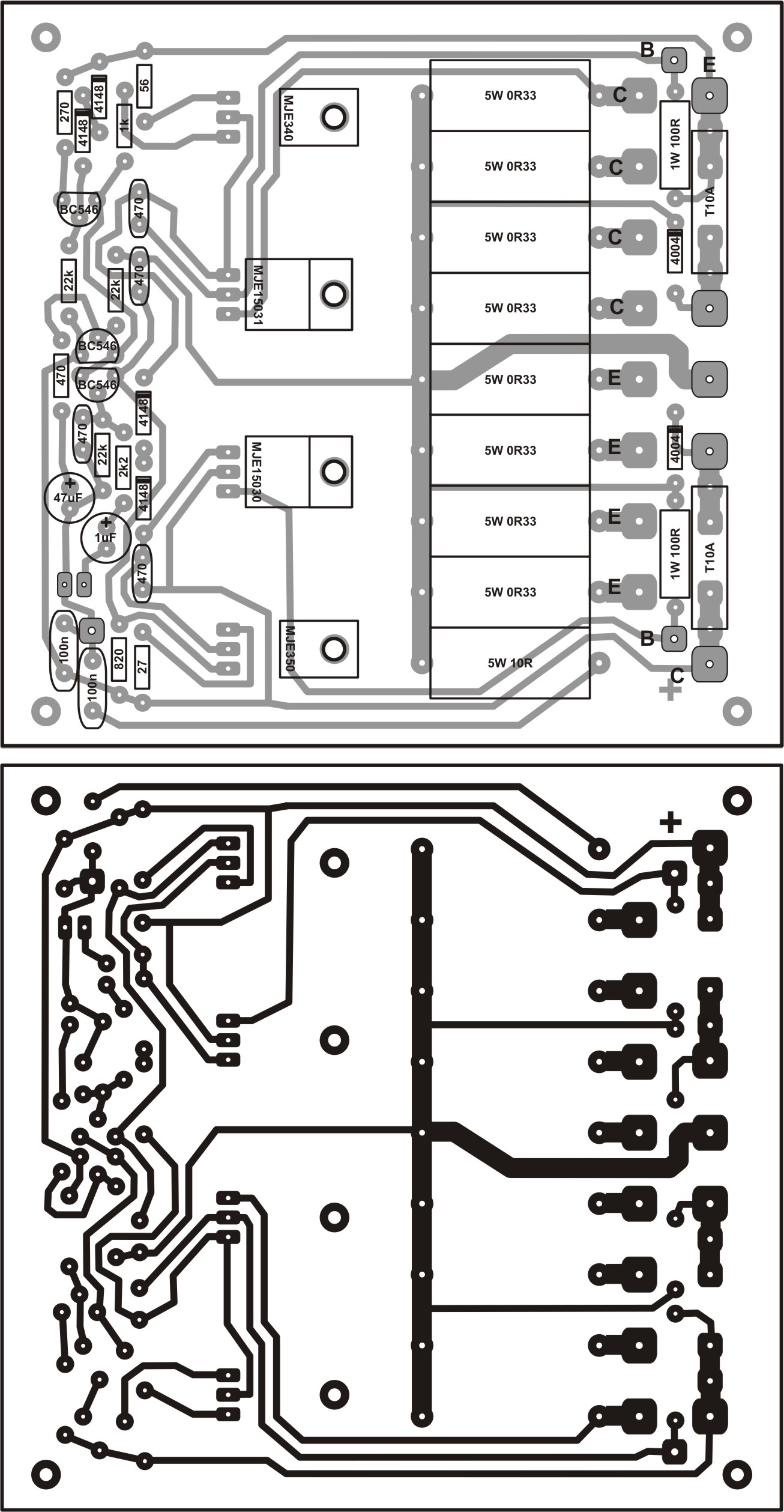

hi guys
i have some queries
1) In the scematic there are 2 capacitors 2.2 uf & 100 uf
http://www.diyaudio.com/forums/atta...uasi-amplifier-beginners-apex-550w-classb.jpg
But in layout they are shown as 1 uf & 47 uf respectively
http://www.diyaudio.com/forums/atta...amplifier-beginners-apex-550w-class-b-pcb.jpg 😕
which one is correct?
2) In scematics emitter of mje15031 is directly connected to speaker output
But in layout it is connected with 0.33R 5W resistor in between.
which one is correct & why ,because i have seen this in other designs also.
3) What is the wattage of resistors which are not mentioned?
thanks

Schematic is not correct!!??
Hi Sanju21!
Note: The schematic under point 1) has a bug, or is not correct!?😕😀
Cheers!
Hi Sanju21!
Cheers!
Such should be (see Figure 1)!😉🙂
Best regards!

i am unsure of adding a 100R & 0.22R resistor.
as i have assembled the circuit (point to point hardwired without pcb) & ran the amplifier on rail voltage 40 vdc & it sounded great without any problem.
now i want to use pcb but it's layout differs from the circuit given (which i mentioned in my post #594.
SIR, i am not questioning your knowledge,it's just that i am noob & doesnot understand the logic.
& does anyone has links for correct pcb diagram.
SORRY formula 22 if anything i said offended you
