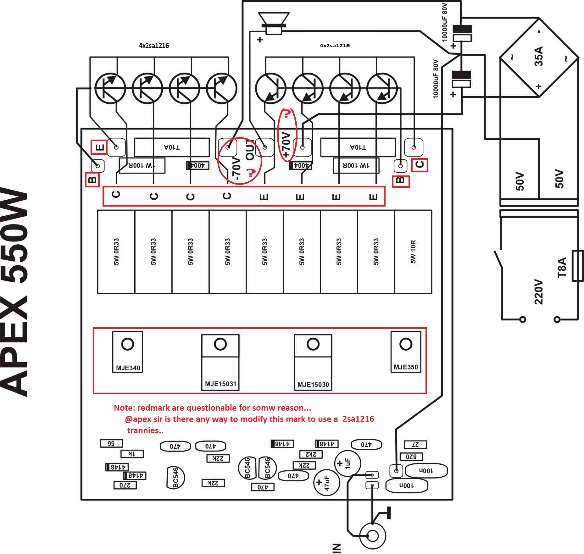

sir apex i like to put this in my h900 do you have pcb layout of this?

I will sir as of now I'm into a second board for etching he he he i got to use the old good way for making the PCB wish me good luck sir

@apex sir is it possible to use a PNP trannie to this P.A. and how pls enlighten me sir and i ask something else else is the feedback resistor of this AMP is 22k or 2.2k where can i find it the quality is good but to much med or i mean to much vocals what value of resistor di i change to become lesser meds/vocals
