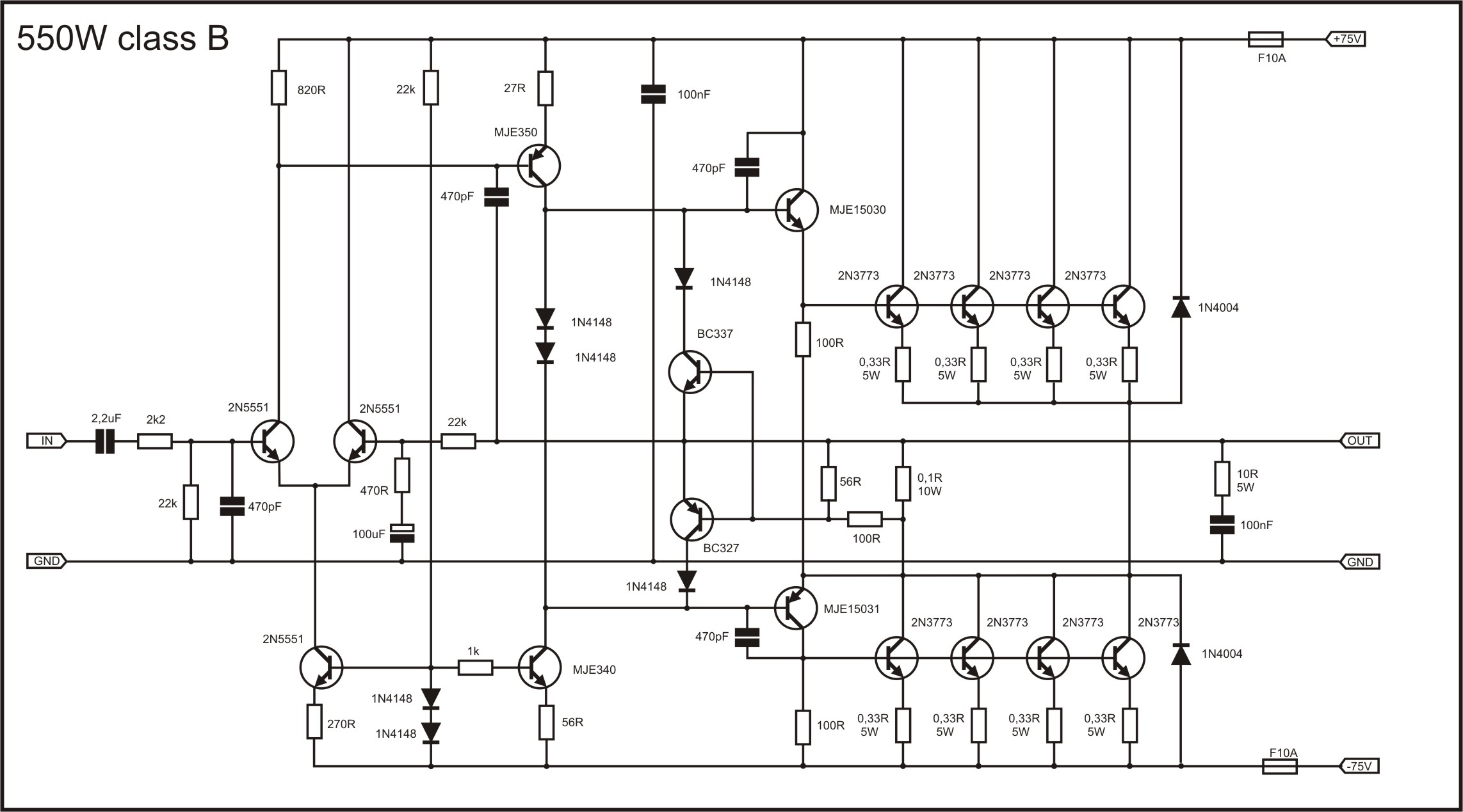

hi Apex..
i want to continue this PCB project,
what the additional circuit to complete perfect power amplifier (PA),
for illustration:
input--->APEX550--->output
what kind of input and output circuit for best PA?
can give me the circuit schematics,
thanks

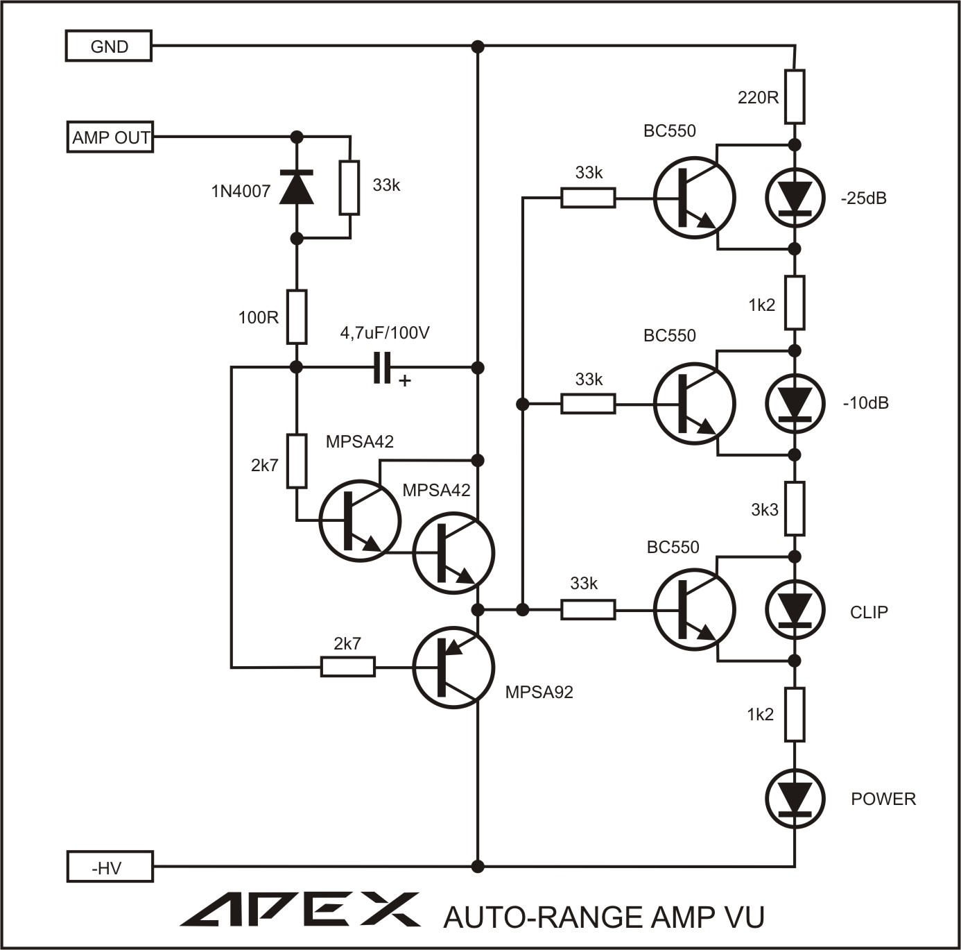

With only 3 wire for connect this VU meter can be add to amplifier, and you have 4 LED display per channel.
