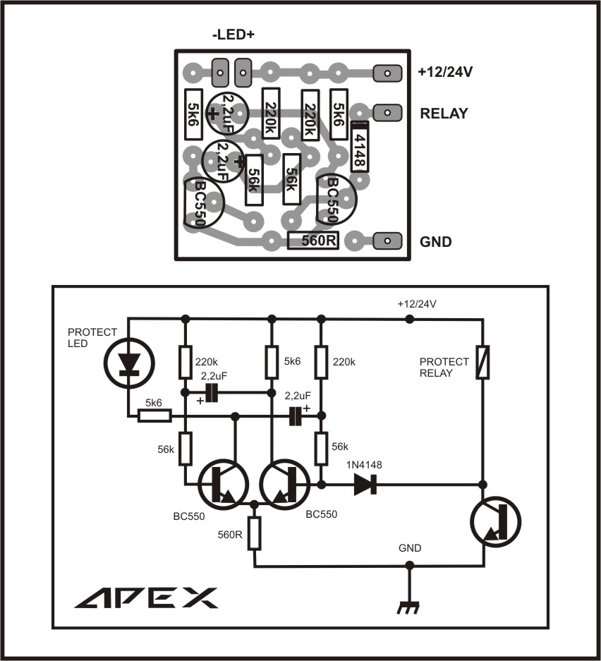

your nvmos amp pcb is working in 2 ohms 90 volt dc using IRF460 I WILL post pics of rail swinger

PCB size 25x28mm

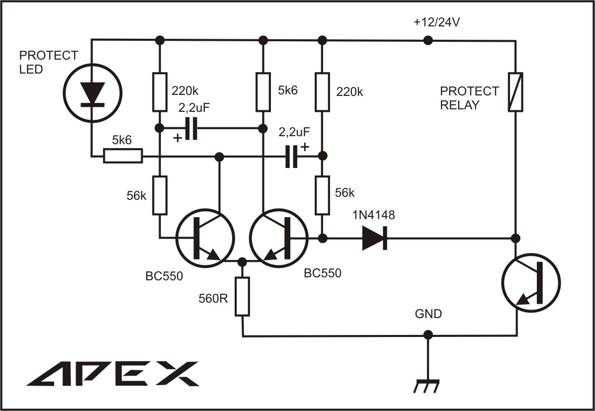

very nice sir,
in the schematic there are three transistors but in the pcb two transistors why is that?
very nice sir,
Transistor and relay is parts of some protect circuit not parts of 'protect led blinker'.

Connect 'relay' from 'protect LED' pcb to NE555 pin 3.
