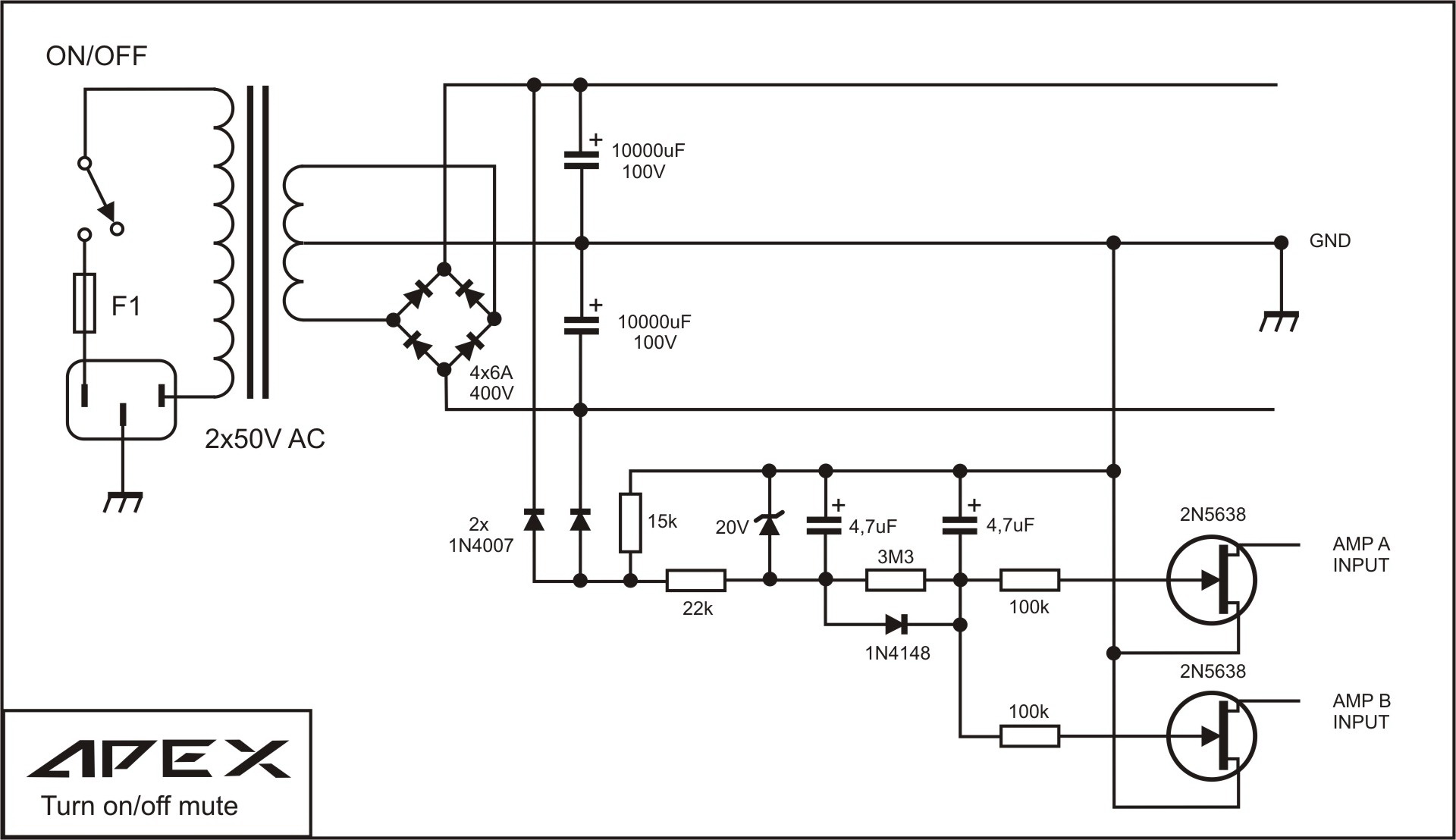

QUASI Amplifier for Beginners
schematic here below ......🙂 first pic for NMOS second pic for radio

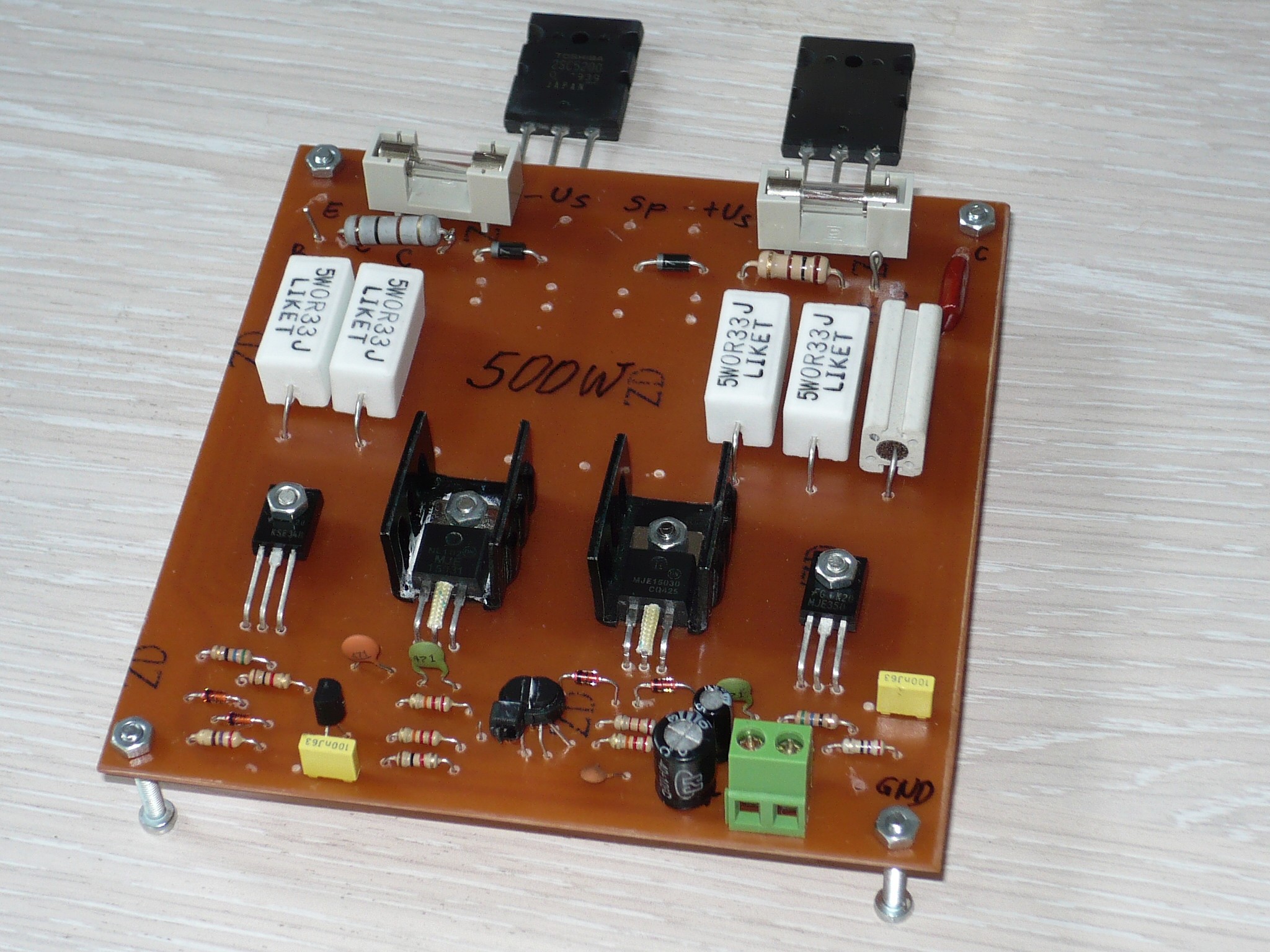

Hi Mile!
I made this Quasi amplifier (picture below), but two things bother me: Why security diodes 1N4007 are connecting to the PCB in front of the fuses and why 0,33R/5W resistor is connected to the collector output transistor (2N3773), not the broadcaster?
Mile you do not need to make a correction?
Waiting quick response after I made ​​amplifier!

This amp has awfull THD ratios, not only because it s
working in Class B, but also because of an huge overcompensation.
No way it can be branded hifi, not even as a bass box amplifier....
In a way, it can only disappoint even the most enthusiast beginner..
A sad gift to give them such a misdesign...

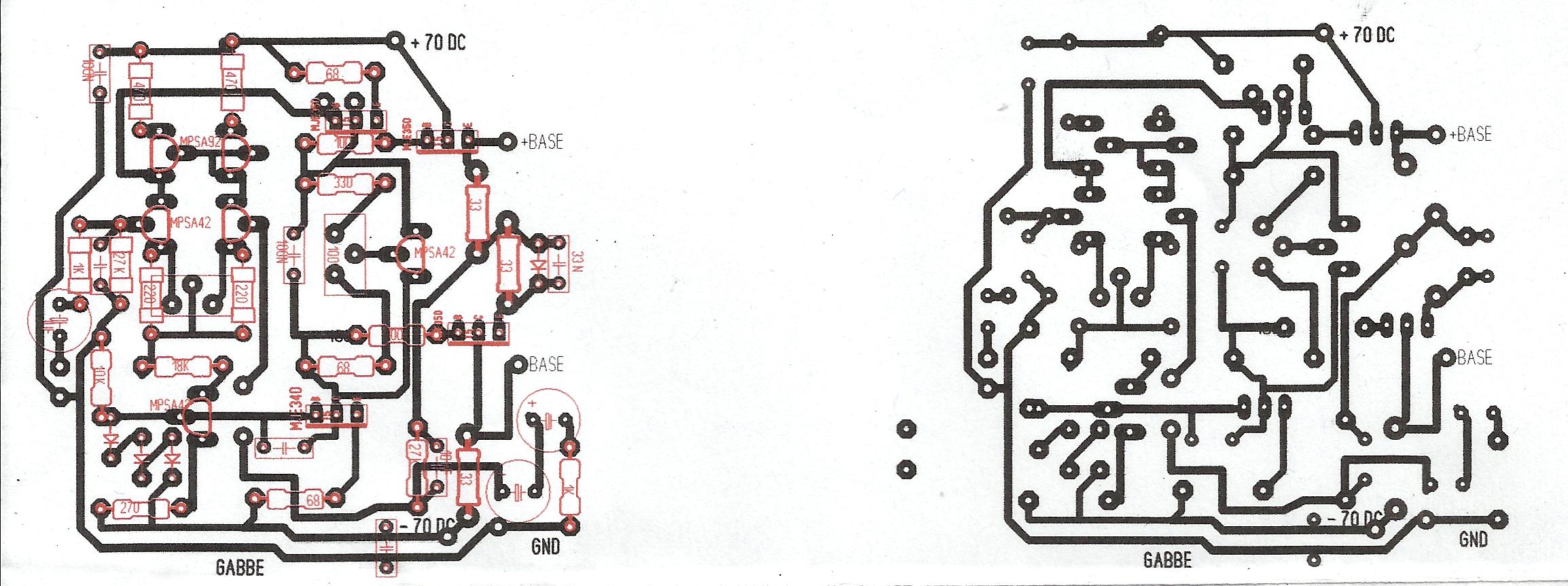

Hi radio ,
I have search for you an better schematic , also tested one . I have done small changes for 2SC 5200 as finals ..... I hope you like it .
Regards Alex.

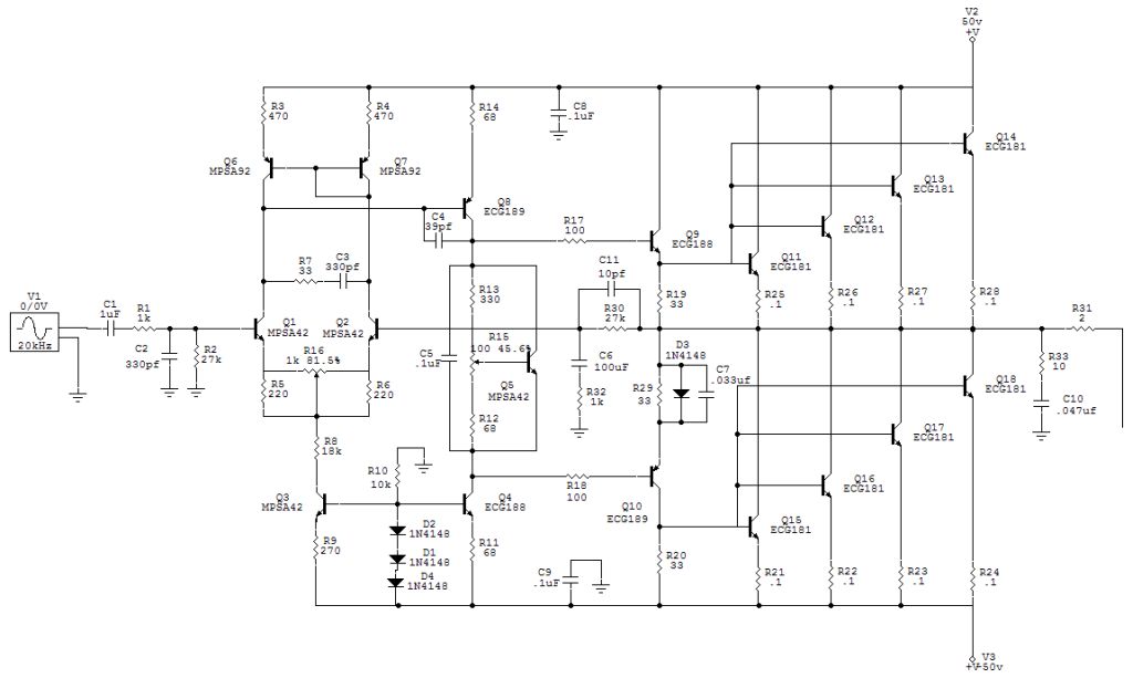

I like this amplifier circuit,
I have been messing around with it in circuitmaker all day.
So far I have done sims with the 2N3055's and the 2N3772's and TIP31a's and TIP32'a.
Mostly stuff I have laying around and I am sure I have enough to build one or two.
With A few tweaks in some of the resistor values I have it doing 80V p-p into a 2 ohm load and 66V p-p onto a 1 ohm load on -/+ 50V rails and 91v p-p into 8 ohms.
This exactly all I need to run my ESL experiments without having to risk my professional amplifiers should any thing go wrong.
And if I need more, it can be easily modified for more if needed.
When I get one built and running I will certainly run it through some heavy tests and post the results here.
My main criteria is to have a 40v to 60v peak swing all of the way down to 1 ohm at 20Khz but 2 ohms is sufficient for now.
The 1 ohm requirement is only for the impedance that the ESL's reflect on the high frequency peaks at 20Khz and at 10Khz this would be 2 ohms.
In the sims this circuit shows a flat response up to 100Khz.
This is a very affordable amp to build out right if one wanted to do so,But like I had mentioned I already have most everything in my parts bin.
This seems to be a step above some of the more very common Quasi Configurations that I have been messing with, and, I am curious to find out what its performance will be like using some common off of the shelf components (transistors) that I have just laying around.
Thanks !!!
jer 🙂
Here is the schematic with my modifications.
The output offset voltage is set to less than 1millivolt (.001v) and the bias is set at about 250 milliamps per output device with the values shown.
Cheers !!
jer 🙂
