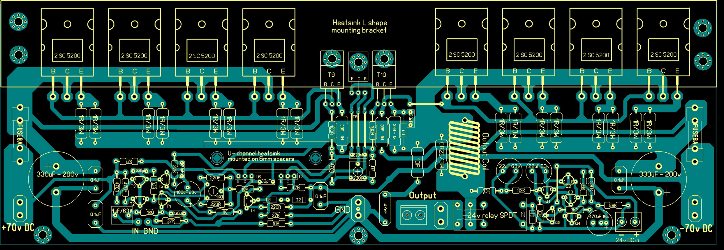

Hi. This is my pcb version of QUASI amp with short protection.

which apex550w pcb layout is better?
Give Top layout for PCB the first figure!😕

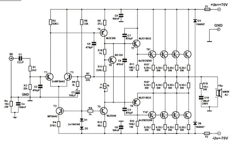

Hi Mile (Apex)!
I made this your amplifier, with power supply Ucc= + /-68Vcd (2x50Vac), and with the output transistors 8xMJ15003!
When i let the amplifier somewhere with 50% power, after 2 ... 3 hours of work output transistors burn!?
With the diodes D3 and D4 impossible to regulate the bias.
So I made some changes with the transistor - see schematic (Figure 1)
Question: Is this a good solution to the transistor, if not please suggest some other more secure!
thanks and cheers !

You need separate emitter resistors for each output transistor.
They should be a higher value, but can probably be lower power. Maybe 1 ohm, 2 watts each.

Is a good bias schematic with BD139 ?! 😕🙄

Hi
If you are able to draw a schematic with complementary output pair 2SC5200/2SA1943.
Is good value for C8 = 470nF??!
thanks and cheers !
What you search it's right here.....
Hi radio ,
I have search for you an better schematic , also tested one . I have done small changes for 2SC 5200 as finals .....🙂 I hope you like it .
Regards Alex.

Hi Alex mm (POP) !
Thanks Alex mm well done!
Only if you will give even more protection schematic. For T8 can eat BD139, or need some small changes ?
Minor edits!
Alex mm, whether this schematic is to be processed and output to be a complementary pair with transistors MJ15003/MJ15004?
