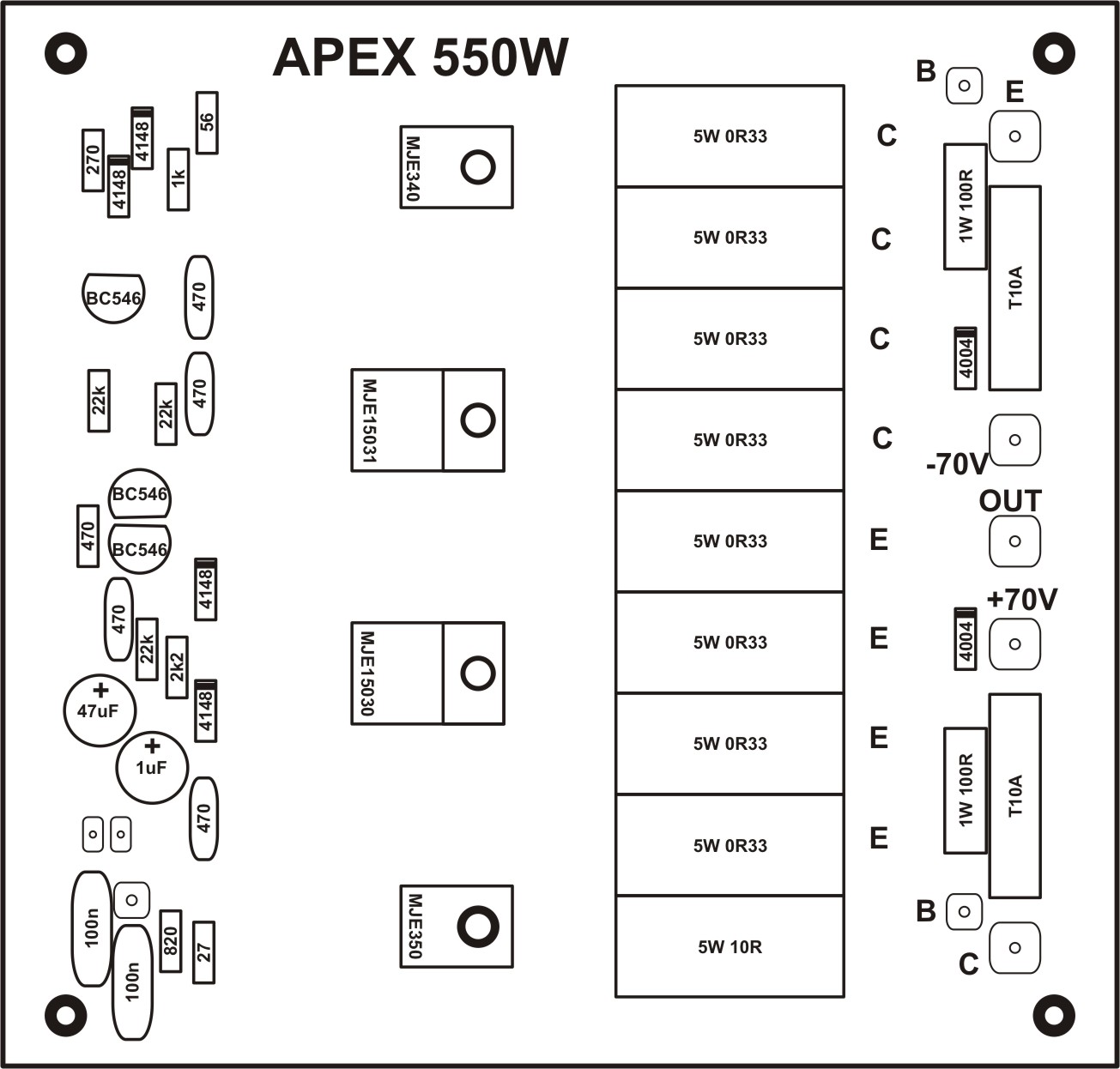

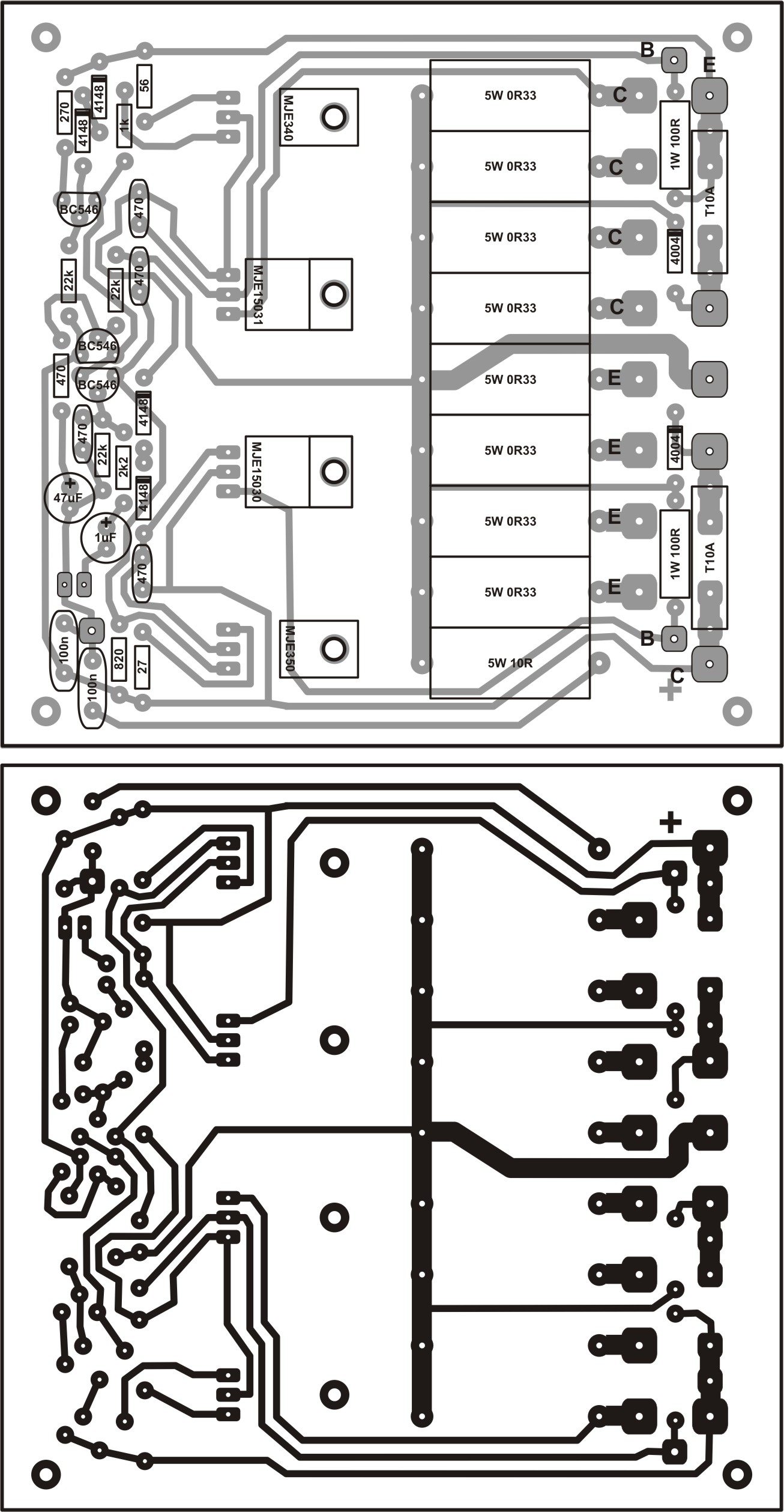

PCB size is 110x105mm, fit top layer in this size.
Regards
Ok For indeed the same size but different picture mr ....... there are holes for the bottom layer and top layer to ga there, distinguishing it?

signal pair of trannies on that supply rail is asking for trouble.. it's a very basic amp using the diode system to set up the bias voltage..peavey old bass amps used same idea in there o/p amps.. it's better to use the amplified diode transistor tracking like so many amps out there..
Crossover distortion is only really audible at low volumes so you can get away with a couple of diodes if your not too fussy.
However I use a Vbe multiplier in my designs in case i want to listen at low volumes.
it's better to add more o/p's transistors when using supply rails from 55volts and higher...
most of the amp's I've seen over the year's use the vbe multiplier design making setting up the amp much better... still it's all down one's choice...
The Vbe multiplier isnt idot proof. Many years ago my first amp with Vbe multiplier blew up on power up as I had turned the pot wrong way.
After that disaster I always put a zener in parallel with the Vbe multiplier to stop it going too far.
so your clamping the q setting voltage! some may set the vr adjustment to half way and check the reading across the emitter resistors. in the case of some mosfet stage's with no source resistors the quick way would be place the meter between the plus rail etc but we know this already...
some newbie's to the world of amp building will need some pointer's in the right direction and there are many of us that use our own style of setting up unit's..as they say 'there's plenty of way's to make a pot of tea and the out come is the same..

Quasi complementary amplifier based on old Dynacord. For begginers Class B without adjust.
Excuse me, i may be tired this evening, but i am building this amp from the schematic (not from the pcb) and on the schema the MJE15031's emitter goes to OUT rail, but on the pcb it goes to one of the output trannies' collector.
Please say it is only my mistake, or i don't see something obvious.
