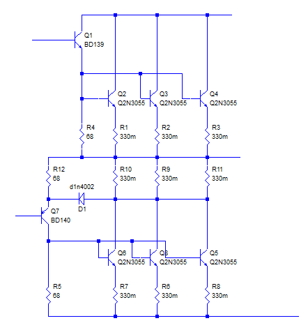

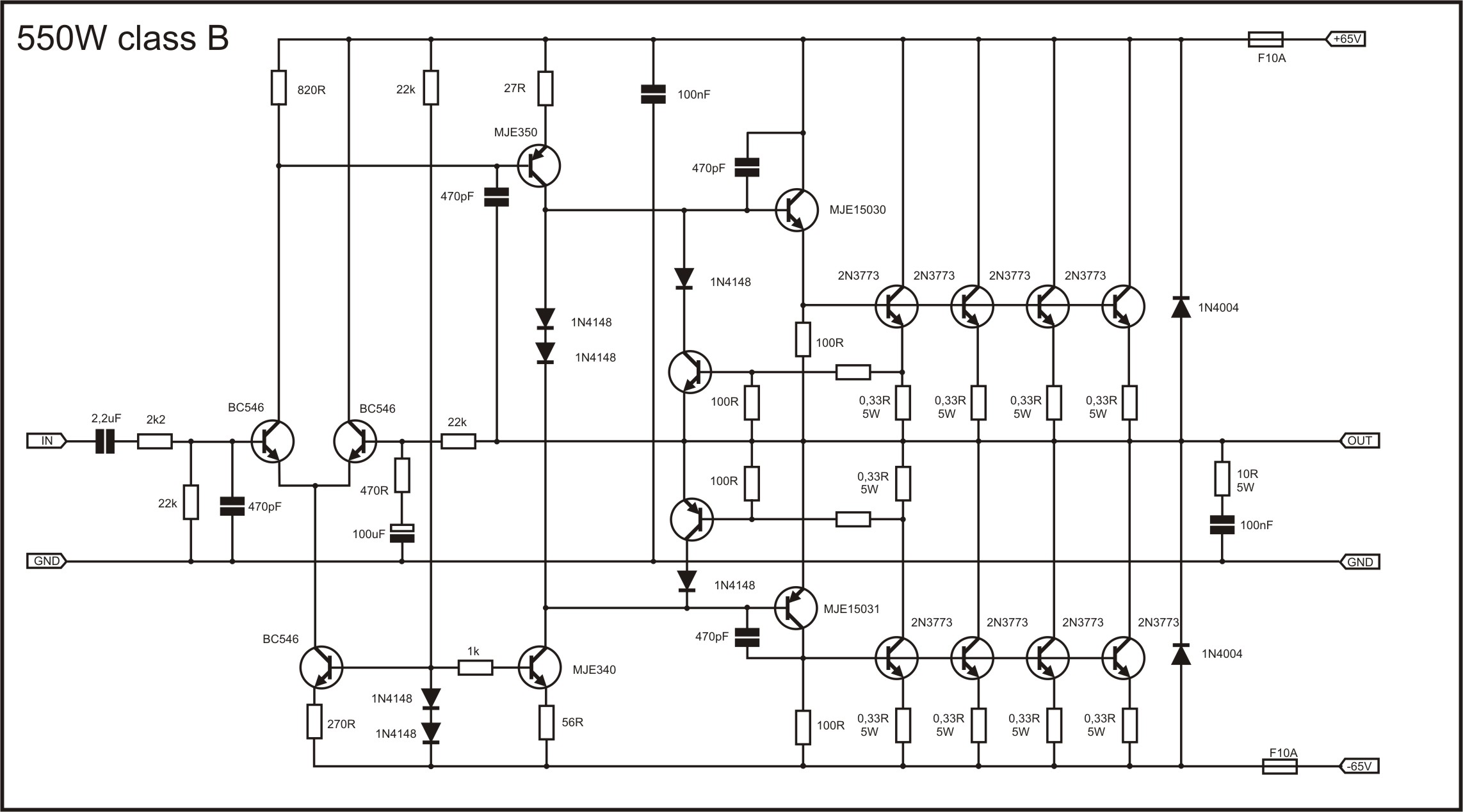

Sorry but it is not good to tell beginners that a circuit which does not have current sharing resistors in the emitters of parallel transistors is good practice. In post 87 there is an example of how this might be done (only the general idea - there are several errors in that circuit too {e.g. too high voltage for the 2N3055H, wrong short circuit protection connections}). Post 228 shows collector resistors which do absolutely nothing in three of the output transistors. That's not good guidance for beginners.

FOr good symmetry, I would recommend two sets of resistors in parallelled output (lower half) transistors. One in each emitter, but the others in the collectors can be parallelled to give the same overall resistance. THe PNP driver emitter can be connected to this parallel junction or through a Baxandall diode. I did not measure much improvement when using a Baxandall diode does not make much difference when the output-to-VAS compensation is used, but it is marginally better.

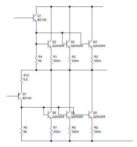

Hi
Here are two ways to parallel a quasi output stage. The first is probably the better approach but has an additional set of power resistors. The second is cheaper but care has to be taken to make sure that the voltage drop across the resistor of the pnp driver does not become excessive.

Hi kkantzz
The emitter resistors probably need to be increased. IF you have three transistors with 0.33 ohms each, the total emitter resistance is effectively 0.11 ohms. This is usually not enough to be certain that the currents are stabilised. The overall resistance could be 0.33 ohms, so each individual resistor could be 1 ohm and the currents should be distributed better.
THis also depends on the heatsink you are using, and for high power amps I normally use very low thermal resistance heatsinks which would be OK with lower resistor values.
Next time your amp is powered up check the voltage across each resistor. The
Hi kkantzz
Next time your amp is powered up check the voltage across each resistor. The voltages should reflect the quiescent current (e.g. 50 mA => 16 mV). If they are unequal, use bigger resistors or check if the transistors are all at the same temperature (mind any high voltages around). If the voltage is much higher then fitting larger emitter resistors will bring the current down as well as even out.
