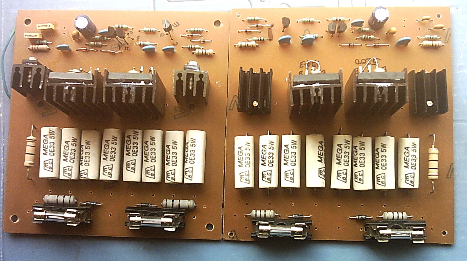

hi apex,
I have made two module of this amp.First one made on wrong pcb design(post no.1) with correction done, is working fine but when i made second one on correct pcb design it is not working properly.I am using only 12-0-12 trafo for testing.When i am removing the diodes from the base of bc546,amp works.Voltage drop is also too much when comparing with first module. The positive side of amp is dropping the voltage too much while in first module there is no voltage dropping.MJE 340 getting hot.What may be the problem ? i have checked all the components and tracks for fault and short circuit but unable to find the problem .Is there any mistake with new pcb design ?Kindly suggest me

No mistake on new pcb, can you post pictures? Use trafo with higher voltage and 60-100W/220V bulb in series with primary for test.

Now its working.I dont know what was the fault, i just changed the mje340/350(according to multimeter testing these are ok).i am attaching the pictures of both modules.one is made on reversed printed pcb.I have ordered for a 50-0-50 trafo & it will be used with 5pairs of o/p,20000uf cap per side.
just one question more...........is it a stable amp ? because i have read many critisism of this amp in this forum but i have selected this amp because of its simplicity & power.(offcourse i have a lot of 2n3773s too)
photo in next post.
photo in next post.
Amp is very stable, becouse it's overcompensate for working in class B without audiable distortion. Critisism is from people who are not diyers, just like teoretical discus about amps, and this is practical amp, clone of old DYNACORD, amp was usen for powered mixers and guitar amps.
