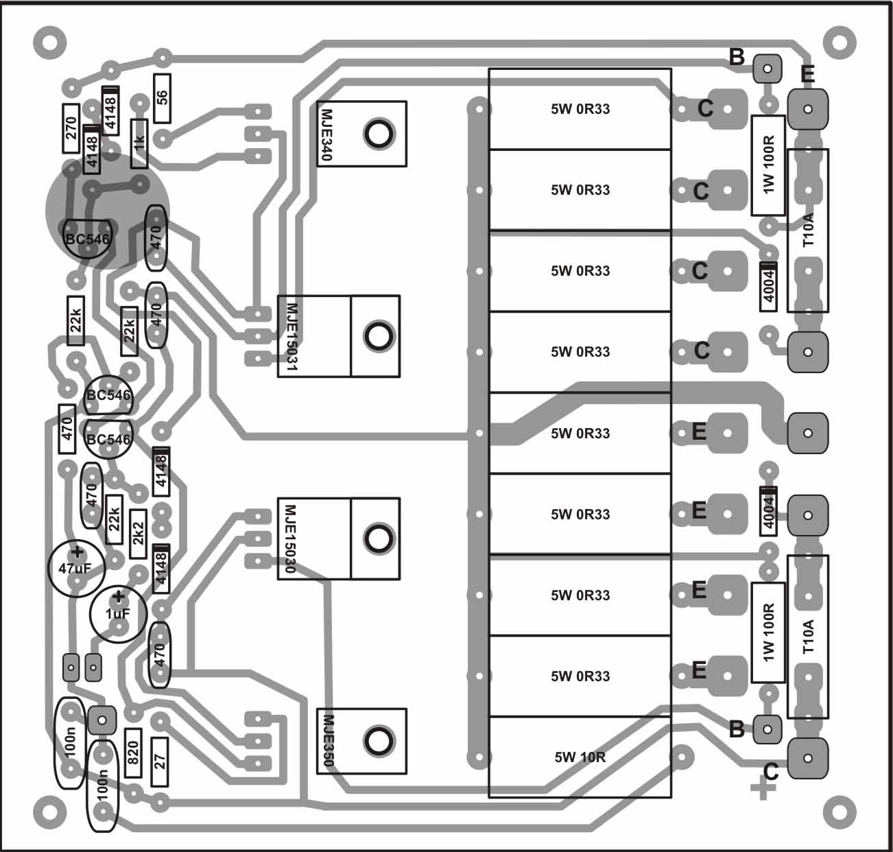

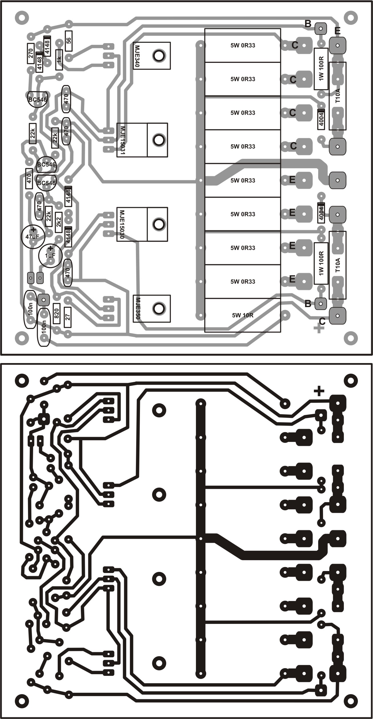

correct pcb
i found two pcb layouts in this thread which one is correct pcb?
