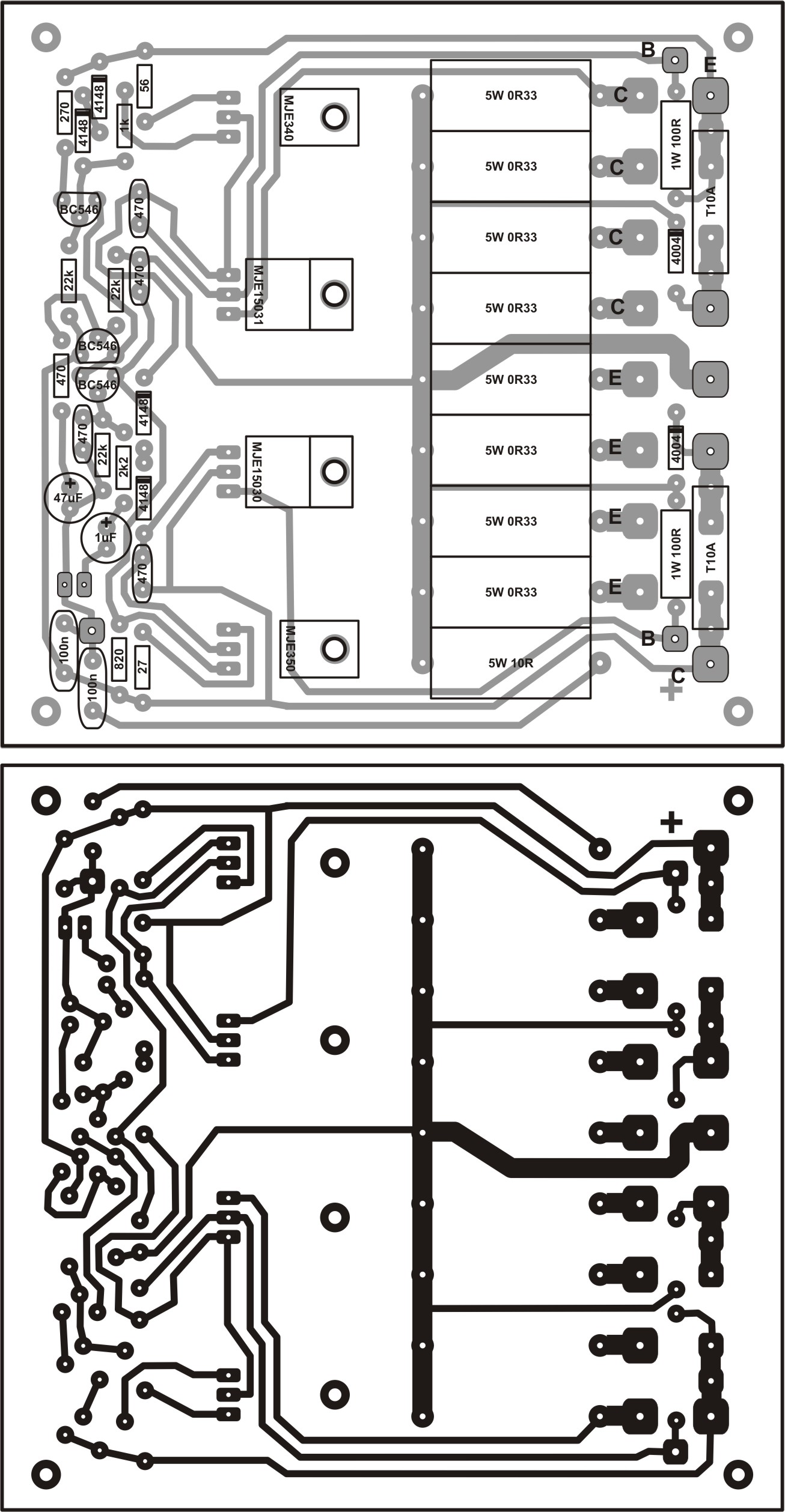

God gracious Apex, this is a great success. I made it and it works fine. Thanks you very much for the schematics and the PCB layout. Even tough I modified it a bit but it still retain the same artwork as yours. Thanks again. Below are the images:
I am using ExpressPCB for the PCB layout and the schematic. You can download it for free from this website: ExpressPCB - Free PCB layout and schematic software
please post your pcb design in pdf format.

hi apex,i have made pcb for this amp.Now i am about to place components.At my place a1943/c5200 & mje15030/15031 pair is available for same price i.e.2 $,so is it not fair to use these as drivers.Kindly reply me because i have bought all components except drivers.
hi apex, i have completed this amp through self made pcb.it is working fine ,currently only with +/-12 volt.pcb track for ccs mje340 base resistor is wrong in your pcb layout.
with this supply there is offset voltage of 32millivolt on output, is it right.I will increase the supply voltage after confirming about offset voltage.which set of in4148 diodes are placed on heatsink for thermal bias control ?
PCB with corrected track layout, offset is high but OK, no need to place 1N4148 to heatsink this is class B amplifier. Can you post pictures?
Test amplifier with +/-12V rail voltage is wrong. Use 10R instead fuses or serial bulb 100W/220V in transformer primary for test, and use proper rail voltage.
