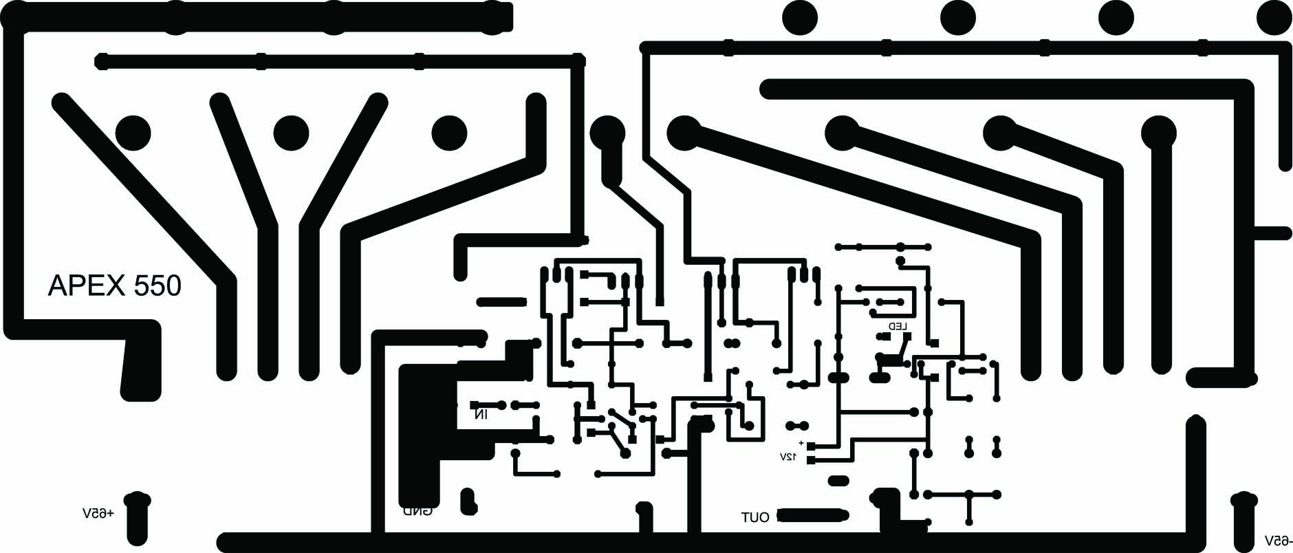

hi apex, I recently found a lot of original motorola 2N3773 trannies.Now i want to make a powerfull amp by using these.I am interested in B550. I have some questions.
1.What is the maximum psu voltage with the maxmum no. of 2N37773 for max.output with this circuit.
2.I think this circuit is only suitable for bass amp ?
3. MJE drivers are hard to find here,2sa1943/2sc5200 is easily available though these are o/p devices , i think it can be used for drivers also.
4.With above drivers how many pairs of 2N3773 is needed for bridge application
One thing more that i am not merely putting questions but i am going to make this amp within some weeks so a reply from you will be highly helpful for me.
3773 have max Vce0=140V.
I recommend no more than +-65Vdc for a power supply.
For bridged you must design each half with the ability to properly drive a reactive load impedance of half your speaker impedance.
If you have 8ohm speaker, then you design the amp to drive 4ohm and/or 1r5 from the supply rails.
If you have a 4ohm speaker, then your challenges are going to stretch you.
Expect the output stage total wattage to be between 5 to 6times the expected maximum output power.
+-65Vdc will give ~200W into 8r0 and ~400W into 4r0.
to drive 400W into 4r0 then expect ~2000W to 2400W of BJT output stage power dissipation capability.
You need two of these to get your 800W into 8ohm amplifier so total output pairs is ~ 4400/150=~30pairs (15pair in each half). Yes, 60 2n3773 for a bridged Quasi driving 800W into 8r0.

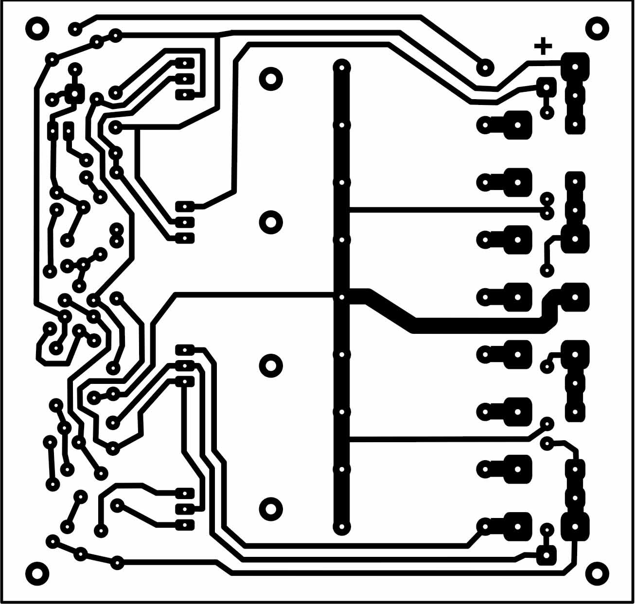

i have built this amp
http://i907.photobucket.com/albums/ac278/sunsheat/IMG_0875.jpg
http://i907.photobucket.com/albums/ac278/sunsheat/IMG_0876.jpg
http://i907.photobucket.com/albums/ac278/sunsheat/IMG_0877.jpg
with 2n5551, mje150332/33, and 6 pairs of 2sc5200
my question, can i feed it with +-90v??? 😀😀😀
any suggestions pls..

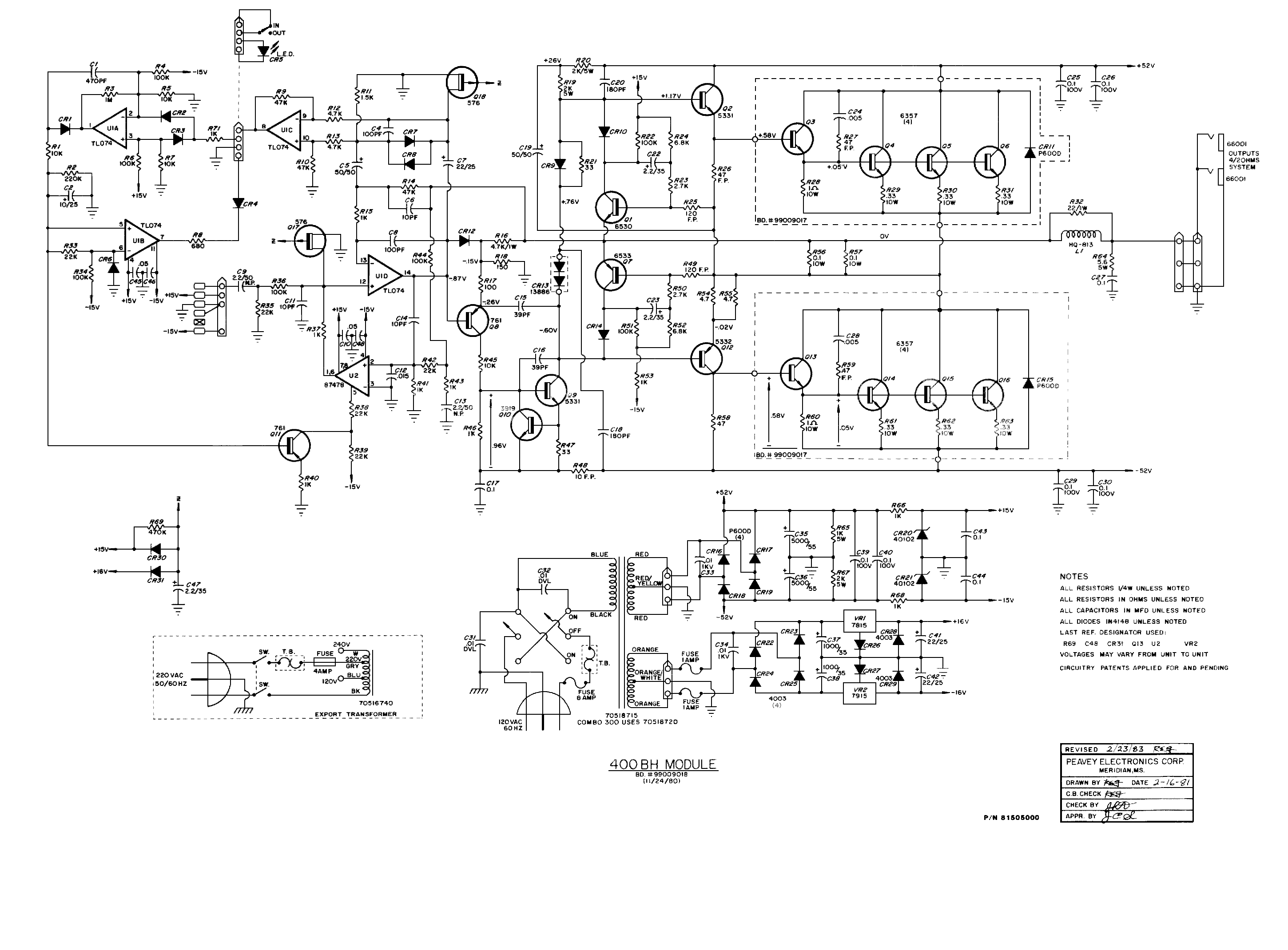

@ apex
sir can you re design your qusai with a op amp input?
No, but there is many similar schematics like this Peavey...
Regards
Q1, 2, 4, 5 2N3440/5415 or MJE 340/350
Bias transistor, just about anything.
Outputs (and drivers) 2N3773, MJ15022/24, etc.
Opamp LM318 (50V/µs slew rate)
Protection was a DC crowbar, a thermal cut-out on the heatsink, and a circuit-breaker on the transformer primary.
