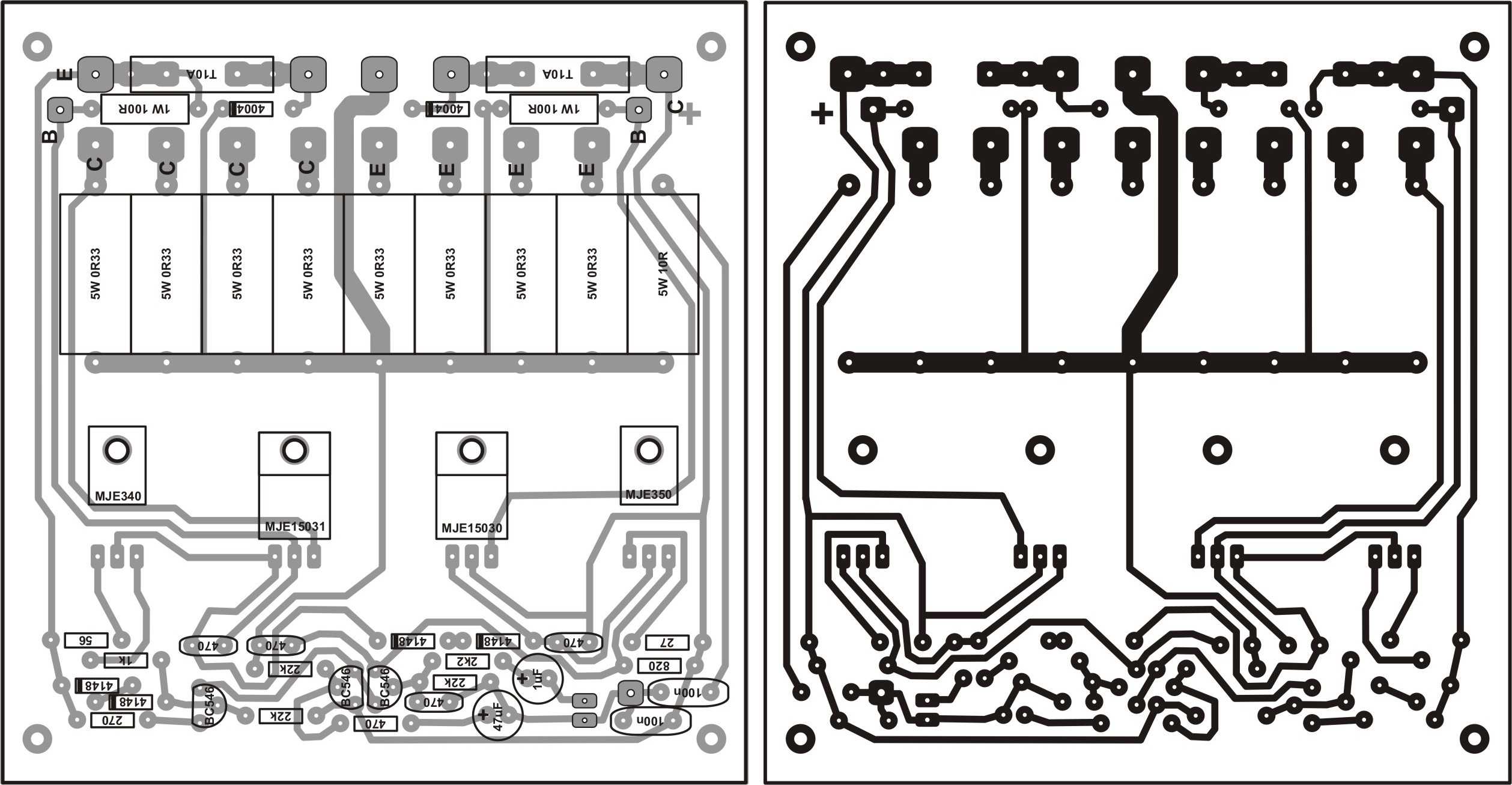

dear sanu,
i have build small wattage amplifier such as tda2004,tda2012 etc.and am going to make amplifier by 2sk1058 and 2sj162 mosfet transistor.do you have any pcb of this .these mosfet are costly.by this reason i am afraid .do u have any idea.thanks
Hi masood,

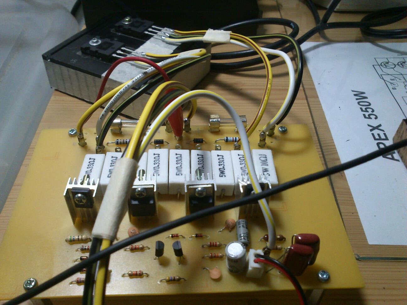

i have only build 2 nmos 500.one was perfect,the other one well, it sounded harsh. after sometime of playing ,one power resistor of o/p mosfet cracked while the first channel was doing good.i think the second channel was oscillating.i abandoned the project as there were other ways to get more power (i only need sub woofer amp not HI - FI).
I am building bridged apex550 with 54 volt dc of rail voltage .It will give me over 700 watts of power @ 4 ohm.There are advantages
1) 63 volt caps can be used(cheap)
2) 1/4 watt resistor can be used
3) probability of both channels dying at the same time is less
4) i think i can use bd139/bd140 in place of mje15030/15031(my dj amp has the same topology (it has got 32 o/p transistor 😀 )
i will start the project of av800 after apex550,but i have no access to oscilloscope 🙁 .
i will hard wire the o/p mosfets (which results in oscillation)
do you have deep knowledge of mosfet(like input capacitance etc.)?
is irfp460 & irfp240 lateral mosfets or vertical mosfet.
what is the price of the mosfets that you mentioned.
here the price of one irfp 460 is Rs. 60
2n3773 is Rs. 52
mje15031 is Rs 55
Reactions: vishal raju
Quasi's can be prone to oscillation.
My design did to start with but some fiddling with feedback capacitors sorted it out. The lower driver transistor needed a 100pf from base to collector.
The VAS feedback capacitor also needed upping to 100pf too.
After that it worked fine for many years.
..............54 volt dc of rail voltage...............
4) i think i can use bd139/bd140 in place of ......................
is irfp460 & irfp240 lateral mosfets or vertical mosfet............
Are your bd139/140 rated at >108Vceo? What about adding say 10% to cover for spiking on the supply rail?
Lateral mosFETs are described as such in the datasheet.
Vertical MosFETs are usually described as switching in the datasheets.
