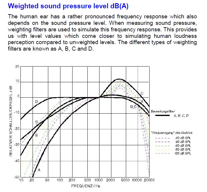

For noise I can understand the need for weighting but not for distortion.
My objection is pointed at marketing. I've found cases where A weighting was used in brochures but not stated making the specs look better than other products. That's cheating.
Yes, those marketing folks do cheat - on lots of things - like specifying THD at 1kHz only.

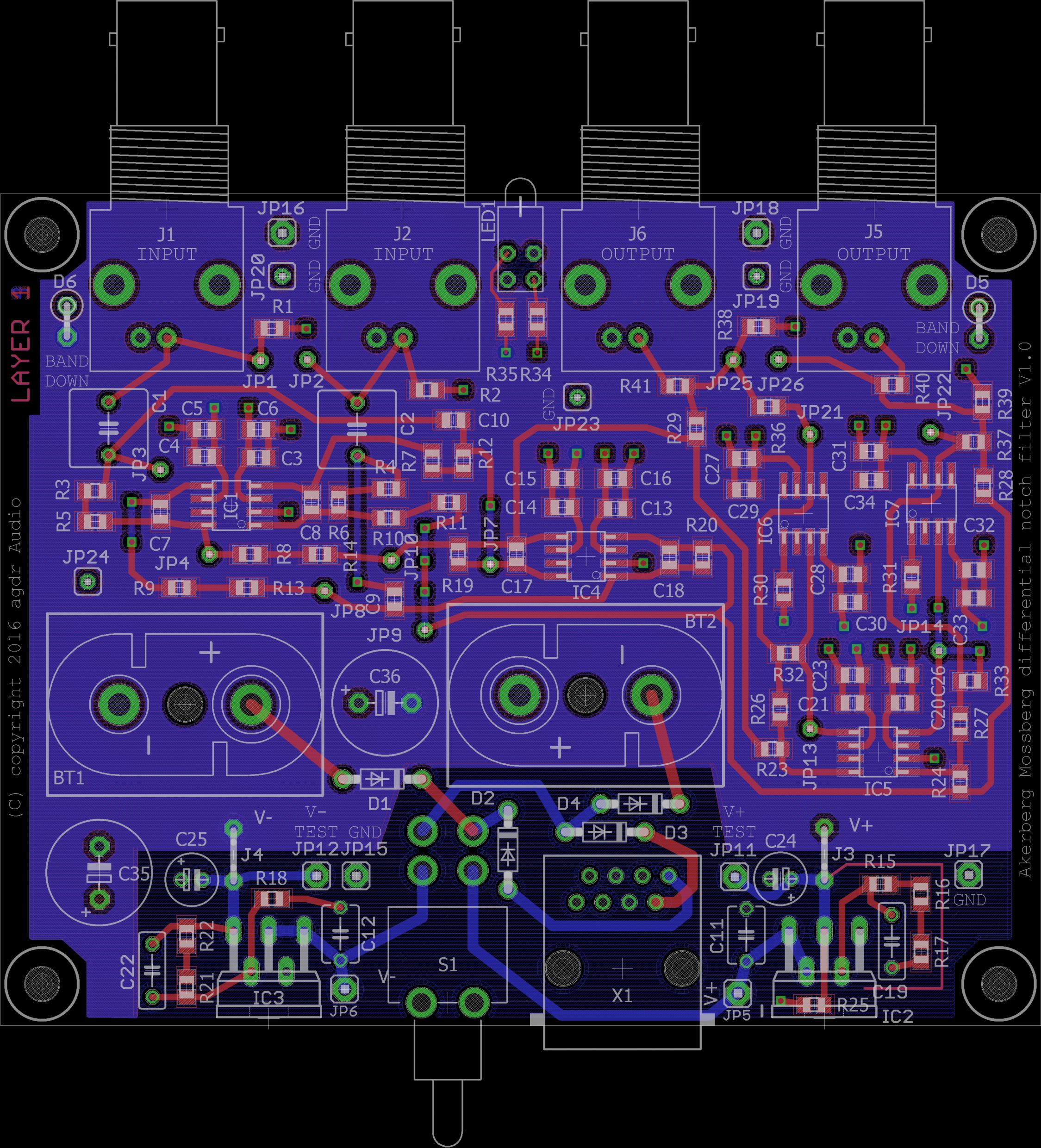

I've just sent the Akerberg-Mossberg fully differential notch filter board below off to fabrication. I'm curious to see how well it works with the QA401 given that the QA401 is fully differential.

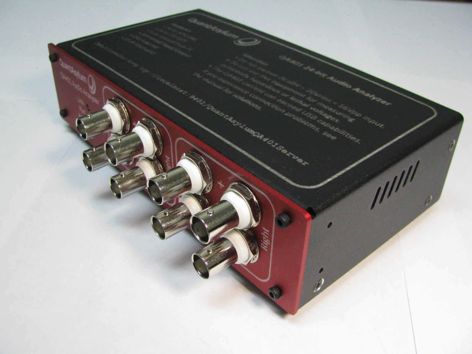

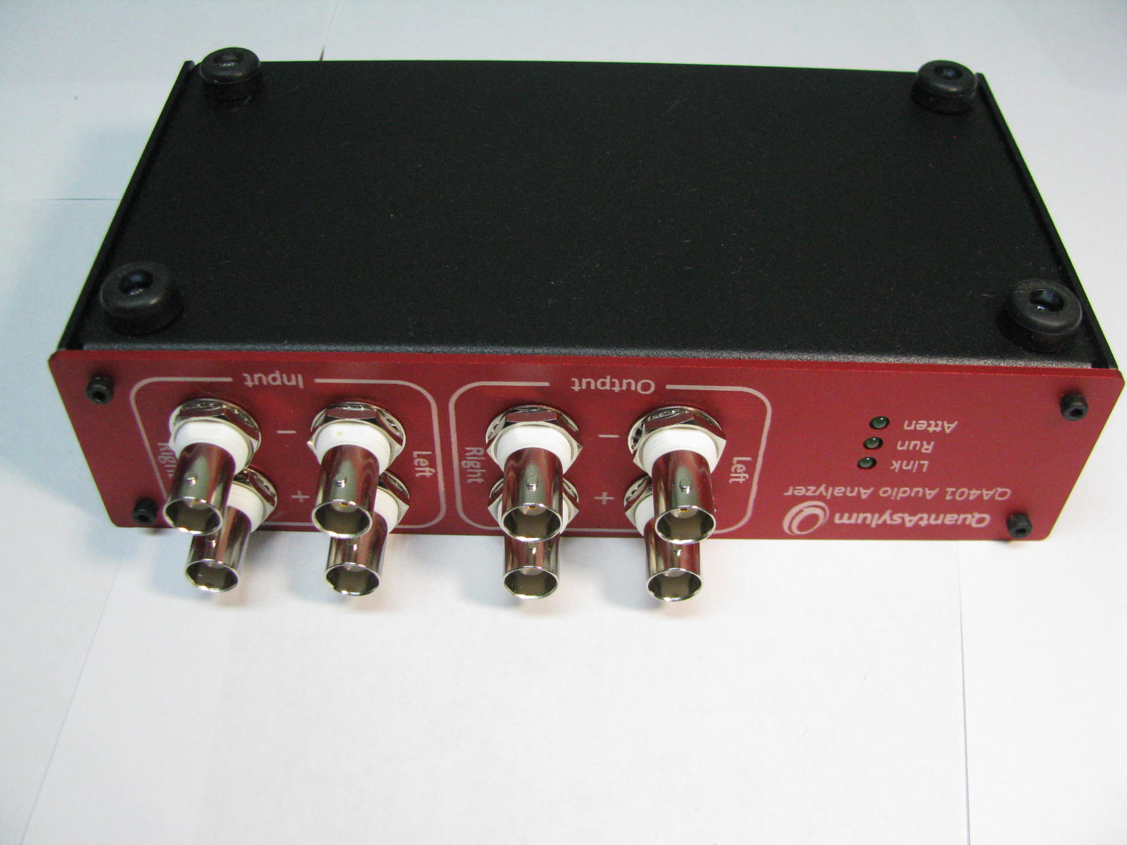

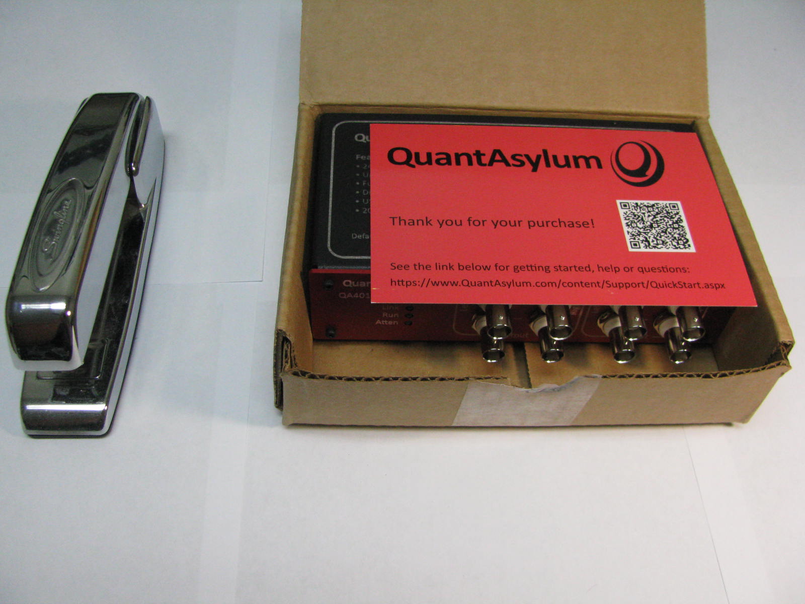

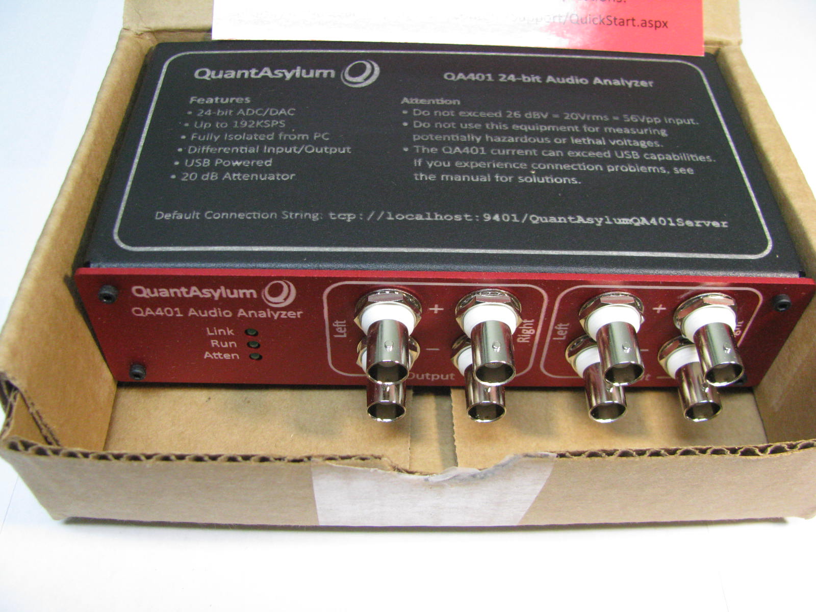

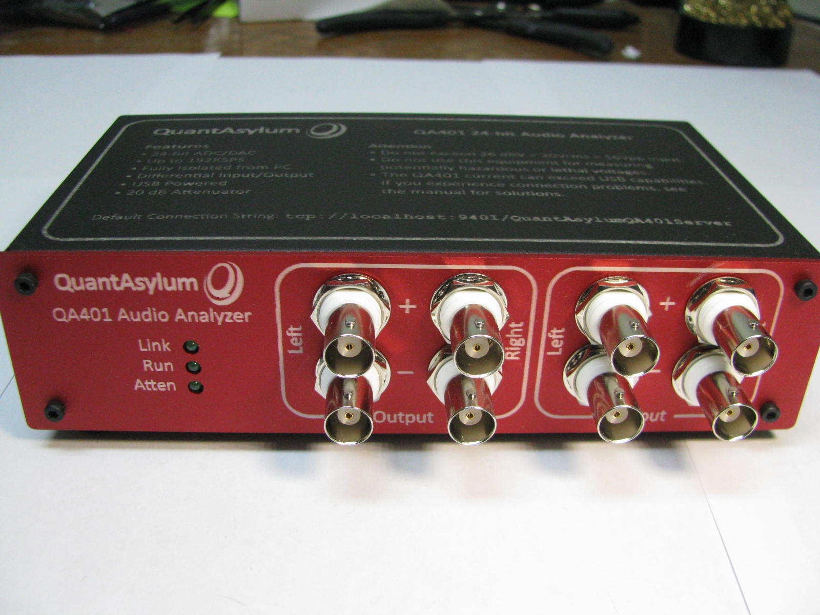

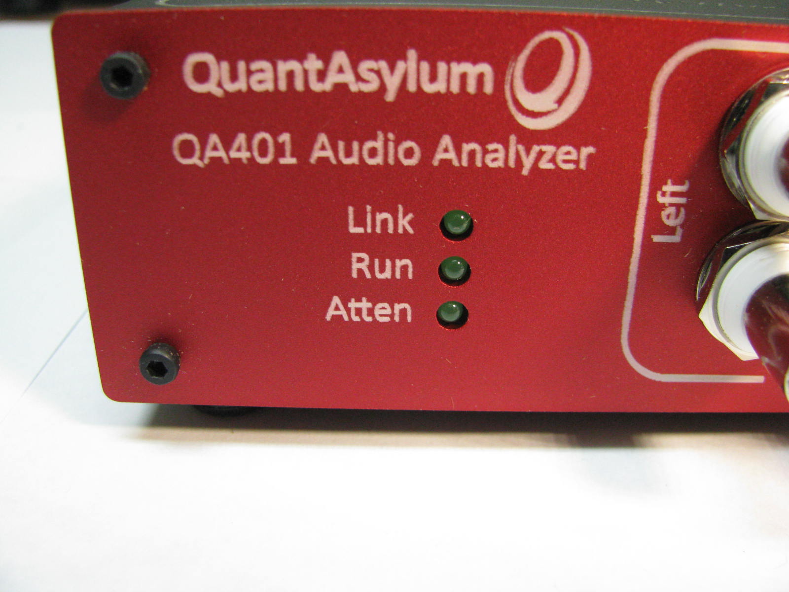

Photos (clicking in the lower left corner of the photo will zoom the size up):
* The first 5 are the unboxing. The stapler is there for a size comparison.

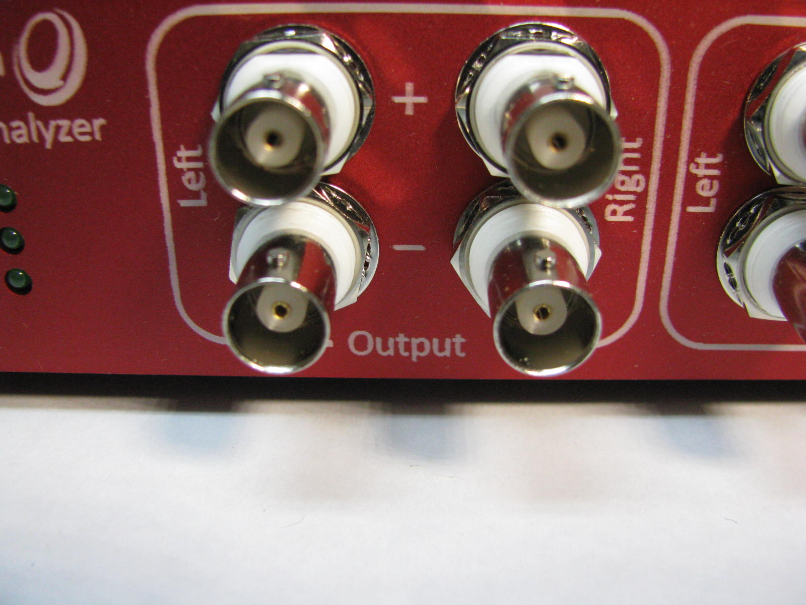

* The next 4 are close-ups of the front panel.

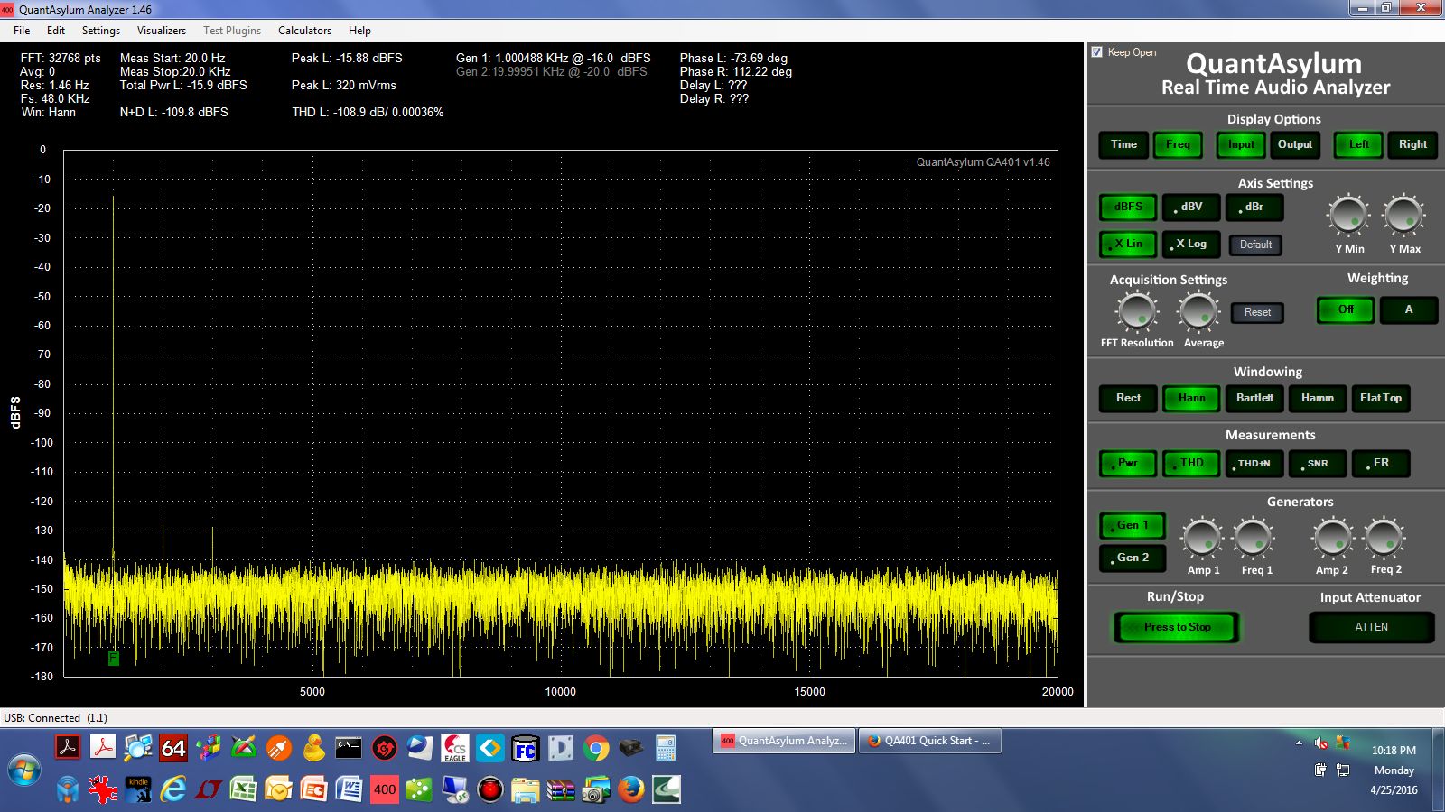

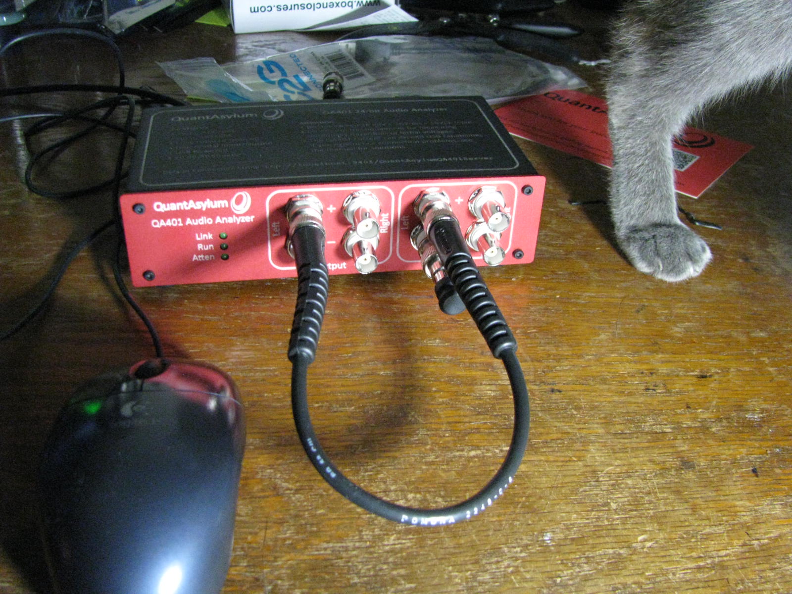

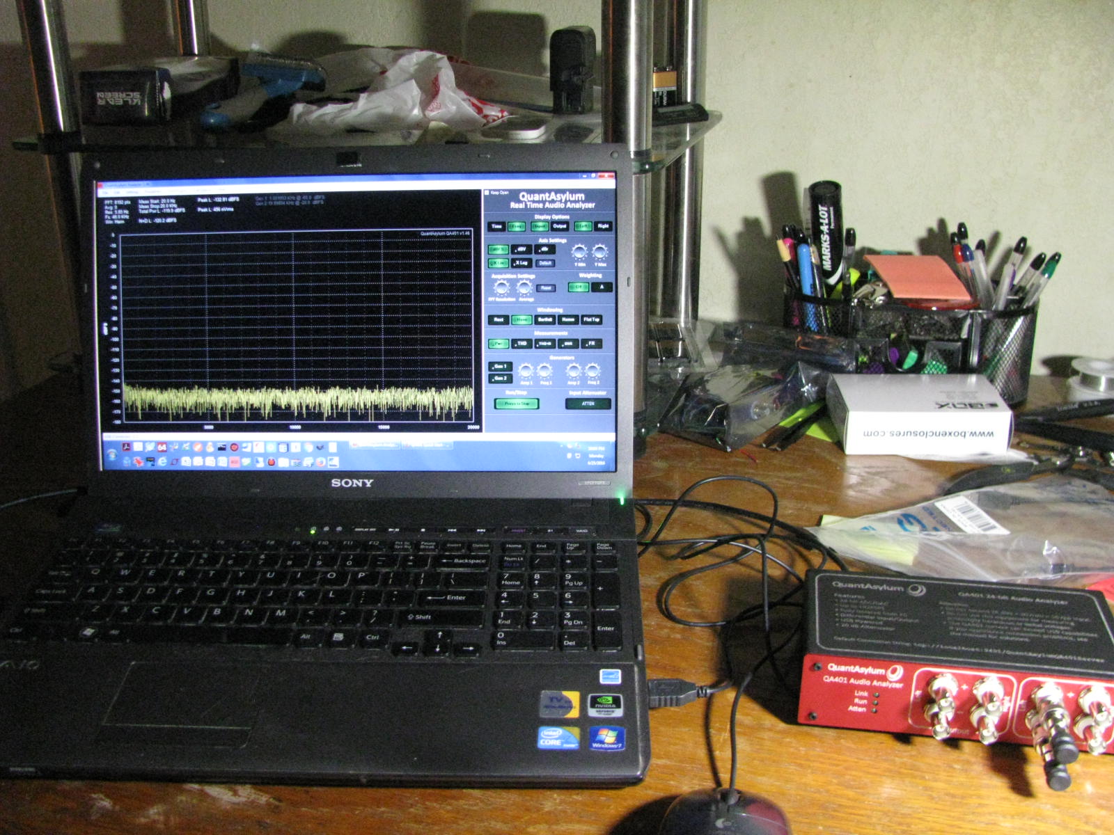

QA401 unboxing and initial quick start tests, part 2
...I ran out of photo slots on the post above, so here is part 2.
Clicking in the lower left corner of the photo will zoom the size up:

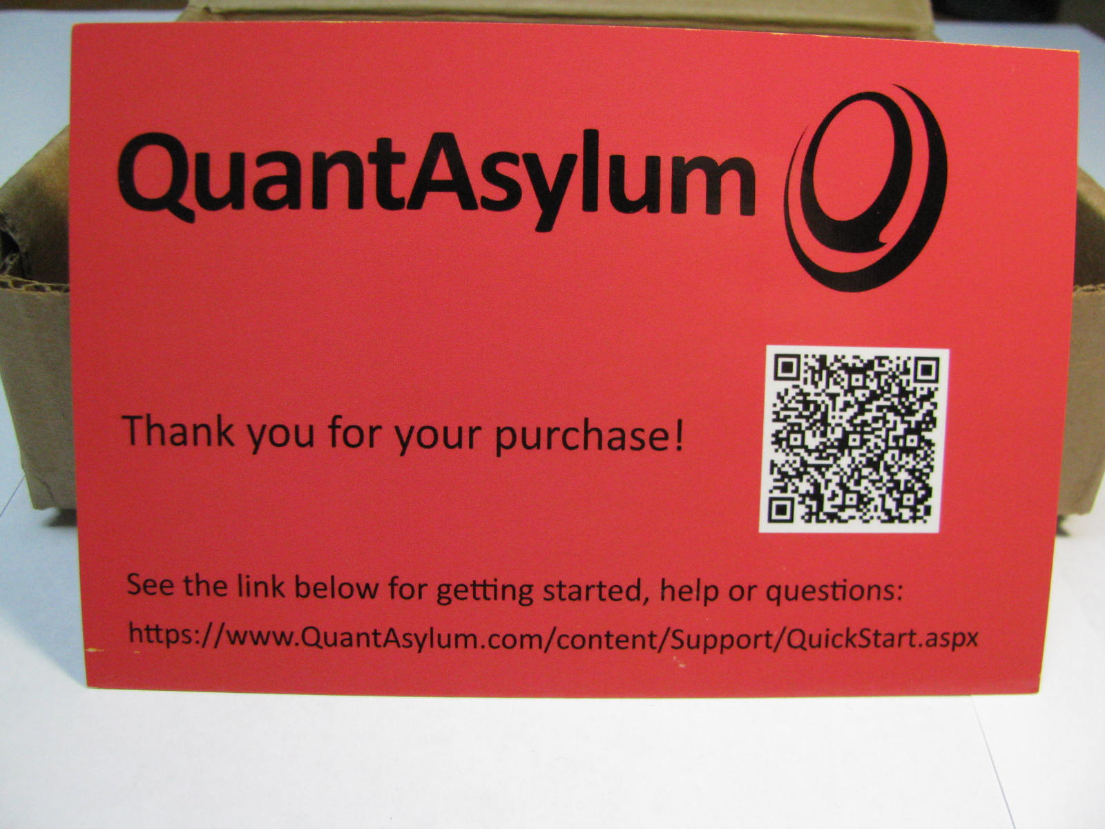

* The next 3 photos show the other sides of the box. The card on the back is covering up the serial number. 🙂
* The next photo shows the test setup. Another reason I went ahead and bought the unit is I realized this particular laptop has one combo eSATA/USB port over on the left side that supplies up to 800mA, enough for the QA401's 600mA maximum draw. Failing that you could try QA's suggestion of a a USB Y cable, or get a USB hub rated at 1A per port if your USB port can't handle 600mA.

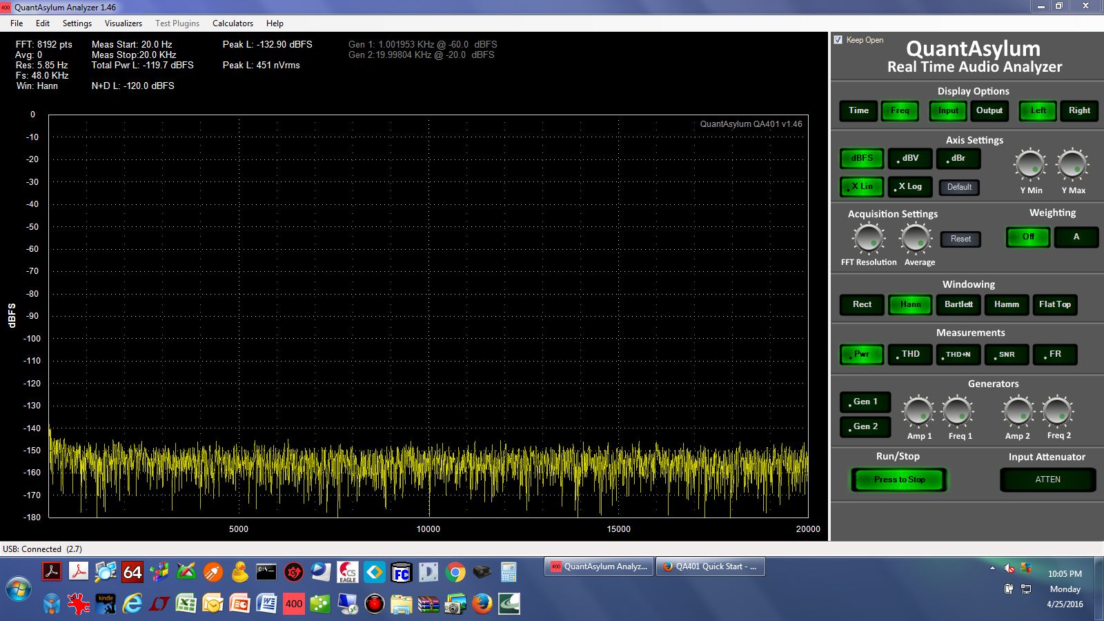

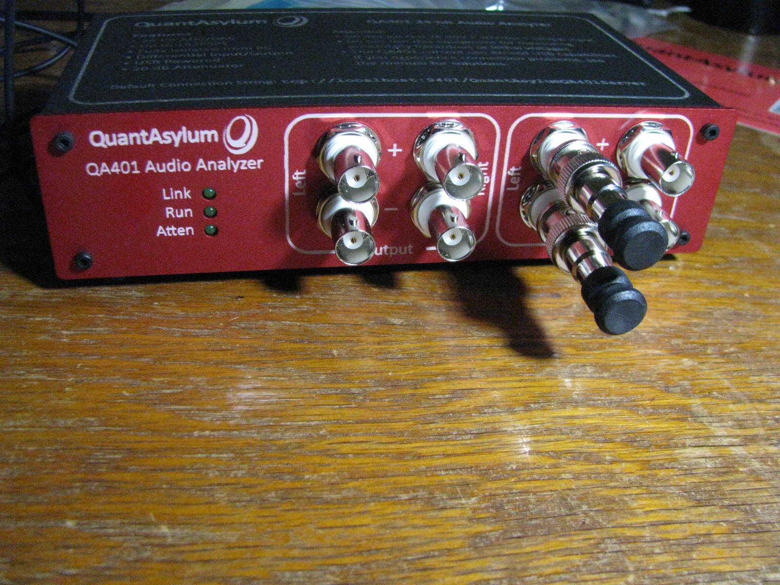

* The next photo and screen grab are the first steps in QA's quick start testing. Their procedure says to short both left inputs and look for -120dBFS power. From the screen grab I am, in fact, getting -120.0dBFS!

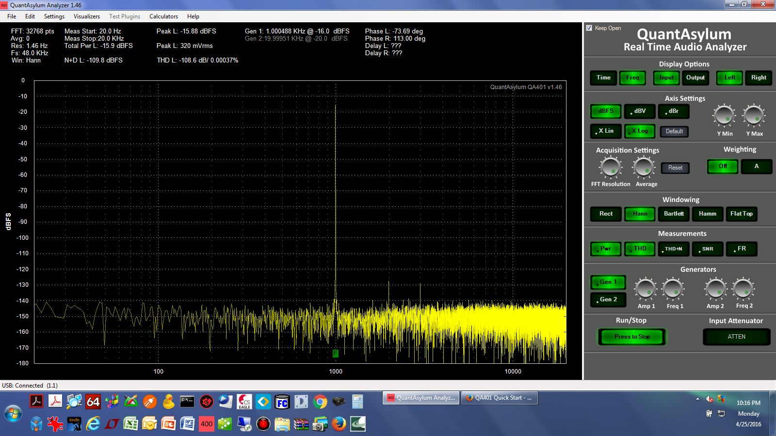

* Next is the final quick start test, a loopback. The left minus input remains shorted while the left + output is connected to the left + input via the BNC cable. The generator is set for -16dBFS and the FFT depth to 32K, as per the procedure. Their procedure says to look for -110dBFS THD. From the screen grab I'm getting -108.6, close enough! They forgot to say hit the "log" button in their procedure, since the plot they show is with the log. I've included both the linear and log plots here. The 2nd and 3rd harmonics from the ADC in unit show up, as other folks have reported. It would be nice if those were less prominent, but at least if I know the magnitude in loopback here I can subtract it out of any measurements.

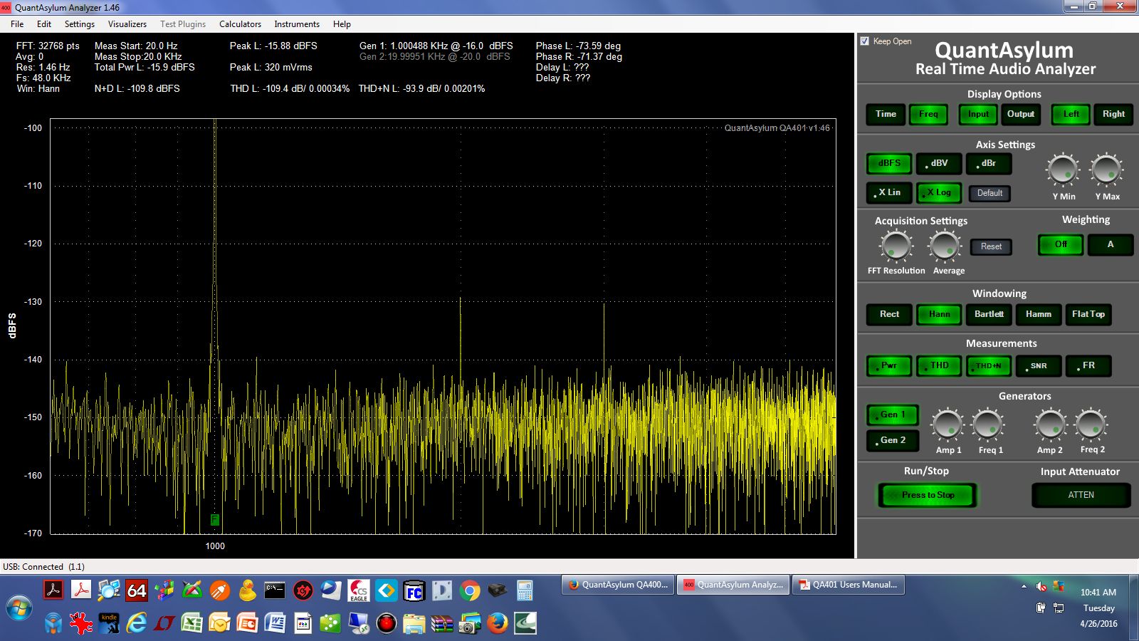

Have you tried THD + N?
I am curious how does the USB-based power affect the Noise floor.
Nice work.

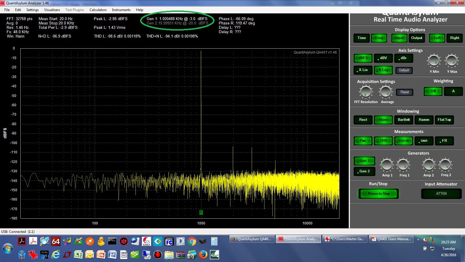

Do you have ADC measurements at the high input level (i.e. -1-3dBFS)?

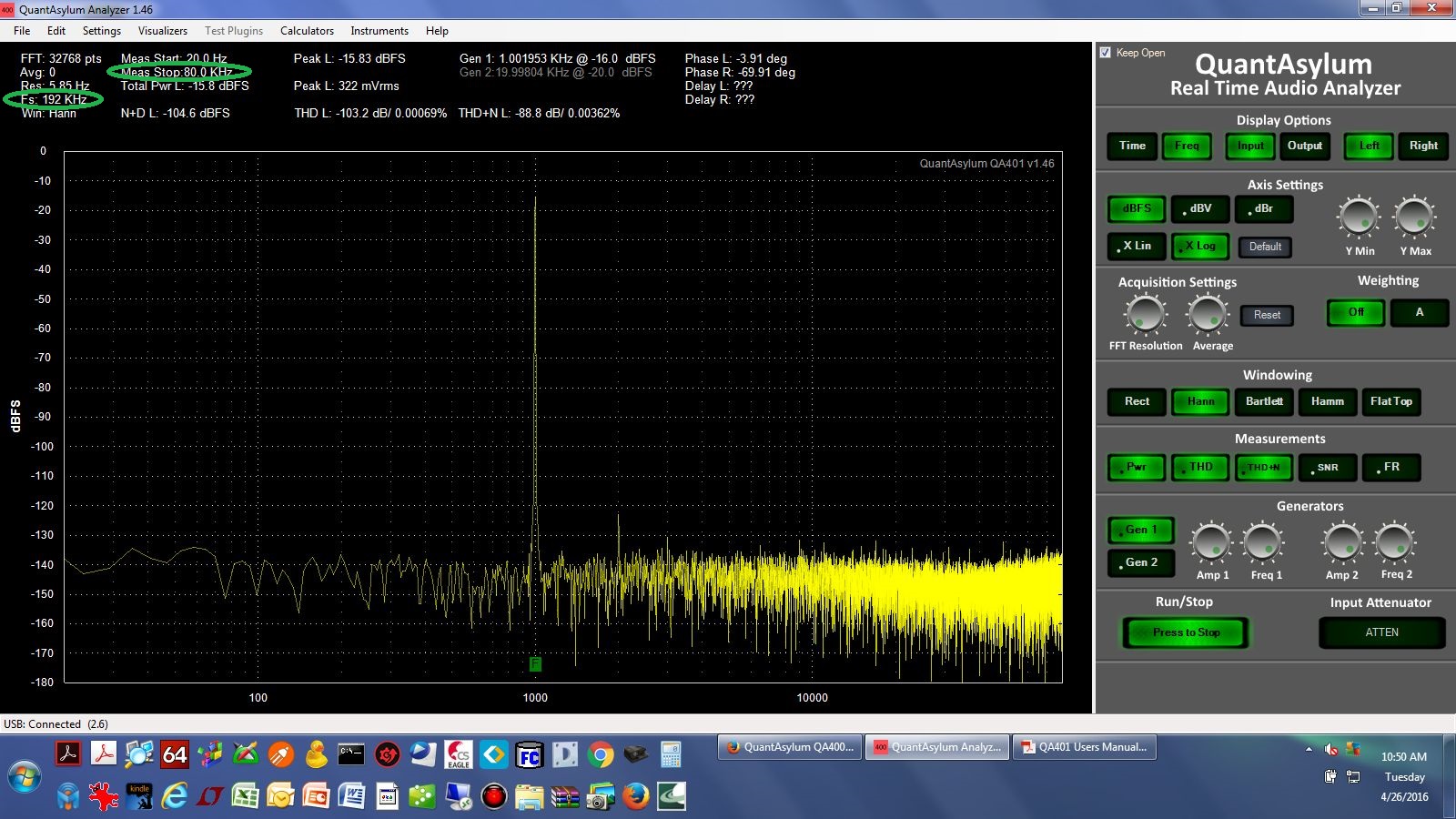

Can we see what a 1kHz fundamental looks like past 20kHz with the QA401 set to 192KSPS?

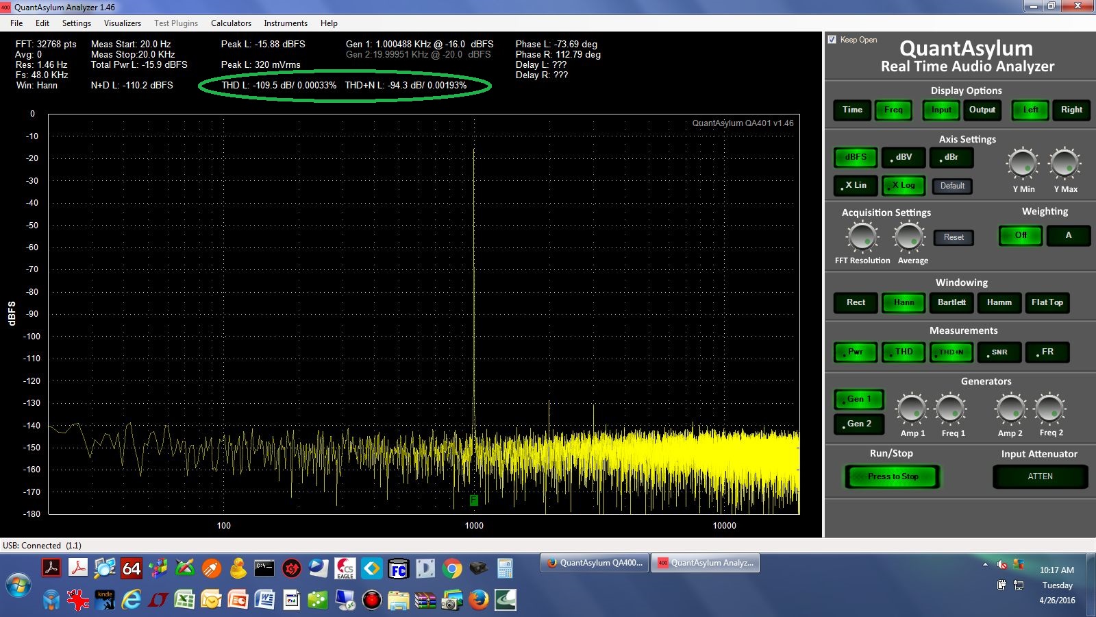

Whoops, I see a typo! In "part 2" the measured power level on the screen capture is -119.7dBFS, not -120.0. I was looking at the number under it. Still, close enough!
Here is another fun feature of the software. A box can be dragged around any part of the screen and it will do a zoom. Click on the axis button to reset the zoom.
Remember that you can click on the lower left corner of any of these to zoom them up...
The first screen grab below has the THD+N added.
The second screen grab is with the generator set for -3dBFS. The 5th & 7th harmonics pop out at this level.
The 3rd screen grab is set to the 192K samples. I've extended the X axis to 80KHz. The max frequency of the THD and THD+N measurements are changed to 80KHz from the default 20KHz.
Thanks for doing this.
It looks like using a notch filter at the higher input levels is going to be crucial with the QA401.
